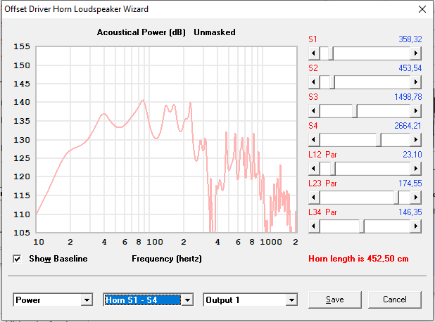

All looks fine when computing output from the main screen. However, the power in the wizard looks very strange. Maybe I am using Hornresp wrong?

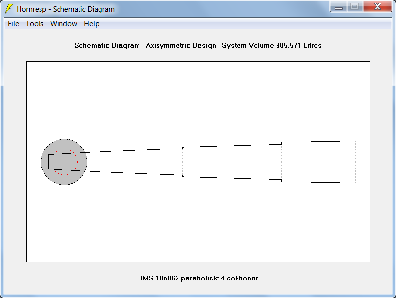

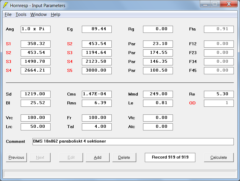

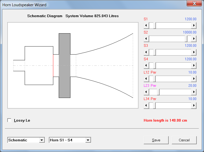

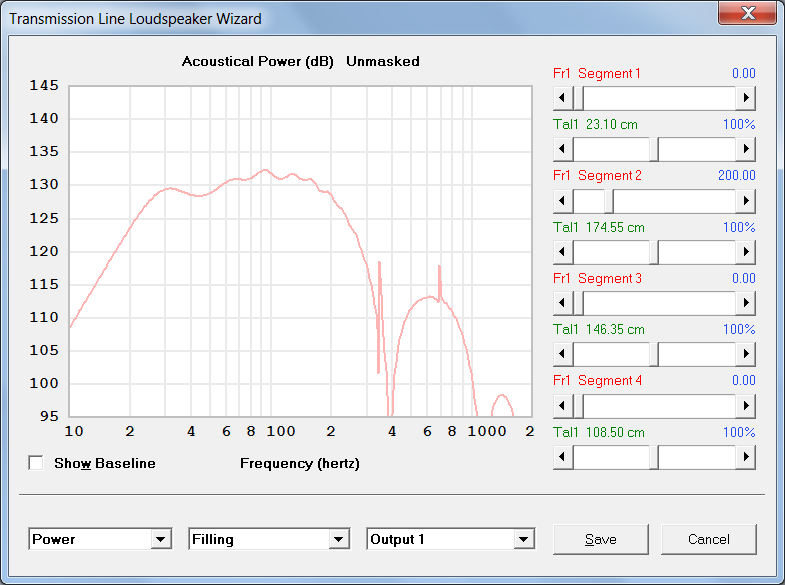

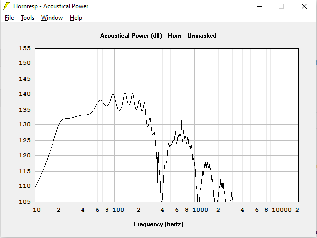

Hi Mårten,
My reply to 'Booger weldz' in Post #10655 applies to your case also .

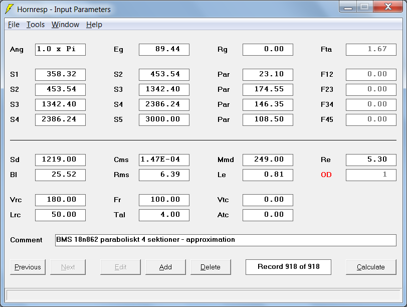

You have specified a stepped segment design, as shown in Attachment 1.
In the main calculation it is simulated as shown in Attachment 2.

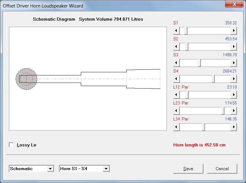

In the Loudspeaker Wizard it is simulated as shown in Attachment 3.

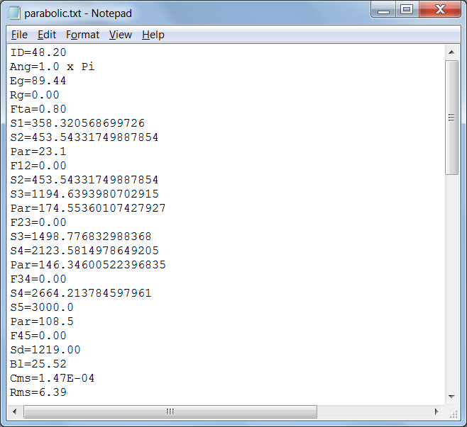

Not that it affects the results, but the thing I don't understand is how you managed to end up with more than two decimal places for the exported segment area and length values, as shown in Attachment 4.

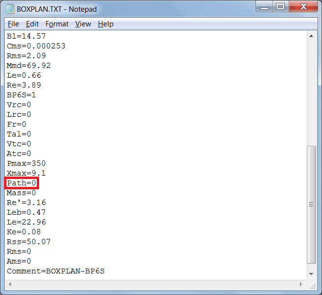

Hi David, can you include the value for "Path" be included in the BOXPLAN export option in your next update for Hornresp?
Hi Brian,
It should already be there, as shown in the attachment.

It's included in the initial Import process. However pressing F6 in the Loudspeaker Wizard doesn't reset the value for "Path" in the sim to the new value in the import file.

Hi Mårten,
Thanks David!
I suggest that you either remove the wizard for stepped simulations, or limit the functionality to allow everything except changing areas.

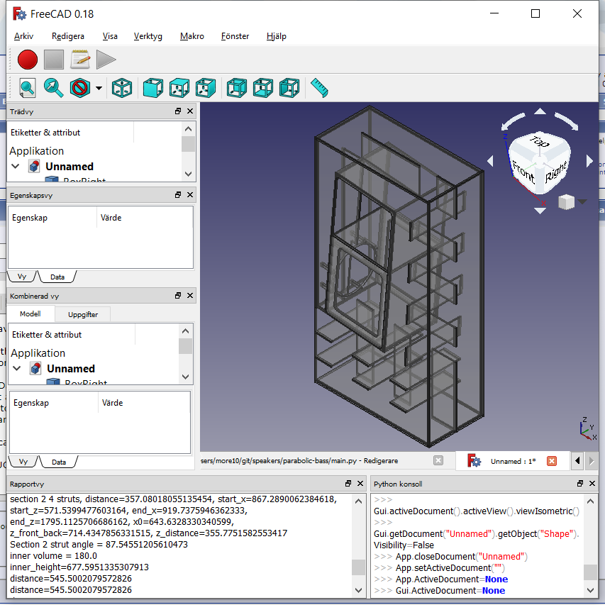

This is because I am generating the hornresp record from my cad software. I attached a screenshotNot that it affects the results, but the thing I don't understand is how you managed to end up with more than two decimal places for the exported segment area and length values, as shown in Attachment 4.
What I really want simulate is filling in section 1. Can I reduce the resonances at 66 Hz and 99 Hz?
Thanks for the additional information. The Path value will refresh in the next update.

That's because Ap1 refers to either a throat adaptor in the case of a normal horn, or a throat port in the case of an offset driver horn. It is not applicable to a standard bass reflex system, where Ap is used instead.
That's unlikely to happen. Too much work went into implementing the functionality in the first place, to now throw it all away .
Ah, now I understand. Mystery solved. Thanks.
In that case, I suggest you approximate the stepped segment system with an unstepped system. Make the unstepped radius at S2 equal to the average of the two stepped radii at S2, and the unstepped radius at S3 equal to the average of the two stepped radii at S3. This means that S2 then becomes 1342.40 cm^2 and S3 becomes 2386.24 cm^2.
Yes, but including the absorbent filling material in segment 2 rather than in segment 1, will have a more pronounced effect.

It's because you have specified stepped segments. When the Loudspeaker Wizard is used with the stepped segments option selected, all the segments will be cylindrical apart from the last one, regardless of the profile specified. This limitation is necessary to avoid having to increase the number of area sliders in the wizard. In your case, the last segment is also cylindrical because you have the S4 slider set to Auto.
...... or limit the functionality to allow everything except changing areas.
My other suggestion maybe? If the reason for not simulating stepped segments is the number of sliders, you can disable the area sliders if the simulation is stepped.
