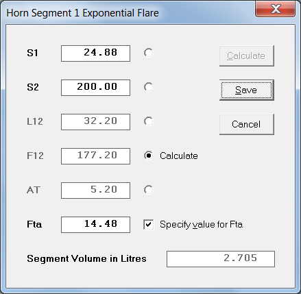

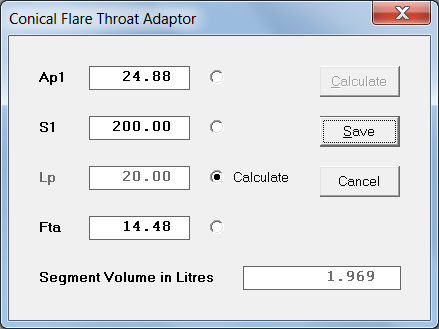

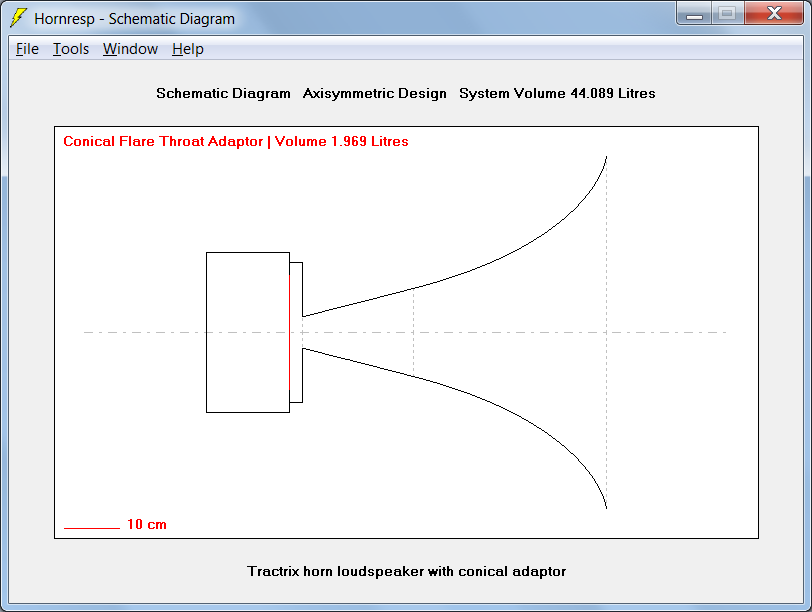

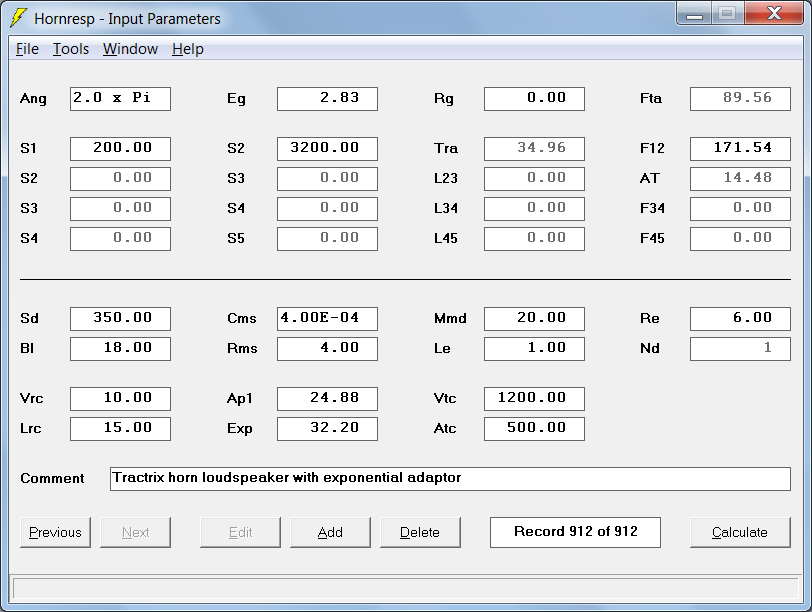

Is there a way to model a multi segment horn that starts with a conical (or other profile) horn segment and ends with a Tractrix profile in the last segment?
Hi chromenuts,

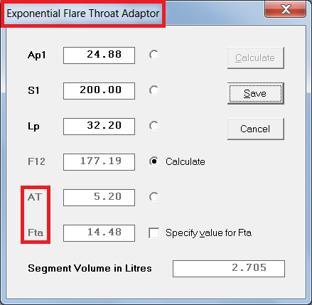

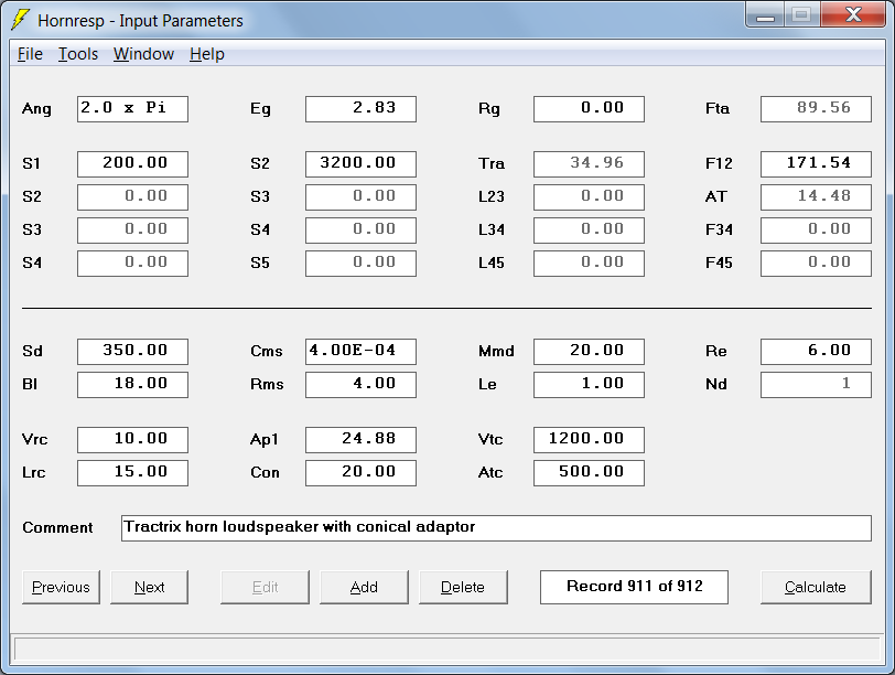

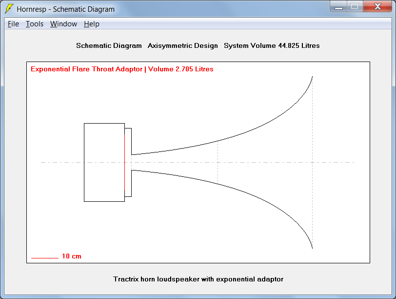

It can only be done by specifying a throat adaptor in front of the tractrix horn.
Attachments 1 and 2 show an example tractrix horn with a conical adaptor.
Attachments 3 and 4 show the same tractrix horn with an exponential adaptor.
For a conical adaptor, double-clicking on the Ap1 or Lp (Con) text box in Edit mode opens a wizard which enables the angle of the adaptor to be matched to the throat angle of the tractrix horn, as shown in Attachment 5.
In the next release it will be possible to do the same for an exponential adaptor, but at the moment it is necessary to specify the required angle in the standard Horn Segment Wizard tool, using a "dummy" segment to represent the adaptor, as shown in Attachment 6. The wizard S1 and L12 values can then be manually copied to the Ap1 and Lp (Exp) throat adaptor text boxes on the main input parameters window.
Stay safe,
David

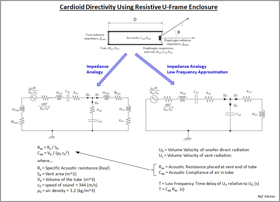

Here is a brief summary of the theory behind creating cardioid directivity, and how to achieve it using a resistive U-frame in Hornresp.Yes please!
Attachment #1: The most straightforward(analytical anyways) method for creating cardioid directivity is to co-locate and combine the outputs from a monopole source and a dipole source. By varying the relative magnitude of the two sources, the combined source directivity can be varied between dipole, cardiod, and monopole.
Attachment #2: The most common practical method for creating cardioid directivity is to combine the outputs from two monopoles(equal magnitude but one inverted) spaced apart from each other and one source delayed relative to the other. Crunching through the summation math, an equation for the combined directivity appears that is very similar to the one for the combined monopole/dipole method. With the distance between the sources fixed, the combined source directivity can be manipulated simply by adjusting the time delay. Traditionally, the delay is fed to the inverted source resulting in the directivity pattern “pointing” in the direction of the non-inverted source. Note that the directivity pattern is only obtained for low frequencies where the wavelength is much greater than the source separation distance.
Attachment #3: It doesn’t take too much imagination to realize that a U-frame can be used to create a passive implementation of the delayed two source method. The radiation coming from the backside of the U-frame is naturally inverted relative to the forward direct radiation from the woofer. At low frequencies, the air in the frame (or tube) acts like a compliance. If an acoustic resistance is placed at the vent exit, the radiation exiting the vent will be delayed by a time proportional to the compliance of the air in the tube and the acoustic resistance placed at the exit (ie the RC time constant). Uniformly stuffing the tube also delays the vent radiation at low frequencies, but the delay will not be constant with frequency and the front and rear radiation magnitudes will diverge.
Attachment #4: Overlaying the directivity on a decibel scale for super-cardiod thru sub-cardiod, it is easy to see what Olson, Bauer and others determined analytically. Although it doesn't have a null at 180deg, the super-cardioid provides the most “uni-directional” response overall. If a ratio of delay to source separation distance(d/D) of 0.8 is targeted, a reasonably uniform directivity pattern results across the bass octaves.

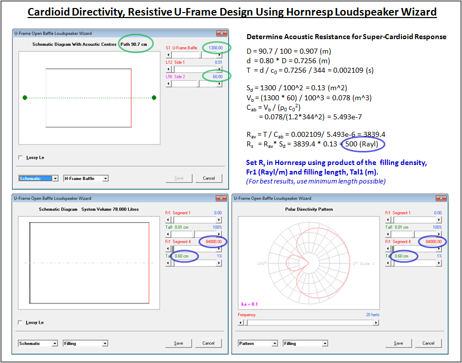

Attachment #5: Using the Hornresp U-Frame Loudspeaker Wizard, the appropriate resistance to place at the exit of the tube can be calculated using the dimensions shown on the Schematic. The path length between acoustic centers is the source separation distance D. The U-Frame tube area is Sd. The volume of the tube can be calculated from the area and length. Then it is a simple matter of back-calculating the required acoustic resistance to get a delay equal to 0.8 * D.
Hornresp doesn’t currently have a facility to define an acoustic resistance at the exit of a tube. But, you can use a thin layer of filling to emulate the effect. The filling density is given in Rayl/m, and you can specify values up to 99999. Using as thin a filling layer as possible at the exit of the tube such that the product of filling density(Rayl/m) and thickness (m) gives you the required acoustic resistance (Rayl). In the example, the thickness is set at 0.6cm = 0.006m, and a filling density of 84000 resulting in an acoustic resistance of 0.006 * 84000 = 504 Rayl. If for a given design you can't achieve the desired acoustic resistance, increase the length of the filling layer until you can.

PS - On working though the given example I noticed a very minor and probably quite obvious typo in the fifth attachment, but just in case anyone is confused, the value of 5.493e-6 shown for Cab in the Rav formula should be the same as the value calculated for Cab on the line above, that is, 5.493e-7.

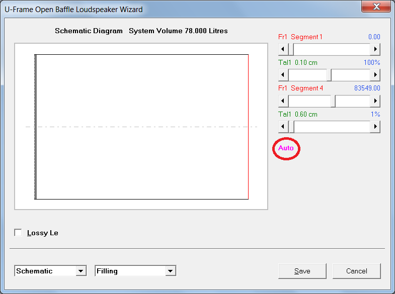

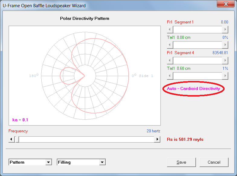

When the Loudspeaker Wizard is used with a direct radiator in a U-frame open baffle, the Fr and Tal values required to achieve cardioid directivity in a resistive system can now be automatically calculated by selecting the Filling option and then double-clicking on the Manual label below the Fr1 and Tal1 slider controls. Double-clicking on the default Rs parameter label changes the displayed filling material parameter from specific acoustical resistance Rs in mks rayls, to acoustical resistance Ra in acoustical ohms. Attachment 5 refers. My thanks to 'bolserst' for making the details of his method available for use in Hornresp.
'bolserst' has identified a limitation in the above new functionality, due to my misinterpretation of the contents one of the formulas in the worked example he provided. The results currently only apply to a U-frame that has the same cross-sectional area as the driver diaphragm. This limitation will be removed in the next release - hopefully it should be available in the next day or so.
