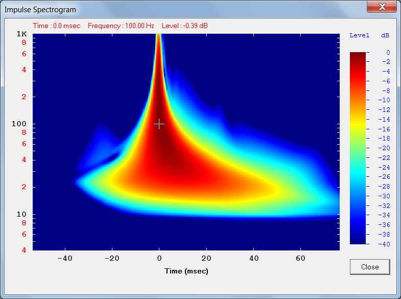

CHANGE 1
The impulse spectrogram frequency range now changes from 40-10000Hz to 4-1000Hz when the 1-2000Hz main chart frequency range is selected. Post #10552 and Attachment 1 refer.

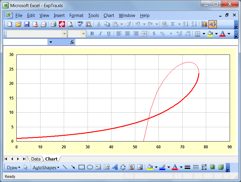

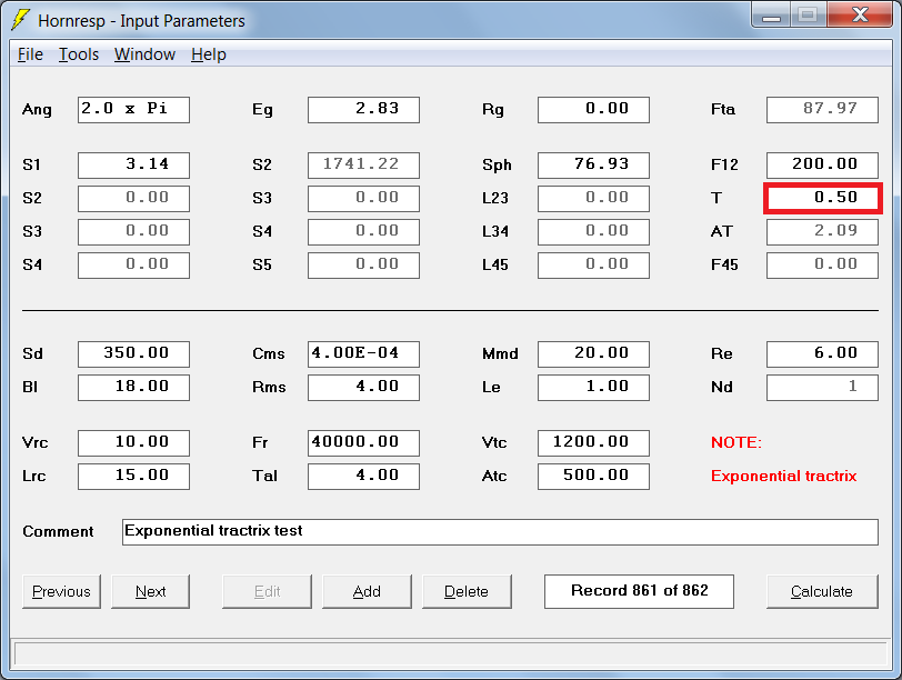

CHANGE 2

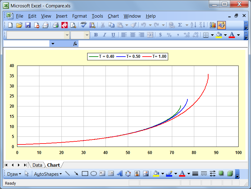

Horn flare parameter T has been added to the spherical wave horn model. T can have a value between 0.4 and 1, with 1 specifying a standard spherical wave horn, 0.5 specifying an exponential tractrix or "JMMLC tractrix revisited" horn, and any other value in the range specifying a user-defined custom profile. Post #10563 and Attachments 2, 3 and 4 refer.
The thin red trace in Attachment 4 shows the 'JMMLC tractrix revisited' profile originally produced in Excel by Jean-Michel. The thick red superimposed trace shows the identical Hornresp-generated 'exponential tractrix' profile.

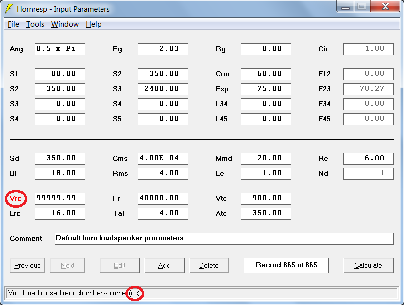

CHANGE 3
Double-clicking on the Vrc label in edit mode now changes the unit of volume for the rear chamber from litres to cubic centimetres. This option was requested by a user who is currently working on a horn design for microspeakers, having very small back chamber volumes. Attachment 5 refers.

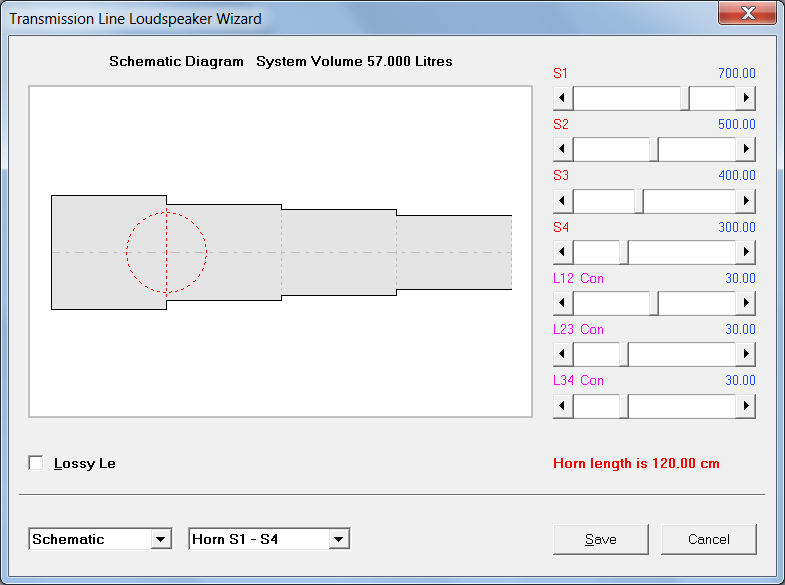

I have a question
I have simulated a TABAQ with the Hornesp and then I have developed a tapered version by using the size obtained from hornesp.
I have build the speaker and measured it. I obtain a huge differences in the response.
In the forum I read that sentence:
When you folded the transmission line enclosure it will change cross section area bigger and Line length shorter than origional design. Maybe these two cause affect the bass. So i decide to buy Martin's worksheet to recaculate SPL curve.
Is it possible to take in account this phenomenom in Hornesp?

I think that depend, because in my case I have put a 60cm MLTL in a relatively small box, therefore there are many 90° angle compared with the length of TL.
I have a high 100-150Hz peak, that is an effect if the TL is shorter but with big cross-section
Hi Bambinz,
It is up to the user to decide how folding impacts on the cross-sectional area and overall length. Four segments can be specified in Hornresp, and if the 'stepped segments' option is selected there can be abrupt changes of cross-sectional area at the segment interfaces, as shown in the attachment. It should be possible to specify a folded transmission line system to an acceptablee degree of accuracy in Hornresp.
That should not be the case. Something is obviously wrong somewhere. Hornresp transmission line loudspeaker predictions are normally reasonably close to the measured results.

How folding impacts on the cross-sectional area and overall length? So I can verify if my response is correct or not
That is for you to work out, depending on how the system has been folded. It helps to be able to visualise things in three dimensions .
Brian's BOXPLAN worksheets may give you a few ideas:
The Subwoofer DIY Page - Horn Folding
The following may also be of interest:
The Subwoofer DIY Page - Transmission Line Systems
Do you will implement this functionality in hornesp?
If you mean implementing something like Brian's BOXPLAN functionality in Hornresp, then the answer is no.

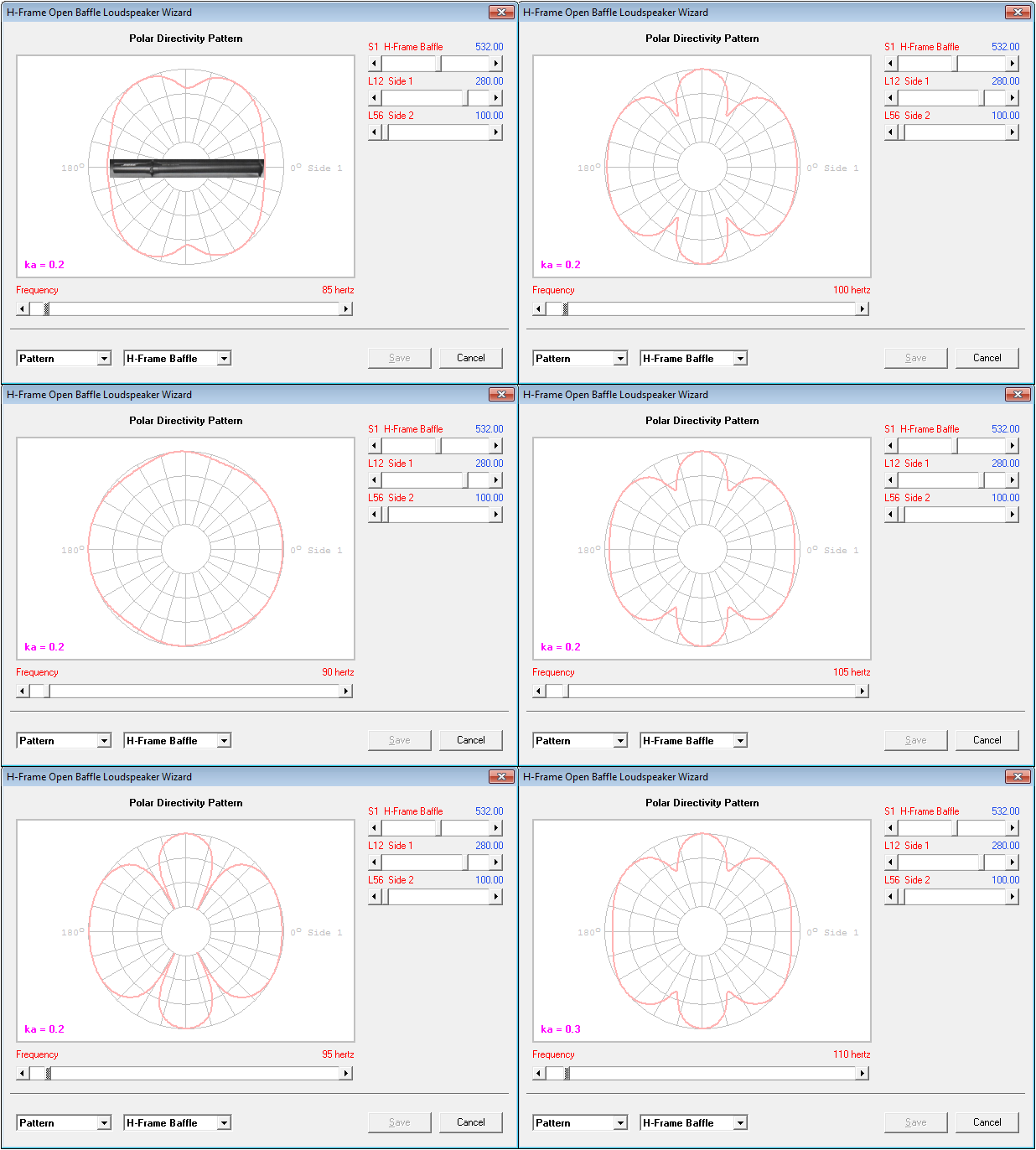

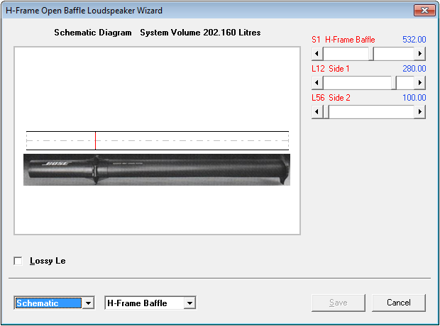

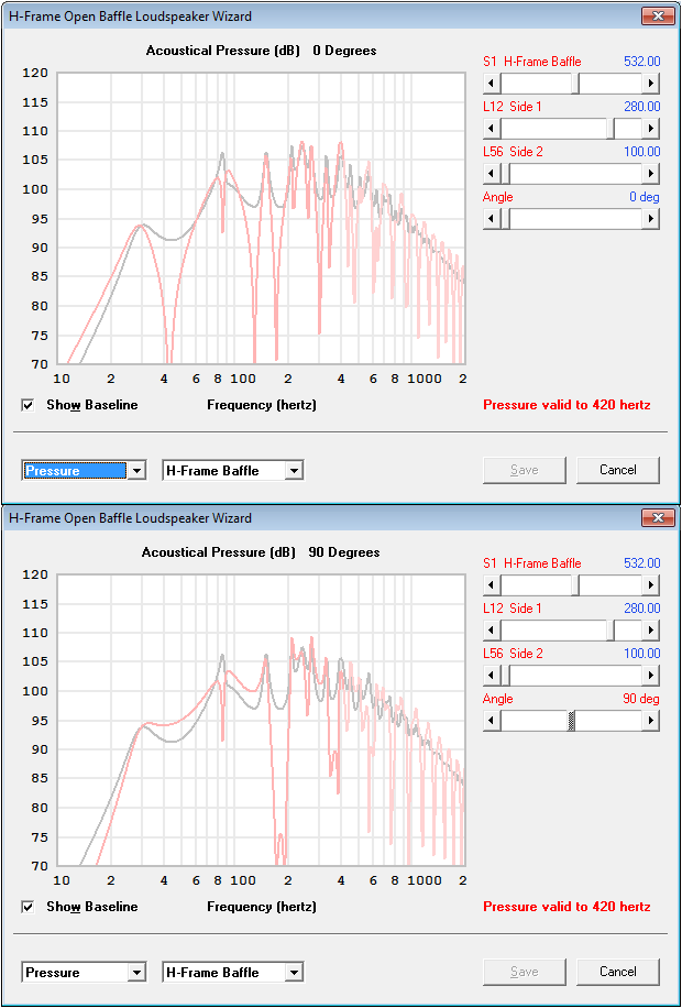

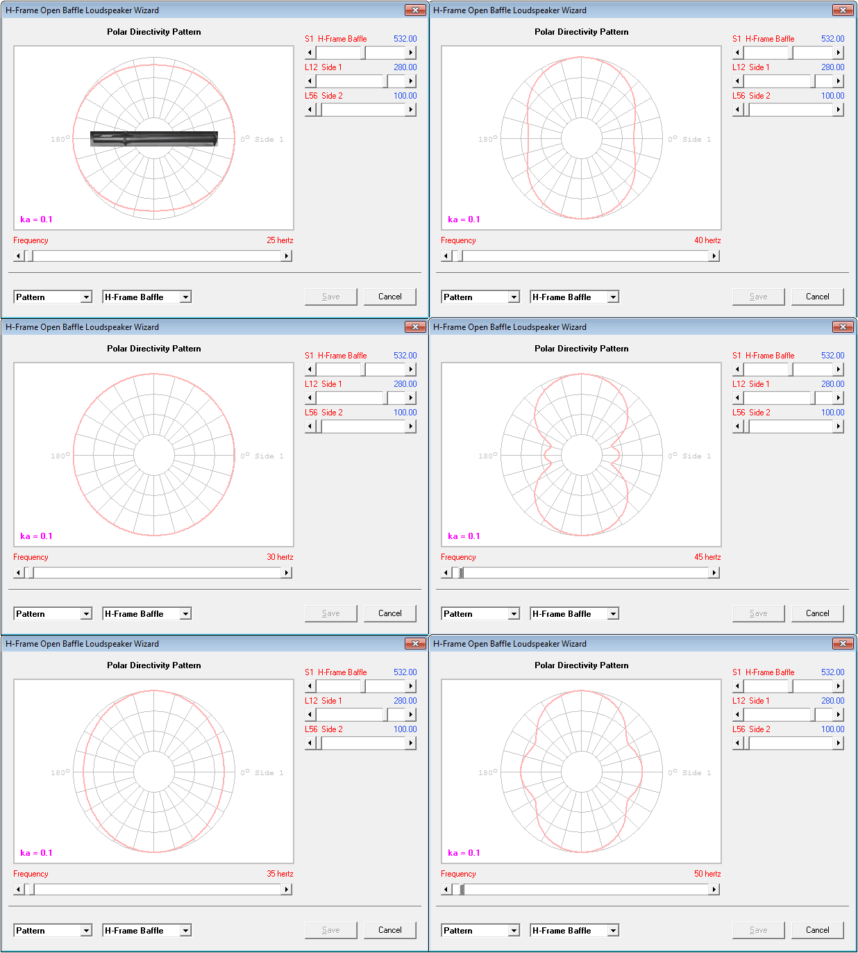

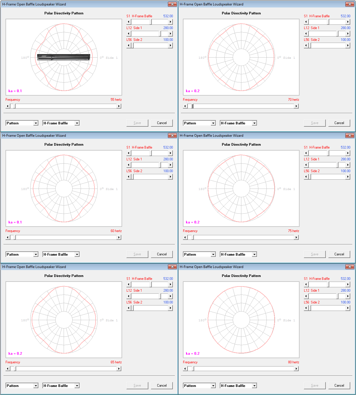

Thought I might share a few examples of how the H-frame/U-frame Polar plotter can be used.
First, I revisited the Bose Wave Cannon that had been modeled with Hornresp back in 2016. Bose Wave Cannon
Some discussion involved what direction the “hot” side of the response was on. The conclusion was the best listening axis was perpendicular to the length of the tube; it is NOT a cannon at all. The new polar plotter capability makes this determination much easier.
Attachment #1: Hornresp model of the cannon as an extremely extended H-frame.
Attachment #2: Response at 0deg and 90deg makes it obvious why the listening axis would be broadside to the tube.
Attachment #3 , #4, & #5: Polar Plots from 25Hz – 100Hz in 5Hz increments.
Attachment #6: A zip file containing a *.wmv movie file showing the polar pattern gain “petals” as you scroll up in frequency…kind of mesmerizing to watch.

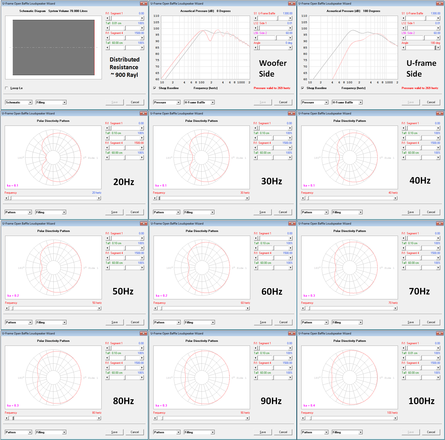

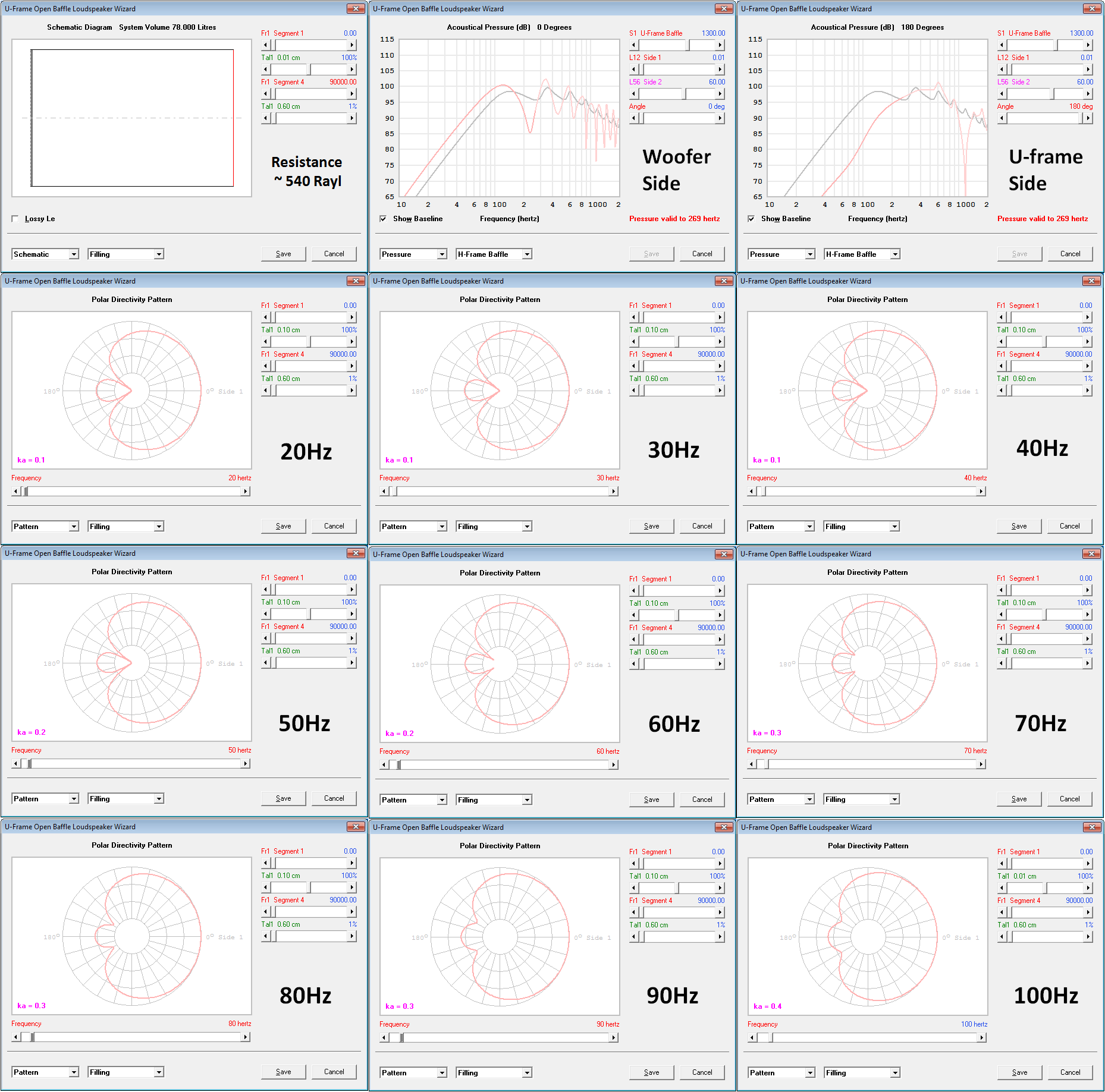

Another example where the polar plotter comes in handy is in evaluating U-frame designs where a cardiod or hyper-cardiod polar response is desired. A cardiod response is achieved when 2 sources that are 180deg out of phase with each other are spaced apart and one source is delayed by the separation distance. More details can be found on the Linkwitz, archived JohnK, or Kimmo Saunisto websites.
H-U frame woofers
DIY-dipole-1
Cardioid bass
With U-frames, the tube provides the source separation and the front and rear radiation of the woofer are inherently out of phase. To provide the delay acoustically, the best choice is to insert an acoustic resistance screen right at the exit of the tube. The resistance combined with the acoustic compliance of the air in the tube provides a substantially constant delay in the bass range. If anybody is interested, I can share more of the details for calculating the desired acoustic resistance for a given U-frame length to optimize the cardiod polar response across as broad a frequency range as possible. To insert an acoustic resistance with Hornresp, you fill the last 1% of the tube with a high density of filling. The equivalent acoustic resistance is equal to the filling setting x the length of filling in the tube in meters. For the example shown in Attachment #1 we have Filling in Segment 4 of 80,000, and the length of filling of 0.6cm. So, acoustic resistance is 80000*(0.6/100) = 480 Rayl. Acoustic resistances in this range can easily be constructed with thin felt and perforated or slotted panels.

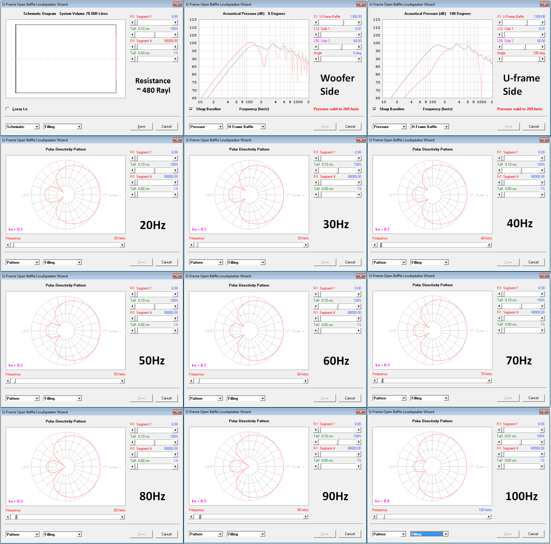

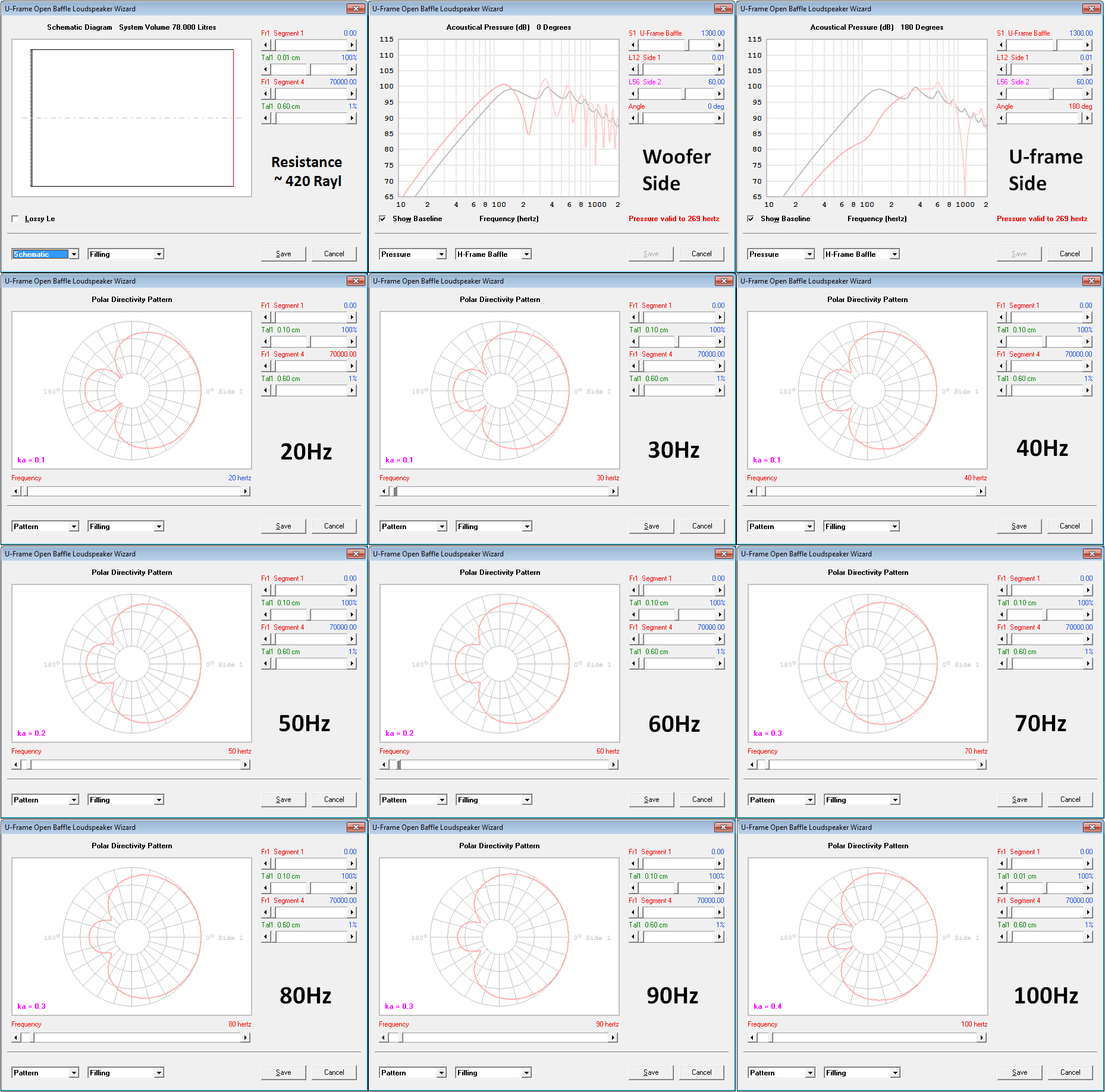

Attachment #1: Hornresp model and polar plots for a U-frame subwoofer with a Peerless SLS-12 woofer. Near uniform Hyper-cardiod response is provided across the bass range using an acoustic resistance of about 480 Rayl.
Attachment #2 & #3: For comparison, here are bracketing plot sets for 420 Rayl and 540 Rayl.
The alternative to using acoustic resistance for generating delay is the more traditional filling approach as often used in TL enclosures. However, the delay isn’t as constant as the acoustic resistance approach and the magnitude of the response is also attenuated non-uniformly with frequency. You can achieve a fair amount of reduction in rearward radiation, but not near what is achieved with acoustic resistance.
Attachment #4: Best compromise cardiod response I could achieve over the bass range using uniform filling.
Many thanks for the detailed analyses!
Very interesting indeed, and very nicely presented .
Yes please!
