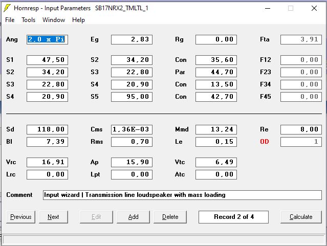

Well,
I ran in to at least two problems even before that (and after reading the manual and quite a few posts here).
1) It should be possible to set S2 in the first part of the pipe and then set S2 to another value in the next section of the pipe. But as soon S2 is changed at the second part, it also changes in the first part.
2) The calculations for the volume is ten times wrong. It says 1,6 litres but should be 16 litres. The software is asking for cm everywhere but are actually calculating somewhere as if it was mm inserted.

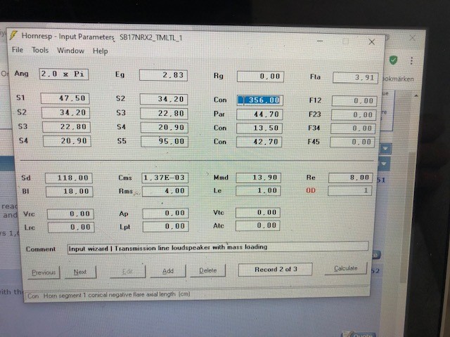

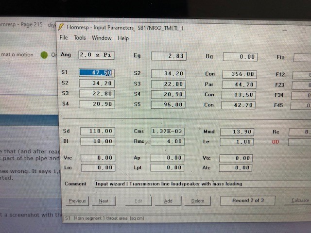

Are you sure about the units? Can you post a screenshot with the input?
Shure.
Look at the explanatory text at the bottom of each picture, while pointing at the blue field.

Thats because i have entered the length in mm not cm. But this might be wrong for other calculation purposes. Is it the circular area or the length that is used in the sotfware as mm, I dont know. See also the enclosed picture.When I enter your numbers, I get 18,31 l volume.
This sets the BI to a totally different value than calculating it from the driver specs where 16mm = 0,0016m x 0,93T = 0,001488 Tesla.m (as explained i the help text of the field)Press CTRL+U when in the Sd window and enter the parameters there, it will calculate the parameters from the common ones.
This is still a mystery. I remember doing this with my first try and then it worked, so something has changed in the set up. Trying to find out what.Well,
