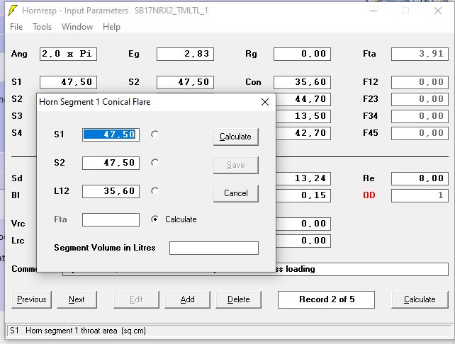

Also this is intersteing, from the manual: "By default, at the common boundary between two horn segments in a multiple-segment horn the cross-sectional areas are the same for each segment. The mouth area of the first segment is equal to the throat area of the second segment. Double-clicking on any segment area label in edit mode allows different cross-sectional areas to be specified at the common boundary. The mouth area of the first segment does not necessarily have to be the same as the throat area of the second segment. This will result in a step transition at the common boundary. All horn segment area labels are shown in red when stepped segments are specified.". Doesnt work this way in the Hornresp that I got.
This is what happens if i double click. A new menu (that i have been using) appears.
You have specified a cylindrical tube with a cross-sectional area of 47.5 square centimetres and an axial length of 35.6 centimetres. The volume of the cylinder is therefore 47.5 x 35.6 = 1691 cubic centimetres, or 1.691 litres, exactly as shown.
Sorry - feel really stupid now. Naturally its 475 cm2. Its actually what i have written all over my papers.....
But still the double click doesnt make anything else than opens the menu. Should i be in some other mode or something?

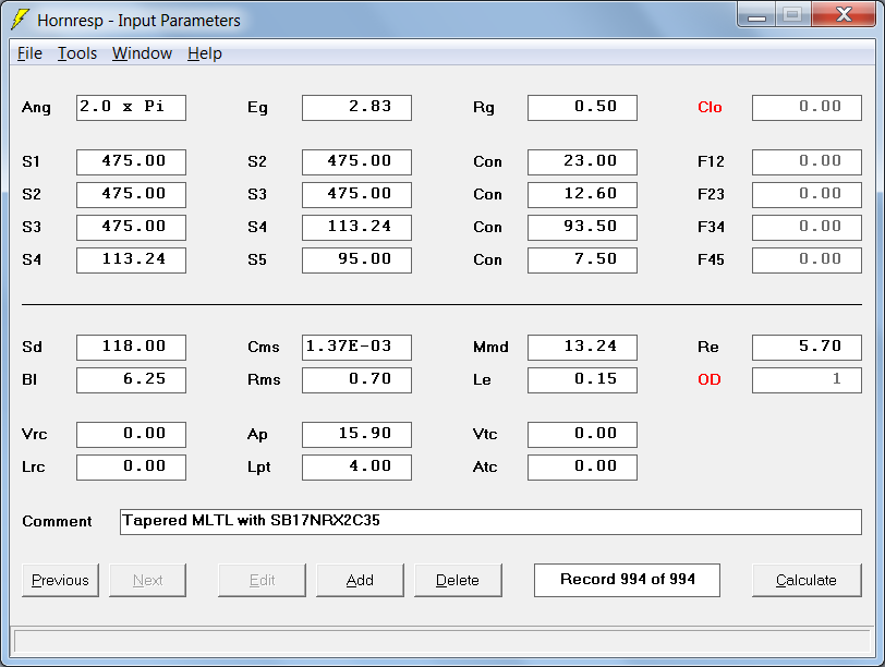

Tapered MLTL with SB17NRX2C35
Basic design
Four sections of the design:
1. Cylindrical. Start area (S1): 475 cm2, Stop area (S2): 475 cm2, Length: 35,6 cm
2. Conical. Start area (S2) 342 cm2, Stop area (S3): 228 cm2, Length: 44,7 cm
3. Cylindrical. Start area (S3): 228 cm2, Stop area (S4): 209 cm2, Length: 13,5 cm
4. Conical. Start area (S4) 209 cm2, Stop area (S5): 95 cm2, Length: 42,8 cm
Driver position 23 cm c/c from the Start/inner end (S1) of the first segment.
Port 4,5 cm dia = 15,9 cm2, Length 4 cm, placed 7,5 cm c/c from the end (S5) of the fourth segment.

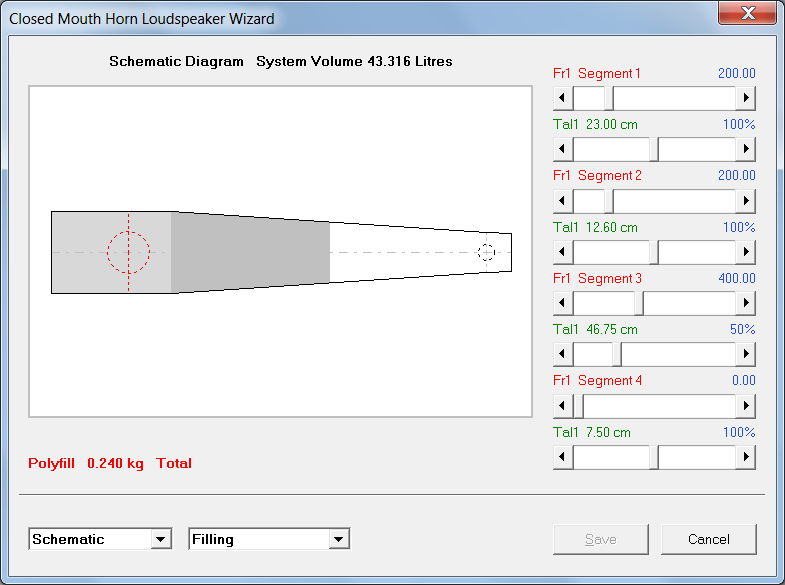

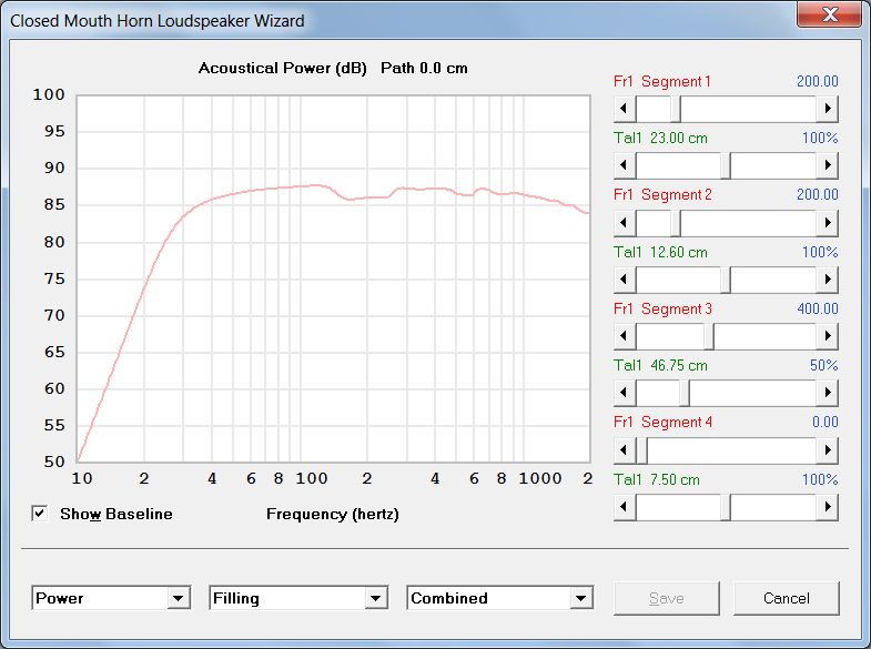

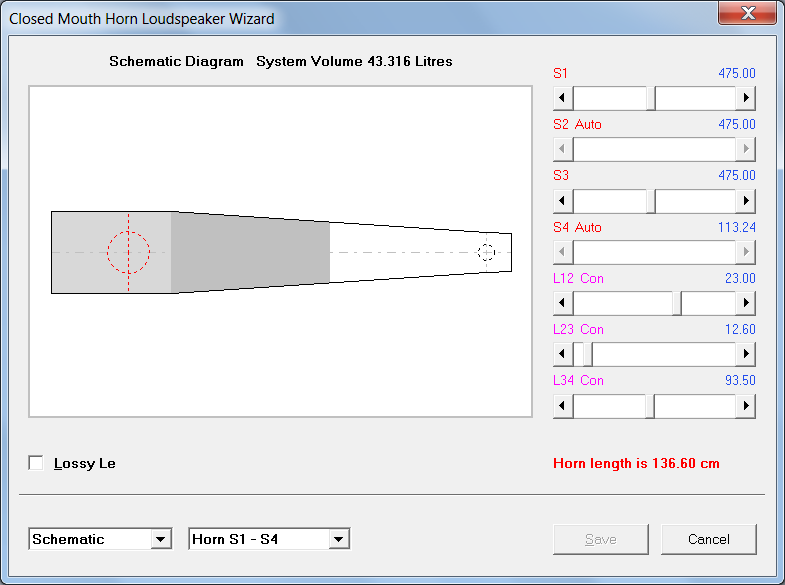

Ran in to the same problems that somebody else did some pages ago. Going from the input menu to the Loudspeaker Wizard the design change. All except the last of my four segments are now cylindrical. Which mean that the effect of the tapering is gone (or?). So what i basically do is that I insert filling in another design than mine - and the following graphs will show SPL etc on not my design. When I then go back to the input menu the S-values has changed.
How do I actually do to continue to design and calculate on the initially preferred input values?
Hornresp cannot simulate the exact design you specified, but the results will be close enough for all practical purposes if you make a few approximations as shown in the attachments. The filling material values can be adjusted to optimise the response - I have not attempted to do this.

I have realised that the software always position the driver (how about multiple drivers?) at S2 and that a port/vent could be added in some way by selecting close end and put the port (hard to know which type) at the end of a segment resulting in something you designed here. As my design has a bend which is not theoretically tapered I wanted to have a separate segment for it, and ran out of segments. :) Typically the type of things I talked about in my last post. :)
Then I just have to understand what other things you did to make this work than just position the Driver and the Port by using segments.
- You have other values than me for the Driver itselt. Why?
- The Re is set to 5,7 and not the Driver value...?
- I guess you selected "close end" somewhere in the design (cant remimber right now where i do that).
- You have set Rg to 0,5?
- Your menu (attached) contain Ap & Lpt, but mine Ap1 & Lp. Why (probably because set in another mode)?
Typically "work flow" topics. :)
