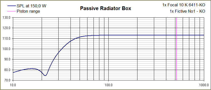

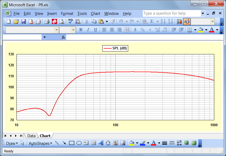

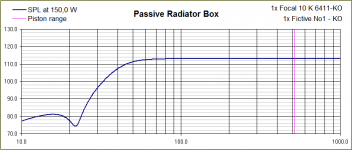

Maybe compare it to Unibox.
Thanks for the suggestion.
Attachment 1 shows the UniBox result, and Attachment 2 shows the Hornresp result for the same system. The Hornresp data was exported and plotted in a chart of similar size and scale to the UniBox one, for ease of comparison.

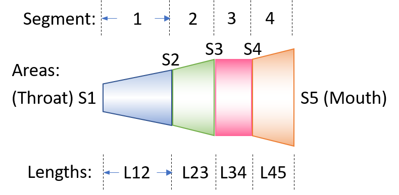

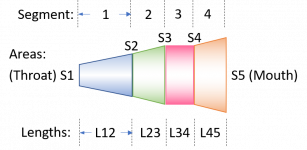

Hi Dennis,
Basically its "quite simple" despite all my questions above. It´s just that one need to come into the mode and thinking behind it.
Think about the whole set-up as you are dealing with a tube that you can play around with (to get it to sound great). A tube with three to four segments. See the enclosed picture (that I will paste into the manual). The driver(s) are "mounted" in the position between segment one and two. If you have for example a vent it is "mounted" in the position between segment three and four.
You design the different segments one by one (lenght, starting width, end width), which is actually the physical design. Then you add on the damping, section by section. This is the fundamental way to design.
Remember also that it is sort of two softwares in one. First the input menu, then the design menues. What you do in the input menu is just "get started". Then you go on with the other menues.
First of all you need to include the driver(s) into the design - then you are ready to go. Written by a Newbie that suddenly thought it was not so hard anymore.
Just input something and start playing.
Thanks Sharky. when I look at the picture a couple questions come to mind.
At some point do you translate those section dimensions into a physical horn?
That picture looks like to horn is expanding and I thought TLs are either straight or tappering down to the mouth.
How is that picture folded?
Dennis
Dennis
The previous post give you help. There are also others. Start simple is my suggestion. The principle is to use the length from Hornresp and se that the same length is reflected at the middle/centre of the pipe through out the length in the drawing.
Dennis
All different ways of designing pipes are used. Just google around and you will soon find out.
The more complicated design the more complicated to fold it to an actual physical speaker.
Dennis
Hello Dennis.
The shape of the segments is up to you. You can make them an equal area all along. The areas are the "S" numbers. The lengths of each section are the "L" numbers. If you take a corner, you create a line down the centre of the bend and determine the length used up as you go along the bend.
The folding worksheets that were posted are pretty good to use. they can help quite a bit is spitting out a cut list for you to.
Thanks Mark. So is the "s" is 10 does that mean 10 square in and if the "L" is 10" long does that mean that section 100 square inches regardless of how I shape it?
Think centimetres my friend.
You are in one of two countries that are still officially imperial inches.
S10 is 10 square centimetres regardless of shape. L 10 means that section is 10 centimetres long.
2.54 cm equals an inch. Google will help you out if you are afraid of the math.
