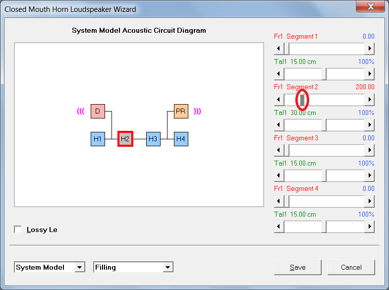

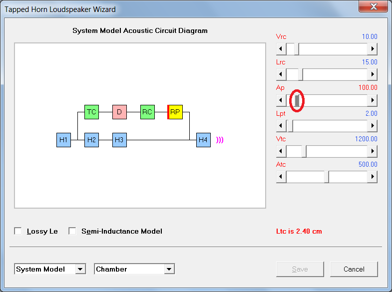

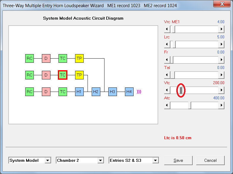

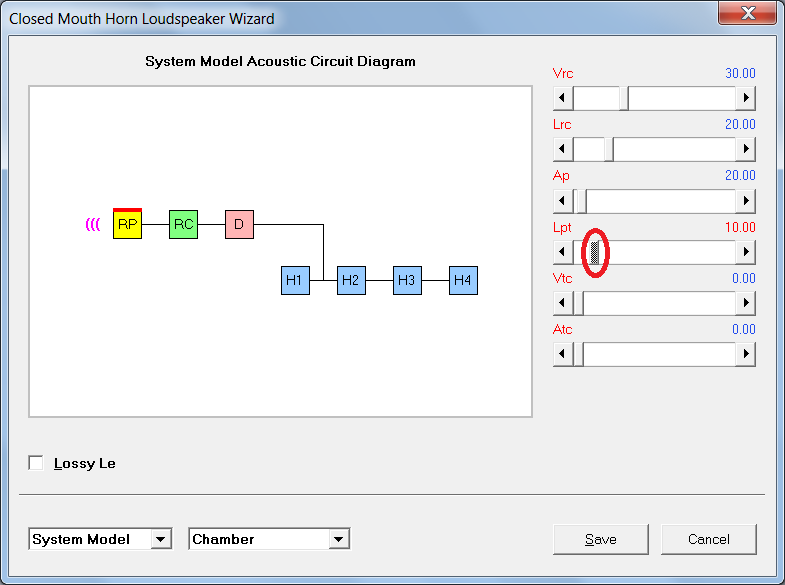

The system model acoustic circuit diagram feature, previously only included in the band pass loudspeaker wizard, has now been added to all loudspeaker wizards.
Previously when a slider control had the focus, the text in the applicable system model element box was displayed in bold font. Now the action taken is context-sensitive and depends upon the type of slider selected:
* A volume slider changes all four sides of the applicable element box to bold red, to indicate the specified volume. Attachment 1 refers.
* An area slider changes one side of the applicable element box (or boxes in the case of horn segments) to bold red, to indicate the plane of the specified cross-sectional area. Attachment 2 refers.

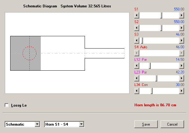

* A length slider changes one side of the applicable element box to bold red, to indicate the specified length. Attachment 3 refers.
When damping material is added to either a rear chamber, horn segment or multiple entry horn throat chamber port, the background colour of the relevant box now changes to grey. Also, radiated sound outputs are now shown as either ((( or ))) in bold pink. Attachment 4 refers.
The new system models hopefully clarify how Hornresp simulates particular designs, and how the volume, area and length parameter values are taken into account.

The operation of the length sliders in the Multiple Entry Horn Wizard has been significantly improved. Extreme values entered manually are now handled far more gracefully.

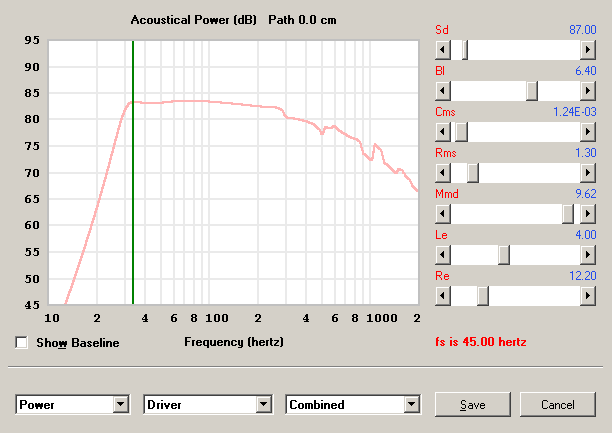

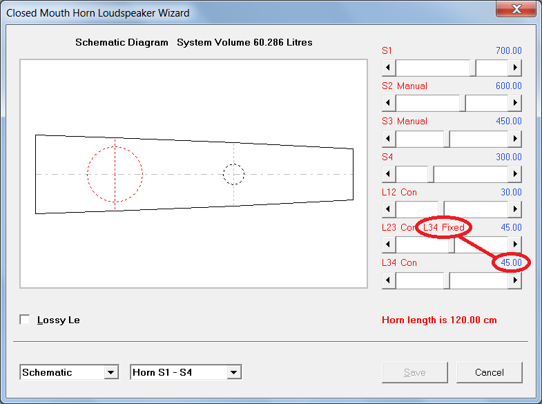

For a closed mouth three segment OD system with an offset port, stub or passive radiator, the value of the L34 slider in the loudspeaker wizard can now be locked / fixed so that it does not change when the L23 slider is operated. This feature was requested by a user via email.
The "L34 Fixed option" can be toggled On or Off by double-clicking on the L34 slider value. Attachment 5 refers.

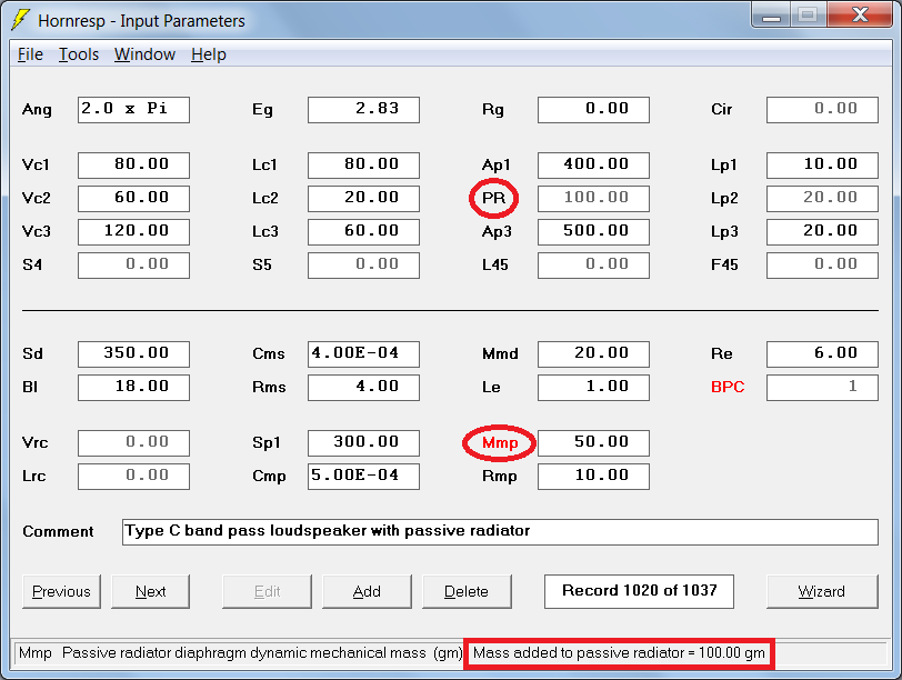

On the main input parameters window, mass is now added to a band pass system passive radiator by double-clicking on the Mmp label in edit mode, rather than by entering the value into the Mma input text box.
Mass can now also be added to the passive radiators of other systems using the same method, rather than only being able to enter the value using the loudspeaker wizard. When mass has been added, the Mmp label is shown in red
The position selected for a passive radiator in a band pass system is now indicated by PR rather than Mma, and the unused port input boxes are disabled.
Attachment 6 refers.

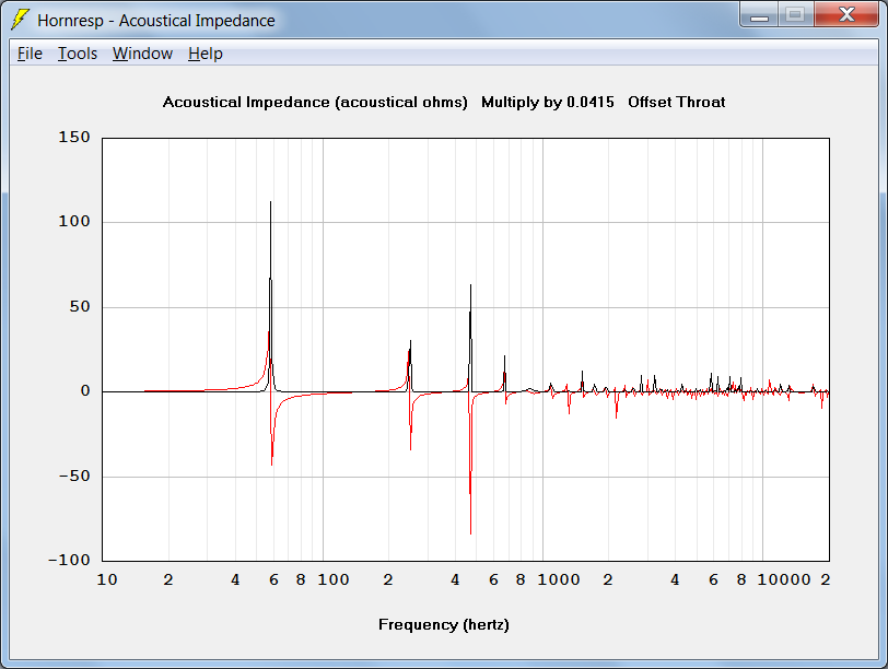

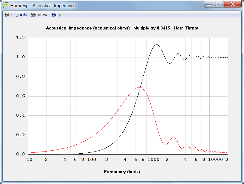

For a loudspeaker system with an offset driver and offset port, stub or passive radiator, the acoustical impedance chart plotted the load on the direct radiating side of the driver diaphragm, but wrongly indicated that it was the horn throat impedance, as shown in Attachment 7. The chart now plots the acoustical impedance at the offset throat instead, together with the correct caption, as shown in Attachment 8.
BUG FIX 2
The fatal error shown in Attachment 9 would occur when trying to sample the acoustical impedance of an OD1 loudspeaker system. This bug has now been fixed.

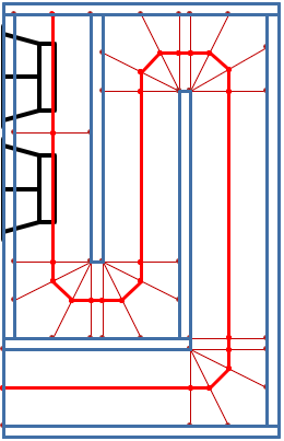

i plan to build a box in the style of the famous tabaq-mltl, but make it a 2-way system crossed-over at 500Hz with a 6db series xo, see attachments.
Above 500Hz it's a OB with a fullrange driver which should work flat down do about 120Hz.
The Woofer is a sb-acoustic sb13pfc25-8 with an series resistor at about 5ohm, which made the lower Qts possible.
While the frequency response looks very good to me, i'm not sure if the dimensions make it more a bass-reflex/helmholtz design rather than a mltl.
On diysubwoofer.org, it would probably called a slot-loaded box
The Subwoofer DIY Page - Horn Folding
If i half S and double the length, it would be much more a mltl, but i don't reach the same flat response at the low end.
Is it negligible that the throat/slot of the tabaq-design starts on the side/corner rather than in the middle like it is seen in the hornresp-schematic?
Will this box "have the sound of a mltl"?
Any comments welcome.
Johannes

So you have applied the math and you have found a resonance. Inside of the front baffle to back resonance will bleed through your cone as well. All these things in a thoroughly designed loudspeaker have to be taken into account.
Absorbent materials are generally only effective up to a wavelength that is 4 times their depth. This has to be taken into account.
My point is that many things effect the outcome of a loudspeakers sound. Choosing which of them is the least bad is the part of the engineering that is the most difficult to choose.

Greets!
Been designing tower/column designs since the mid '60s and empirically learned that it's not a strong enough 1/4 WL resonator until it tunes a reflex/BR's alignment lower, i.e. need to shorten the vent to match it, which can sound a bit better damped, like when 'critically damping' the vent to remove any obvious 'ringing', but a true [constant taper] MLTL [by my definition] adds some obvious driver control like when a larger/longer vent is used on a BR except without the strong vent harmonics comb filtering with the driver's output [think Jensen Ultraflex/Onken 360].
In short, trading an oversize vent on a BR damped to 'taste' for a somewhat larger high aspect ratio cab with less damping + large, short vent for a net increase in efficiency/lower distortion, so by my definition many of the designs posted aren't MLTLs, but extended bass shelf alignments [EBS] in a high aspect ratio cab.
For instance, many of the MLTLs are 40-42" high after MJK's designs and once damped, quite smooth/extended, but IME it takes closer to 60" with Vas or larger net Vb to get the sort of damping/'heart attack fast' transient [horn like] response I prefer.
Many drivers today have extremely stiff suspensions [low Vas] that combined with a low Fs tuning, high power handling [Xmax] requires TL size/length vents to have a low vent mach, so better overall to morph this combo into an inverse tapered [ML] TQWT with 10:1 CR proving a good place to start simming and more often than not 'close enough', then fine tune with a vent 'stub' or learn compression horn theory if you want the best trade-off of size Vs gain BW.
Re the Tabaq, I've only looked at the original? with a really low tuning below Fs, so strictly a nearfield alignment IME and too high an aspect ratio, i.e. not enough cross sectional area [CSA] for its path-length to suit me, so based on what you've said, need to either increase it and/or add more damping to smooth it out........... or not as some of the sims I've seen look like a Rocky Mountain profile, yet folks claim a great performer, so just more proof that B0$3 was right, folks in general like their sound really 'rich' [audible harmonic distortion].
