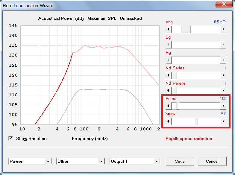

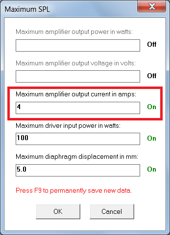

Everything seems fine except when I try to do a max power calc [works fine in the Wizard].
Hi GM,
Thanks for the feedback.
I don't know how you did it, but you managed to end up with no value for the 'maximum amplifier output current in amps' parameter 🙂. It should be 4 amps by default, unless changed to some other value by the user.
I have manually corrected your exported file, and it should work fine now.
Not knowing what caused the problem, and just to make sure, I will change Hornresp to automatically insert a value of 4 amps for Imax if it finds that no value exists.
The reason that the wizard worked okay is because it only looks at Pmax and Xmax, so the error in Imax was not seen.
Thanks again for bringing this problem to my attention.

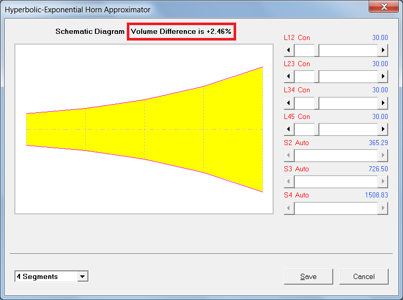

CHANGE 1
Double-clicking the schematic diagram caption in the Hypex Approximator tool now changes the volume difference from litres to percentage. Attachment 1 refers.

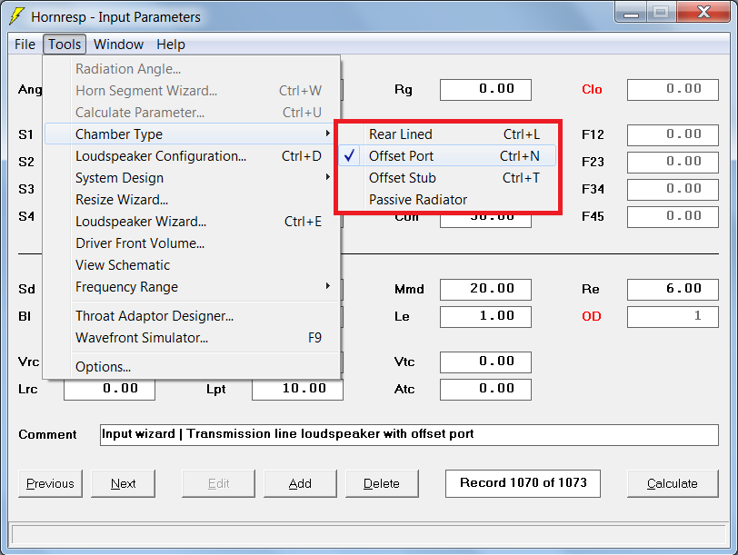

CHANGE 2
The names of the items listed in the Chamber Type menu are now context-sensitive, and automatically change as necessary to match the descriptions given in the status bar panel at the bottom of the Input Parameters window. Attachment 2 refers.

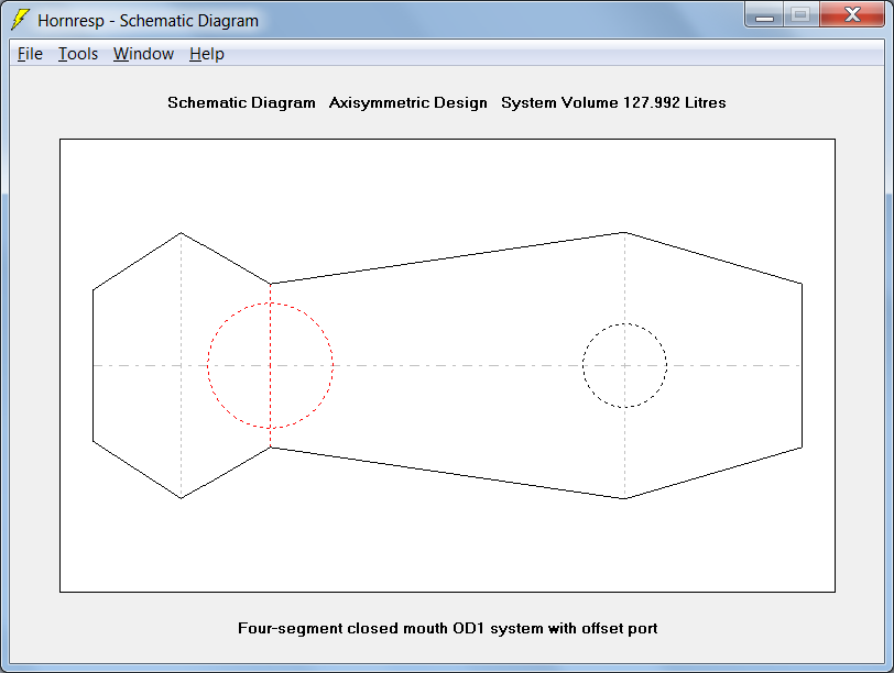

CHANGE 3
Four-segment closed mouth OD1 systems can now have an offset port, stub or passive radiator. Attachment 3 refers.
CHANGE 4
The maximum amplifier output current value in the Maximum SPL tool is now set to 4 amps if no value exists. Post #10866 refers.

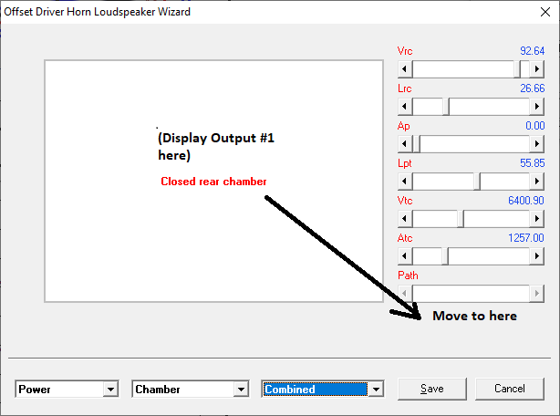

Just a minor suggestion - can the power response of a vented FLH (or basically any sim that has a "combined output" option) be changed so it looks like the attached when the "Combined Output" is selected for viewing and there's no Output #2 (i.e. the chamber is sealed)?
I've got a boxplan design that looks at a sealed FLH than can be optionally changed to a vented FLH, and modifying the Loudspeaker Wizard to show the power response like that would allow the user to leave the Loudspeaker Wizard set to "Combined Response" and just F6 to see how the response changes with any changes in the model exported from BOXPLAN.
I think I may have come up with a way to give you what you want while still meeting my "no confusion" requirement. It will however work a bit differently to your suggested method. If no problems arise during testing the new functionality will be included in the next update.
Nice. I've got a beta workbook that I'm working on now that allows (or will allow) the user to switch easily between a sealed or vented FLH. I can send a copy to you via e-mail if you want to use it for experimenting with your method. I can't publish it publicly on my site as the design is a proprietary one and I'd need permission from the owner first.
