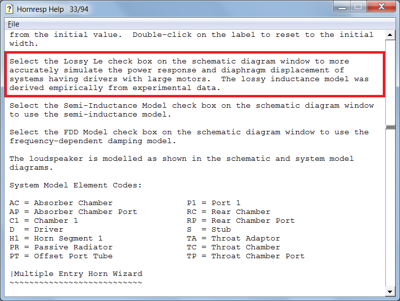

Red ‘Le’ mode triggers an issue in the OD ‘closed’ sim types where ‘electrical impedance is displayed as the direct radiator equivalent or as if the vent did not exist it seems.
The empirically-derived lossy inductance model produces misleading electrical impedance results, and for that reason is disregarded when calculating impedance. The more advanced semi-inductance and frequency-dependent damping models are however taken into account.

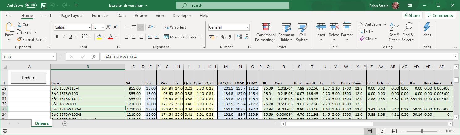

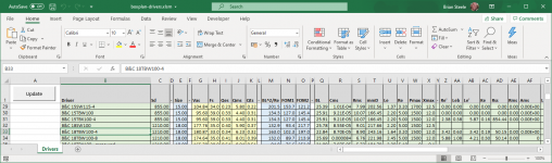

Anybody got semi inductance parameters for the 4 ohm b&c 18tbw100? I'm going to measure myself at some point but just looking for some numbers to play with for now.
Just a guy, hi, I think the semi inductance thing has a huge group of people who achnowkedge it’s importance and very much would prefer to use it if they had the ability to get those figures for the SIM. There’s a few areas that really make it a thing that stands out to lots of folks. hi performance wants/needs in a high order cabinet design colliding with a few drivers that require a red ‘LE’ to sim but the large BL^2/Re is a double whammy and must have the semi inductance version of the sim. They wanna use a driver that truly needs a semi inductance sim because of the motor design but don’t because they can’t trust a sim without giving it the measurements first.
I am in this conundrum and use a strange driver that is A large motorforce in a stressed out cabinet design. I really appreciate the need for semi inductance for this reason.
I’m looking for the 18tbw100 for you...
Grabbed from my workbook that that pulls all the drivers in Hornresp's driver database into a table :). I derived them using the published impedance curve and the Stephen Bolser's semi-inductance spreadsheet.
