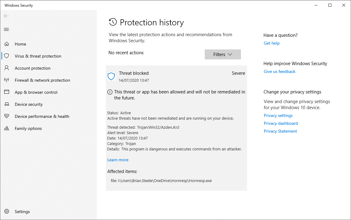

I also got this with new recent install attempt on an up-to-date windows 10.
It even deleted the application file each time I tried!
Tried install as Sysadmin - no dice.
Eventually downloading the install file via Microsoft Edge browser instead of Google Chrome, it magically worked and installed.
Once installed it's worked fine since!
Well, this can't be good....

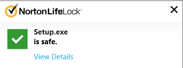

Hi Ray, Mårten, Steve and Brian,
Rest assured, Hornresp continues to be completely safe 🙂.
I have just downloaded yet another a copy myself to confirm that it hasn't been hacked in any way.
If connected to the Internet at the time that Hornresp is opened the program automatically checks to see if the latest release is being used. Perhaps this is why your antivirus protection software thinks that Hornresp contains a Trojan. The version check feature was suggested by Thawach way back in September 2012.
https://www.diyaudio.com/forums/subwoofers/119854-hornresp-281.html#post3174349
Maybe it would be better if this long-standing feature was now removed, just in case it is the cause of the problem. What do you think?
Kind regards,
David

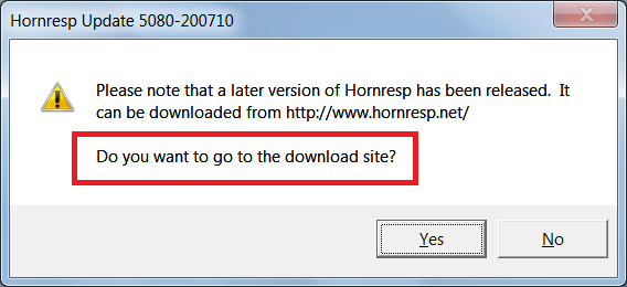

Hi Steve,
That's the way it works now 🙂.
On startup, if connected to the Internet, Hornresp checks a small file stored on the download server to see if it contains a product number with a higher value than that of the current open program. If it does, then the message shown in the attachment below is displayed. Note that the downloading of an updated version is manually controlled by the user - it is not an automatic process.
Kind regards,
David
