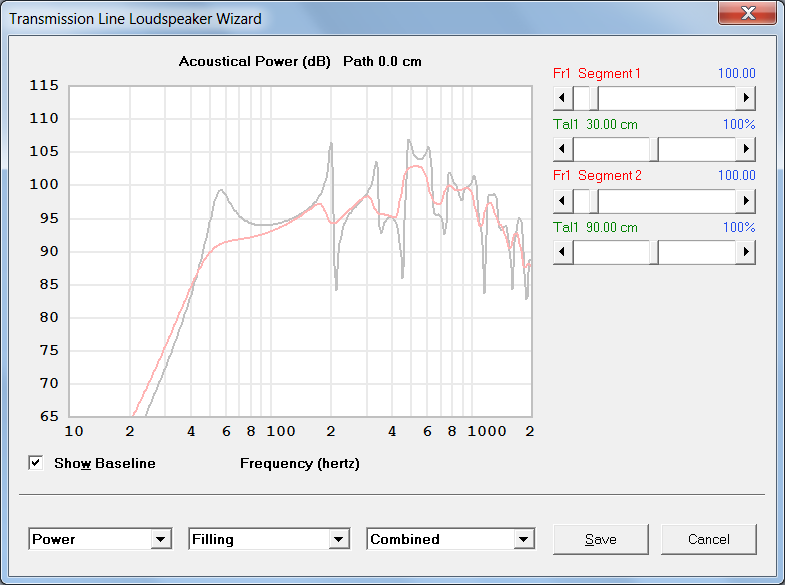

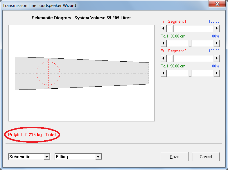

Hi thanks for a great program. I still have a lot to learn. When I adjust the filling density and recalculate I don’t see a change in the spl graph. Any pointers as to what I am missing? Does the filling and response align with the 0.5 lbs per cubic foot density recommended by MJK to damp tline resonances? Thankyou.

Absorbent filling material only affects the loudspeaker wizard results. It is not taken into account in results produced by clicking the Input Parameters window Calculate button.
I haven't had the opportunity to compare Hornresp results against those produced by Dr King's software. I am not sure though, that simply specifying a density value would be sufficient information for a theoretically-robust model . Hornresp shows equivalent weight of Polyfill in kilograms for a given absorbent filling material setting. Either the total amount in the system, or the amount in each segment, can be displayed. The absorbent filling material model used in Hornresp is a very good one. The results should be reasonably accurate.
Does the filling and response align with the 0.5 lbs per cubic foot density recommended by MJK to damp tline resonances?.

Many thanks David. Got it now. hadn’t tried this option.Hi woodo,

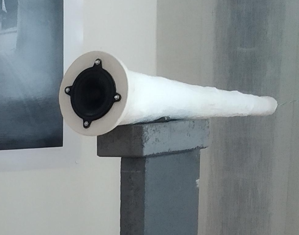

Need help for modelling Ribben Tweeter
I have been searching over internet for Horn Speaker modelling softwares, and obviously I come to know about HornResp.
I want to create horn casing for Fountek RD 1.0 ribbon tweeter, but I am filling to do so through Hornresp software.
I am also not able to find schematic of desired/required horn shaped casing.
Could someone please help me on this ?

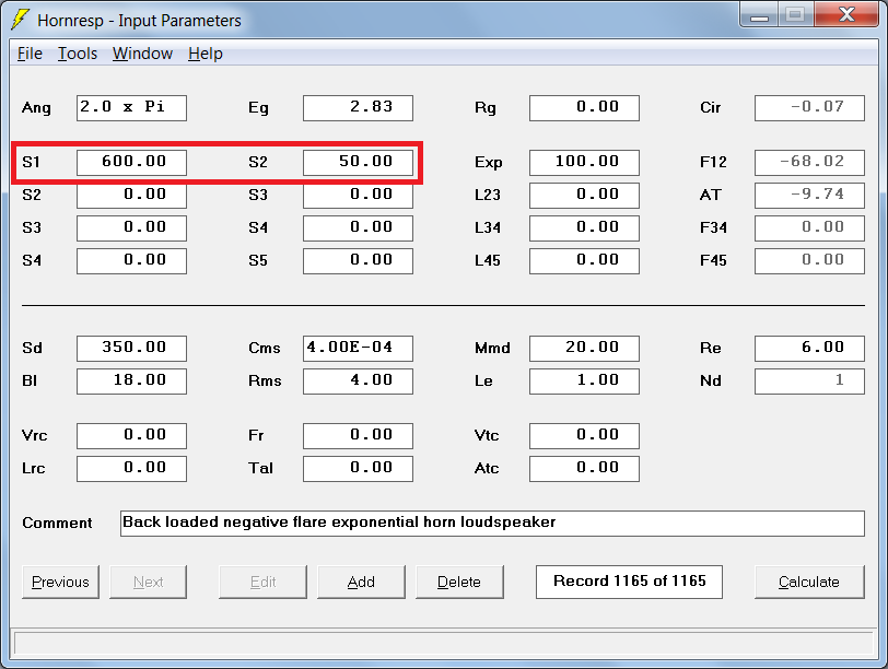

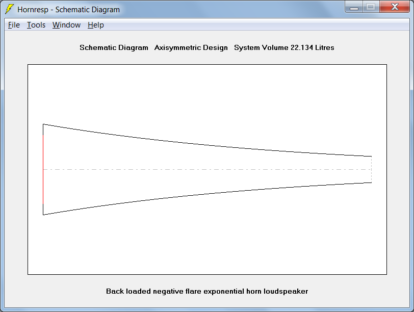

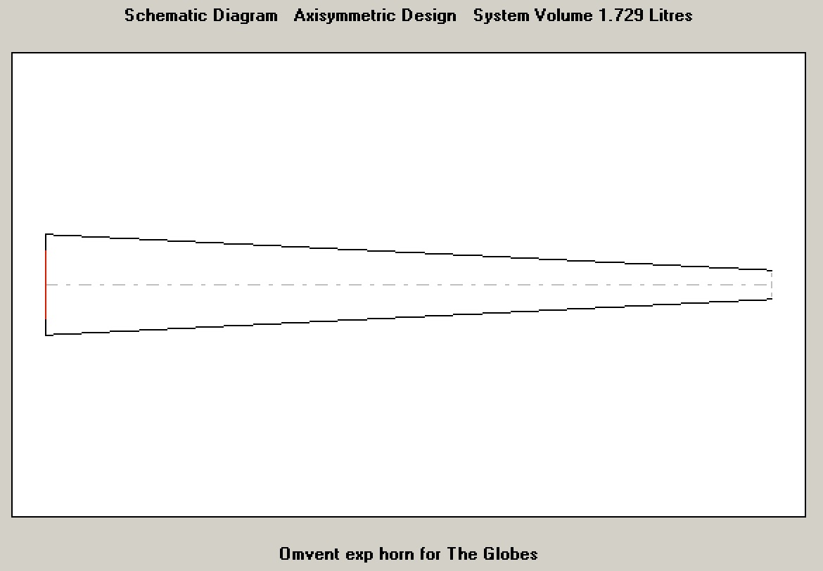

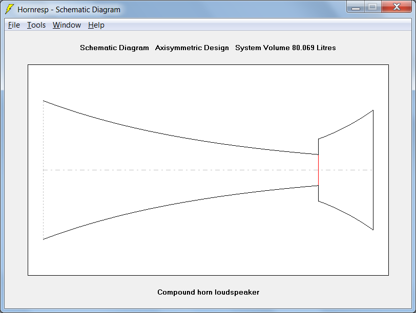

May I simulate a horn used backwards?
Yes, by specifying S1 greater than S2, as shown in the attachments.
Insufficient information available to simulate in Hornresp.

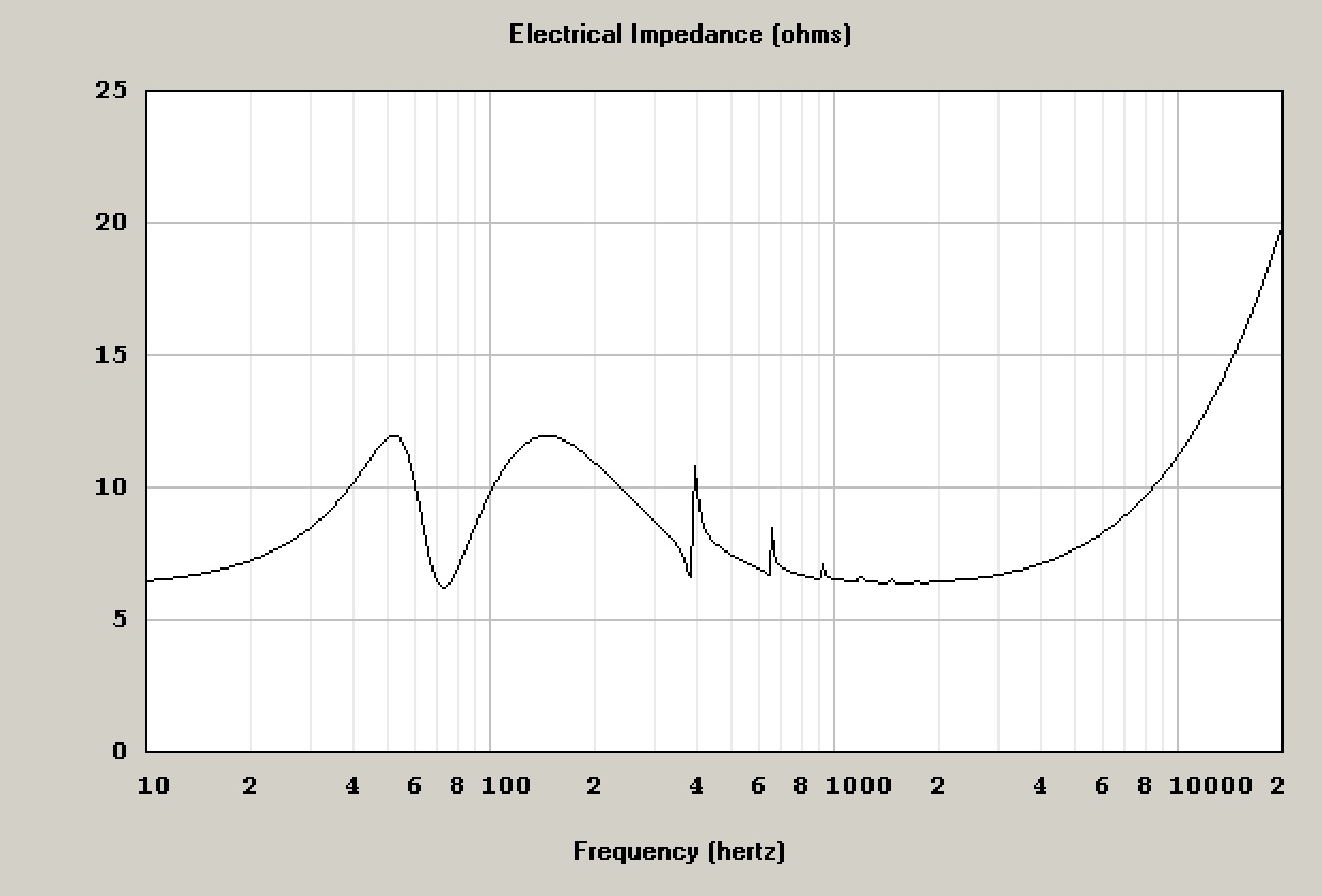

Thanks - then I did it correctly. Just shortly, why would one get these peaks?
It's a horn as per the picture in m post above...
The horn has a negative flare, and a relatively small mouth.

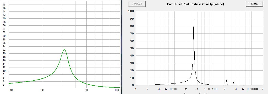

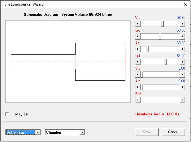

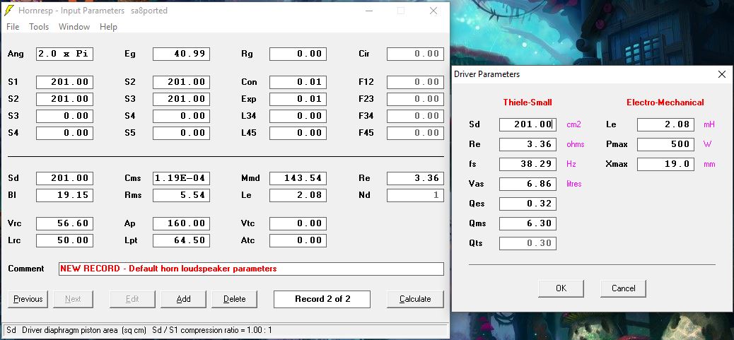

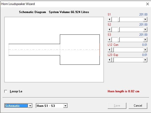

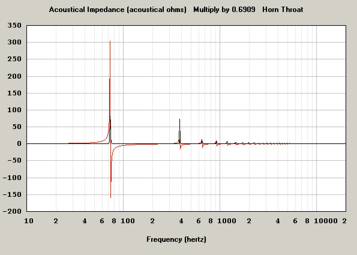

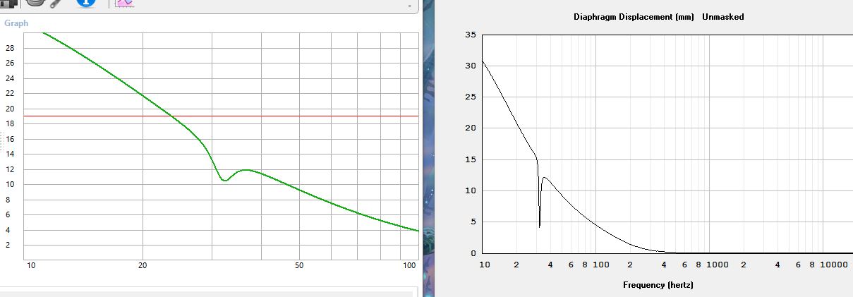

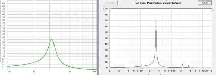

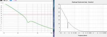

Hi, i'm having this issue where whatever driver/enclosure I model I get an extremely high port velocity/low xmax at tuning compared to other programs like winisd, i'm really not sure what i'm doing wrong, i've attatched hopefully all the information needed
model is sundown sa8v3, 2cuft box with a 20x8cm slot port tuned to 32hz (yes i'm aware a larger box will have a higher peak but this happens with anything I model)
any help is greatly appreciated
I can't see anything radically wrong with your specified design, assuming that your input values accurately reflect the desired system. Not that it makes any material difference to the results, but I would set S1, S2, S3, L12 and L23 equal to zero, as they serve no real purpose in this case. Hornresp shows the peak velocity. Is WinISD perhaps showing the rms value?
