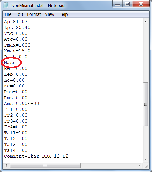

Anyone else getting the Runtime Error "13" Type mismatch when opening the Loudspeaker wizard?
I know there have been some changes because I get the Wizard button instead of the calculate button on other design types now but has the loudspeaker wizard been done away with on things like ND? or is something broken?
Hi musgofasa,
Could you please post a copy of the export file for the record that is generating the error, so that I can investigate further.
The Wizard button is only used with band pass, DBR and ABC designs.
No, if you check under the Tools menu you will find that the wizard is still there.
Kind regards,
David

Here is the export file that is giving me the type mismatch error when I try to open the wizard now.
Thanks!
Robert
I honestly don't remember if we were able to use the wizard AND the calculate button before with bandpass, DBR, and ABC designs. It's been a while since I've done anything other than 4th and 6th order designs and I've gotten used to the wizard button. I did like the ability to use the multiple speaker options like I can with THs etc. though. If there is another way to do that I'd love to know how.
Thanks!
Robert
Hi Robert,
Thanks for posting the file. I don't know how it could have possibly happened, but for some reason the passive radiator added mass parameter had no value. By default it should be zero, unless changed by the user. (You can see in the partial listing of your record file attached, that the Mass parameter has no value).
I have manually changed your export file so that Mass=0.00. If you now import this modified file, it should work just fine.

Every time I start a new project and choose the Nd option I cannot use the wizard. I can export the file, change the Mass value in the file and then import it and it works
Hi Robert,
That is very strange indeed. I have no idea why your Mass values are not being automatically set to zero by default. I will have another close look at the code to see if I can find something in there that I may have overlooked. If I can't detect anything untoward, to overcome the problem I may have to include additional code to trap the error, and to then forcibly set the value to zero.
The thing I don't really understand is why other users, myself included, are not experiencing the same problem as you.

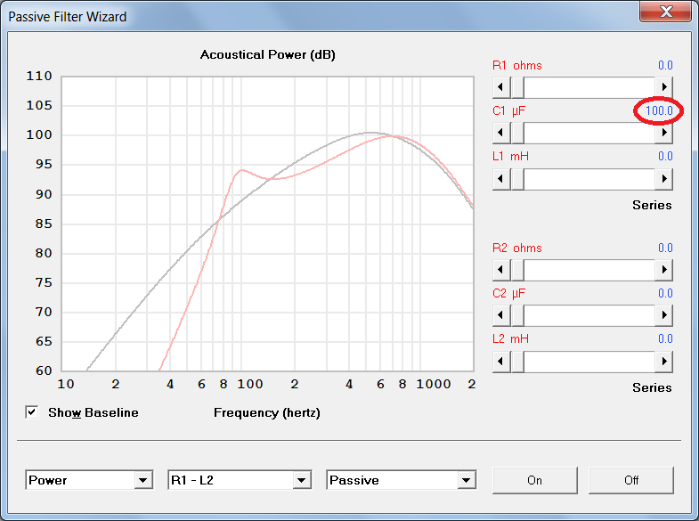

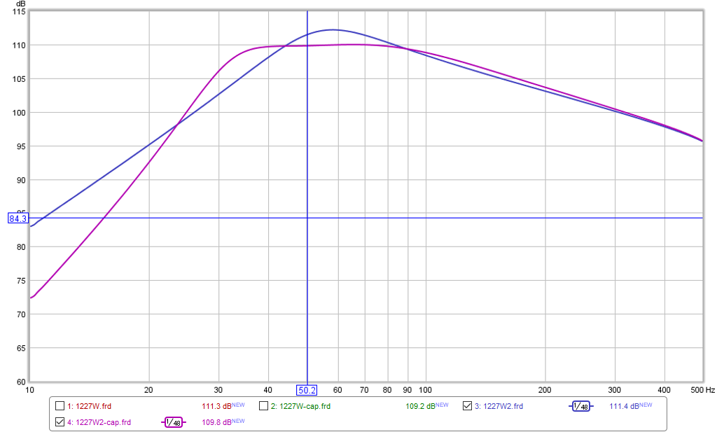

Hey David, what's the possibility of Hornresp being expanded to include passively-assisted alignments? This basically consists of a large capacitor put in series with driver, which is mounted in a small (Qb~1) box. The capacitor extends the response of the driver and reduces the response "hump" at Q. The end result is a deep response from a small box without the need to use a vent (see attached image as an example).
For now, I use Hornresp to model the small sealed box, then export the FR and impedance data for modelling in XSim with a series capacitor. As expected, the process does not allow for easy optimization...
This is eventually going to be an actual build BTW. I've got two old 122.7W 12" car audio subwoofers that are going to be repurposed for home subwoofer duty in small sealed boxes using a passively-assisted alignment. 30 Hz from 1 cu.ft. net box at a pretty decent SPL without having to resort to an expensive PR or a long honky vent? Yes please

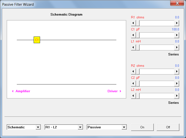

Hi Brian,
Why can't you just specify the series capacitor using the existing passive filter wizard tool?
The passive filter option is not available in the loudspeaker wizard, but hopefully that is not too much of a problem.
