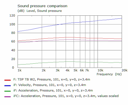

Hi David,
I still don't understand, why constant velocity drive of the diaphragm is preferred over constant acceleration drive.

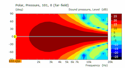

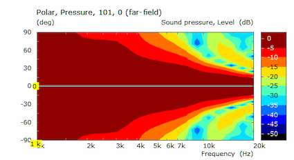

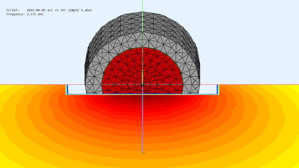

I did a short series of simulations in ABEC comparing constant velocity drive vs constant acceleration vs LEM / TSP drive of the same 2''-diaphragm in a very simple enclosure:
Directivity for the membrane driven with the TSP taken from a 2'' TangBand chassis (W2-748SG):

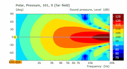

Same membrane in same enclosure, driven by constant acceleration:

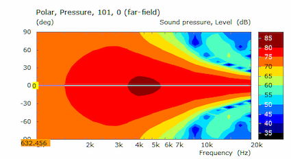

Same membrane, same enclosure, membrane driven by constant velocity:
Comparison of SPL on axis in one image (TSP-driven, const. acceleration, const. velocity):
Not very surprising, this shows the SPL increase with increasing frequency for constant velocity. It shoes as well the very similar SPL for constant acceleration and TSP-drive of the membrane.
Of course, as long as we look at normalized directivity of a horn, it does not matter, which type of drive is applied to the membrane (see control-check, i.e. normalized directivity). This is identical for all three types of drive:
As constant acceleration reflects SPL of a driver much better than constant velocity drive - why is constant velocity drive still preferred for HornResp simulation? Does this fit better to compression driver behaviour (I did not look at this, but DonVKs comment suggest this)? I may have missed something here though...

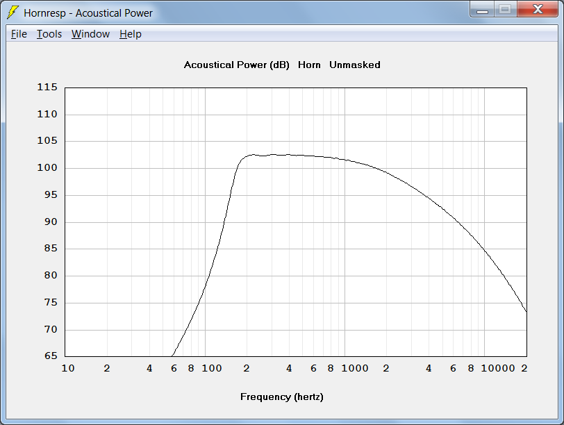

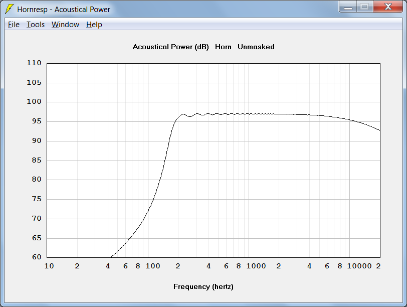

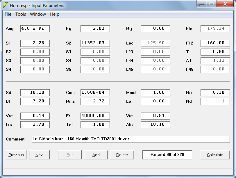

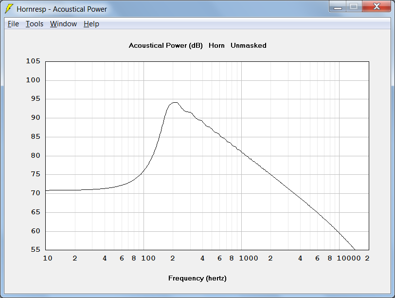

Hi Gaga,
The three attachments show the power response of a 160Hz Le Cléac'h horn with T = 0.8, under the following conditions:
Attachment 1 - TAD TD2001 driver with Eg = 2.83 volts rms
Attachment 2 - Driver diaphragm with a constant velocity of 10 cm/sec rms
Attachment 3 - Driver diaphragm with a constant acceleration of 100 m/sec2 rms
As you can see, the constant acceleration result is very different to the constant voltage and constant velocity results.
The constant velocity option was requested by Jean-Michel, who is sadly no longer with us. The following comments in quotes are taken from two of his posts:
"The constant velocity diaphragm will be very useful to compare horns without the influence of the driver."
"You can simulate a 1" or a 2" horn without knowing the Thiele and Small parameters, introducing Eg = 0 (in place of the normal value Eg = 2,83). Doing this the driver will be considered as a "constant velocity source". This feature is very interesting when designing new horns without knowing the Thiele and Small parameters. For sure the results will be better than with a real driver, specially in the HF (because moving mass = 0)."
Jean-Michel was also the first person to mention constant acceleration, but the option was not added to Hornresp because he didn't specifically request that it be included.
Kind regards,
David

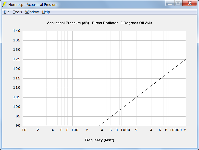

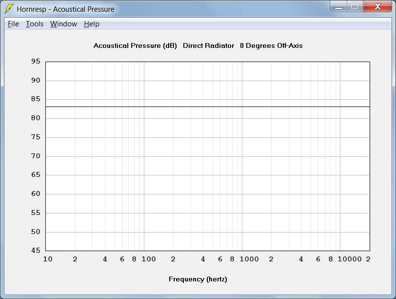

Further to my post above, note the on-axis pressure results when constant velocity and constant acceleration are applied to a piston in an infinite baffle.
Attachment 1 - Constant piston velocity of 10 cm/sec rms
Attachment 2 - Constant piston acceleration of 100 m/sec2 rms
(Sd = 150 cm2 in each case).

I could not find any TSP for the TAD TD2001. Would you mind to post the TSP values you used to model a compression driver in HornResp?
Hi Christoph,
I used the values shown in the attachment.
(The driver and chamber values are the same as those given by Don in his first linked post).
Kind regards,
David

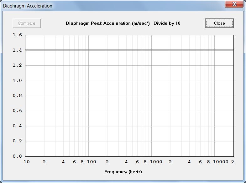

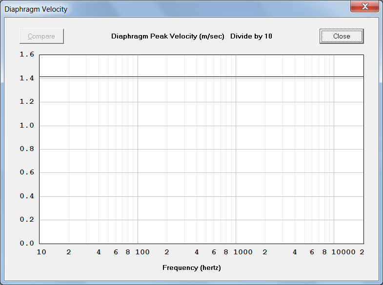

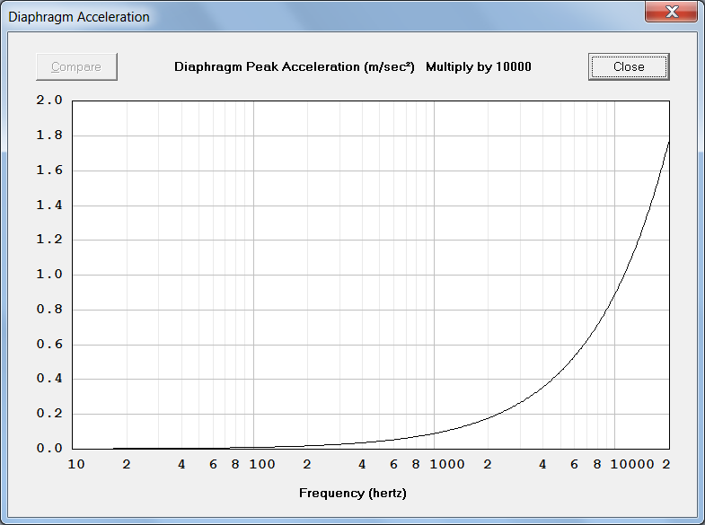

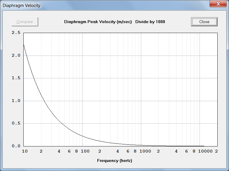

For constant velocity acceleration is zero
Hi docali,
The term constant velocity as used in Hornresp means that the rms and peak values of the diaphragm velocity do not change with frequency. The actual velocity and acceleration of the diaphragm will vary sinusoidally with a 90 degree phase difference between the two.
For constant peak velocity as shown in Attachment 1, the peak acceleration varies as shown in Attachment 2.
For constant peak acceleration as shown in Attachment 3, the peak velocity varies as shown in Attachment 4.
Kind regards,
David

Hi David,
Of course, since unless the driving method can change how the diaphragm breaks up, it cannot change the directivity. Which again highlights the fact that you cannot modify the directivity of a single driver by electronic means.
Constant acceleration gives flat SPL for a direct radiator, where the radiation resistance increases 12dB/octave. This is not the case for horns.
