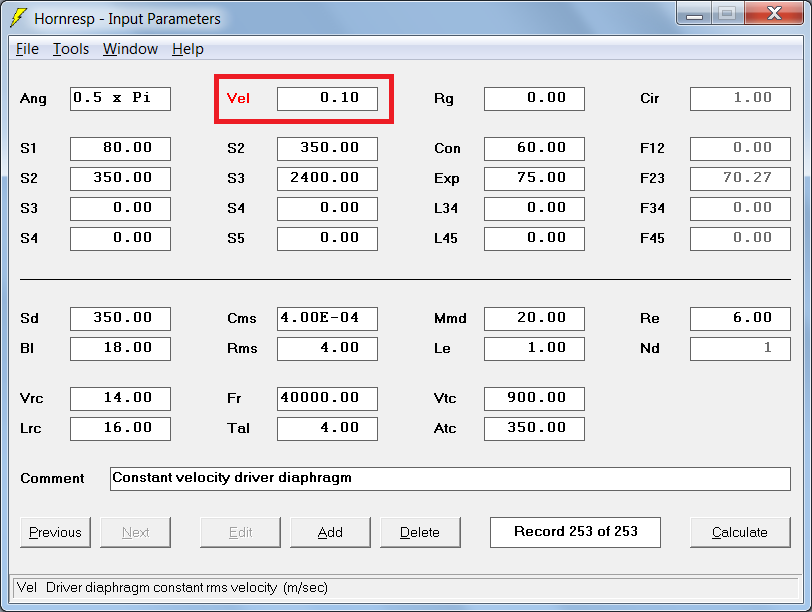

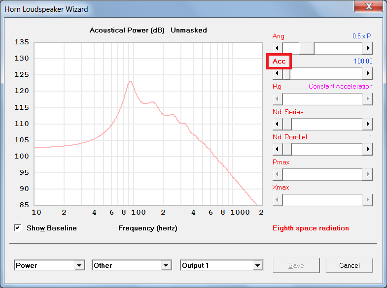

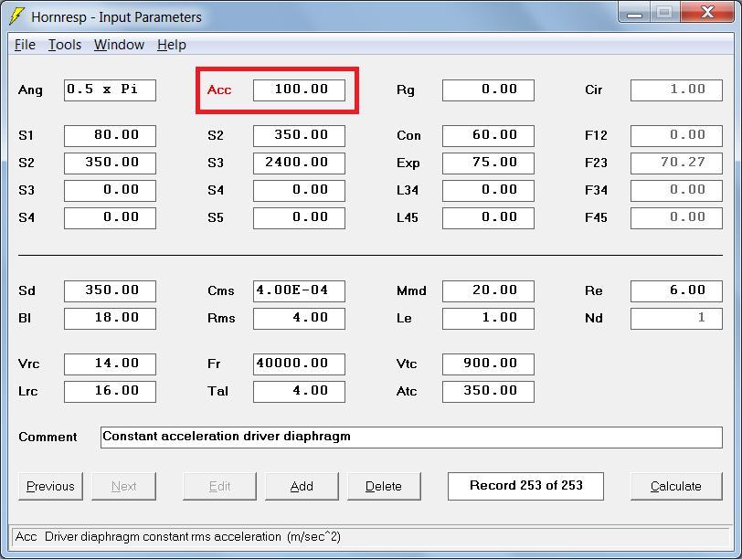

Hornresp Update 4930-190411
Hi Everyone,
CHANGE 1
Previously the constant diaphragm velocity option was selected by specifying Eg = 0. This option is now selected by double-clicking the Eg label in edit mode or by pressing V when the Eg text box has the focus. The default is 0.1 m/sec but this value can be changed by the user if required. Attachment 1 refers.
CHANGE 2
A constant diaphragm acceleration option has been added because of recent posts on the subject, despite questions surrounding the usefulness of the option. The new option is selected by double-clicking the Vel label in edit mode or by pressing A when the Eg or Vel text box has the focus. The default is 100 m/sec^2 but this value can be changed by the user if required. Attachment 2 refers.
To change the selected Eg, Vel or Acc option in the Loudspeaker Wizard, double-click on the label above the slider control. Attachment 3 refers.
As before, the Vel option, and now also the Acc option, are not applicable to ME1, ME2, BP4, BP6, BP8, DBR or ABC records.
Kind regards,
David
