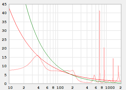

Hi David !
To help interpretation of group delay while tweaking in wizard, should it be possible to have a time delay slider to interpret in desired bandwith ?
There is really too much free space above width slider ^^
See really specific GD case below.
Thanks a lot,
David
Thanks a lot,
David
Hi Damien,
Sorry, the group delay chart is complicated enough already, with the group delay per period option and the ability to add 1/f and Claus Futtrup limit guidelines.
Kind regards,
David
