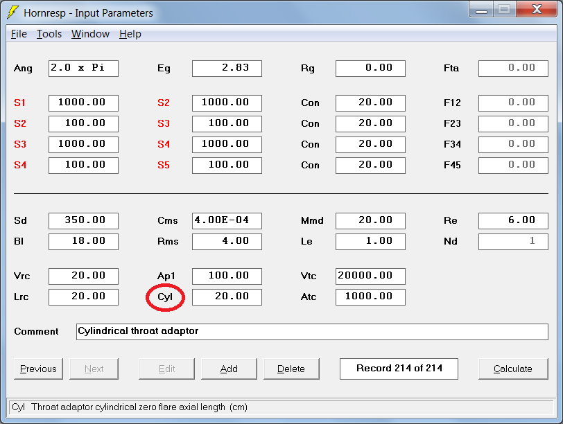

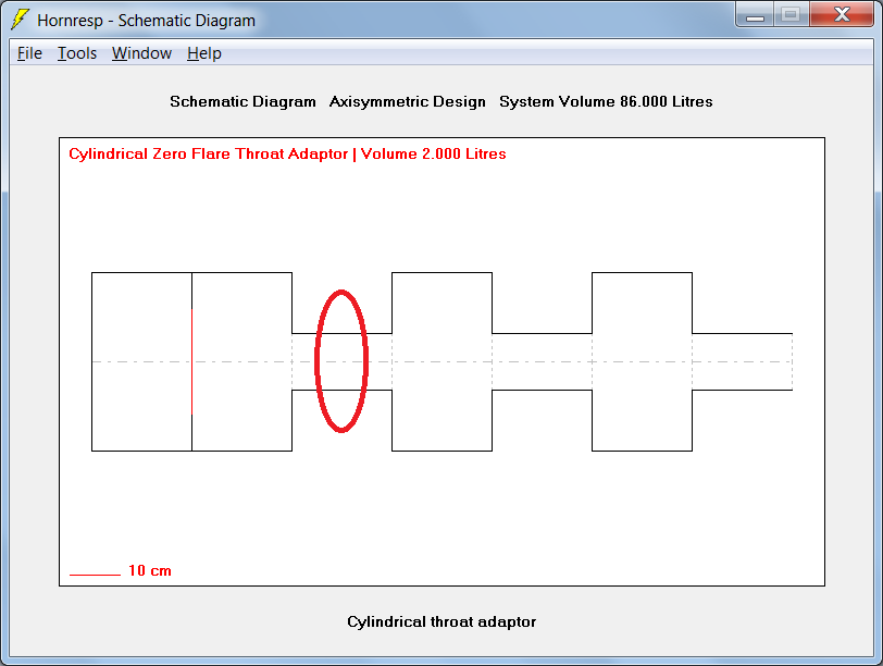

CHANGE
It is now possible to specify a cylindrical throat adaptor with a step discontinuity at the horn throat. Double-click the Lp label twice in edit mode or press C twice when the Lp text box has the focus to select the cylindrical (Cyl) option. The conical, exponential and parabolic throat adaptor options are still retained as well.
The cylindrical throat adaptor option was requested by Damien in Post #9305.

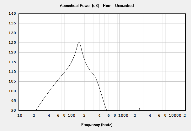

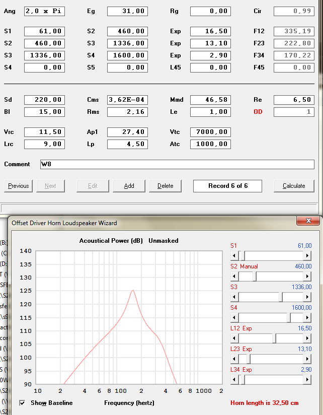

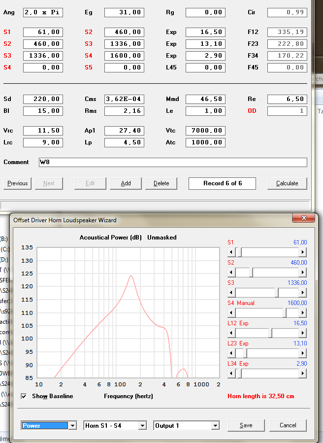

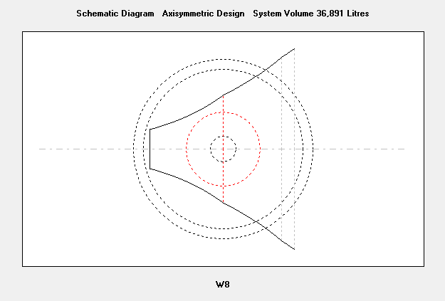

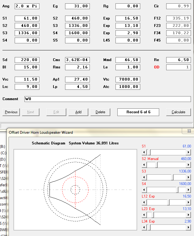

Thanks a lot for Ap1 flare mode tweaking ! Allowing to change it shape in wizard too, is a really nice add !
I tryed closed back with 3 front chamber, it allow something > 8th order low pass with low order high pass (very sensitive to build and parameter though )

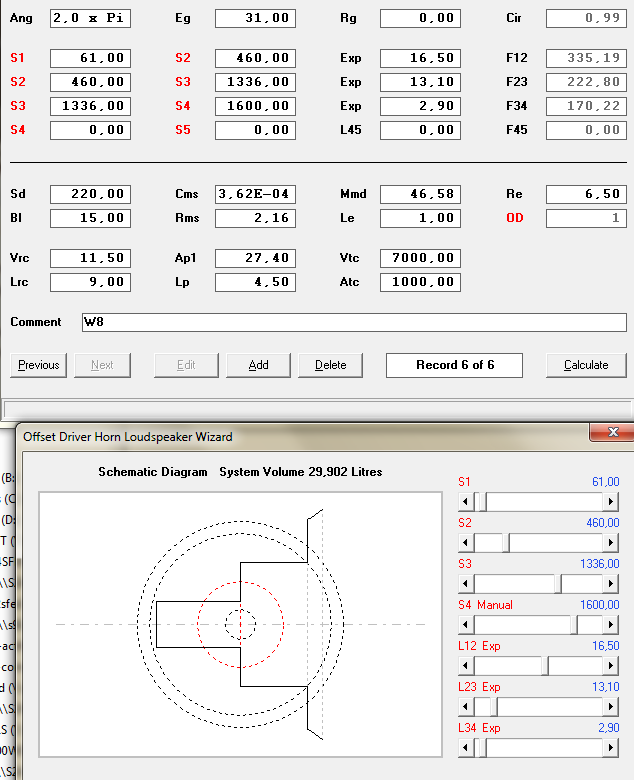

And I've done my homework, and got a bug to report about stepped segment add.
In OD, "flared"/normal segments, result is ok and same using wizard, or calcul screens (A).
In OD, Stepped segment, result is ok in wizard, but in calcul screens, it is flared (B).
A : flared/normal segments :
Picture 1-2 sim in wizard (same result for calcul screens) => OK
B : Stepped segments :
Pictures 3-4 stepped sim in wizard => OK
Picture 5-6 stepped sim in calcul screens => not ok => stepped segment not token in account.
Only test in Nd and OD for the moment

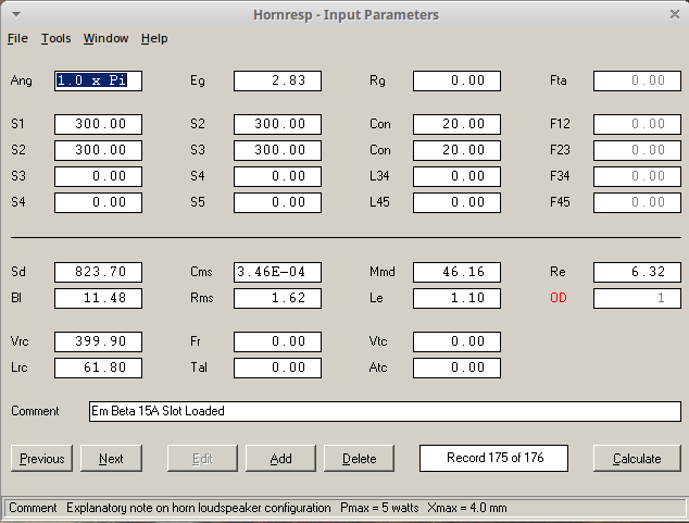

I am trying to simulate a slot loaded woofer with sealed rear chamber. The suckout due to cavity resonance appears in the simulation at the expected point but there is also a huge spike just before the half wavelength point.
So first question: what is the physical mechanism for this spike and are there any acoustical treatments that might reduce the magnitude of the spike?

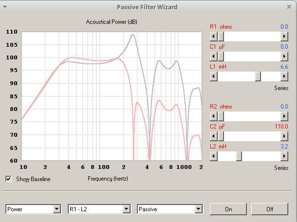

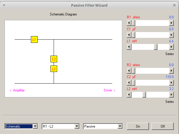

In using the filter wizard to simulate a passive 3rd order LP at 200Hz a big spike at the lowest part of the pass band is created. I assume this is an interaction with "Le" correct?
If I reduce the first inductor (and slightly reduce the parallel capacitor) I get a simulated response that is pretty flat. Are the values so determined likely to actually work pretty much as simulated in real life?
Shown below are the input parameters for the Eminence Beta15A and the filter wizard results where the grey line is the unfiltered driver output and the red is the adjusted LP filter response.
PS. if one opens the mouth up slightly so that it looks like a very short horn what is the flare type if only one side is angled or if two sides are angled?
Actually I did the filter wrong but accidentally got a good response. I accidentally put the second inductor in series with the parallel cap.
you've already got fairly wide bandwidth, but if you want more,go ahead and do what you seem to be thinking of: turn that slot into a shallow horn like I did:
Companion Woofers for my Synergy Horns
Had to look at the thread to see what I showed.
The slot is narrow in back and wide in front for one flare. The flare angle is only about 10 degrees or so.
The slot is short around the mid height point in back and tall in front for two flares.
And constant for just a panel thickness at the front for a third segment that doesn't flare.

Hi Damien,
You need to re-do your homework - it's not a bug .
You have selected the stepped segment mode, but the values specified on the main input screen have not been stepped, which is why you are seeing normal flared segments in the schematic diagram. In the loudspeaker wizard, because of the limited number of sliders available, when the stepped segment mode is selected the segments in the wizard are automatically stepped, as shown in your example.
For other loudspeaker types, the throat chamber port tube is always cylindrical. There is not enough information available to specify a conical, exponential or parabolic flare.

Ap1 flare option work too in CH mode(not in CH1).
CH1 has an offset driver so the throat chamber port tube needs to be cylindrical, because there is not enough information available to specify anything else.
I must verify twice when i finish my homeworks next times.
