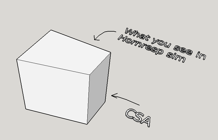

csa versus diagram in HR
As I am constantly reminded, I am "mental". Got up this morning and realized what exactly CSA means in regard to the actual 3D model that HR is simulating. Once I "grokked" CSA, I could then design my box, since I know the width already. Thanks David and GM. I'm going back to my morning coffee cup.

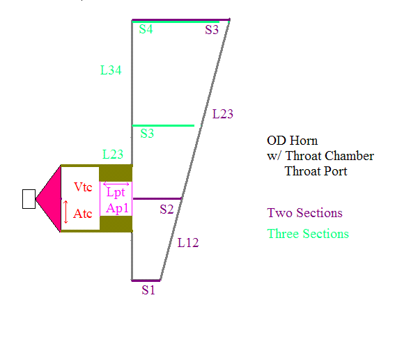

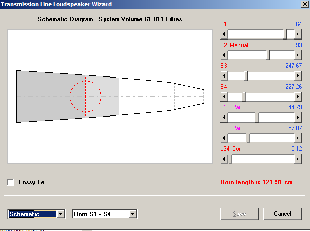

Folks,
So I have produced a Tapered TL that has acceptable size, F3, and TL length for my drivers.
Question: All I see in the Loudspeaker Wizard is the cross section area of each segment, but the schematic shows system volume. Where does it get the internal width from for the volume calculation?
Second Question - so my S1 has a particular cross section area, and it has the shape of a trapezoid. I know the length = L12. Is there any way to determine the dimensions for the large end and small end of S1?
Apologies if this is remedial geometry.
Thanks in advance.

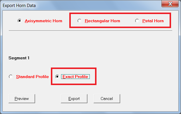

Hornresp Update 4910-190324
Hi Everyone,
CHANGE

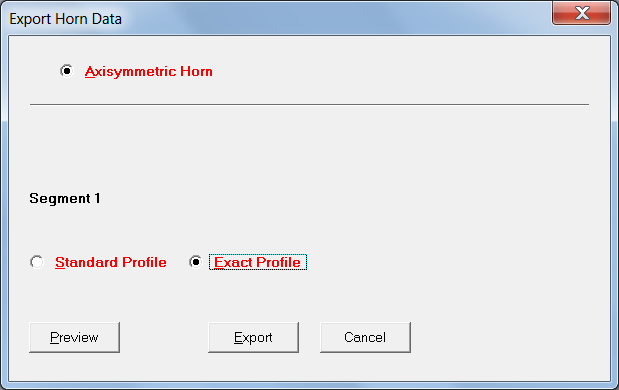

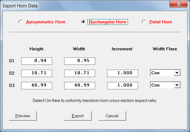

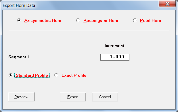

When the construction data for a Le Cléac'h horn is exported it is possible to specify either the standard 2007 flare profile (which becomes slightly inaccurate near the horn mouth) or the exact axisymmetric profile.
Previously when the Exact Profile option was selected it was possible to choose from either the Axisymmetric Horn, Rectangular Horn or Petal Horn options, even though only the axisymmetric profile data would be exported, regardless of the option chosen. Attachment 1 refers.
Now when the Exact Profile option is selected, the Rectangular Horn and Petal Horn options are hidden to avoid any confusion. Attachment 2 refers.
(The axisymmetric, rectangular and petal horn data export options are all still available when the Standard Profile option is selected. Attachment 3 refers).
Kind regards,
David

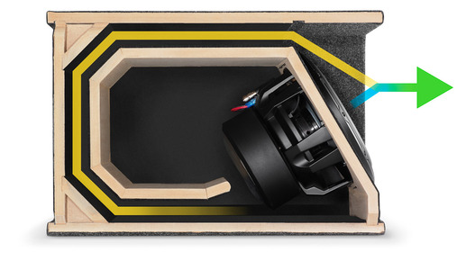

These enclosures are tapped horns with throat chambers.
Pic 3 is a guideline to use for HR even though it's an offset driver front loaded horn.

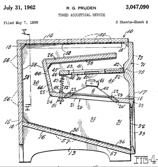

@ BP1Fanatic
Thanx for posting 🙂
I had forgotten about the Pruden PAT & the other one 🙁
The Pruden & the one underneath it, both have the drivers facing into the devices.
Several years on here ago i asked if due account should be made for polarity when doing that with TH's. I was told no ! I'm still not sure ?
The one in the middle of the group of three is not a tapped horn. It is a vented box with a long port. Lot's of those masquerading as tapped horns. If there is no throat to mouth taper and a tapped point in the path it isn't a tapped horn.

True, a standard TH has a constant positive flare.
However, you can use the TH function in HR to model positive, straight, and negative flare enclosures.
The Pioneer and JL Audio enclosures look live bugle horns!

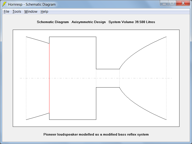

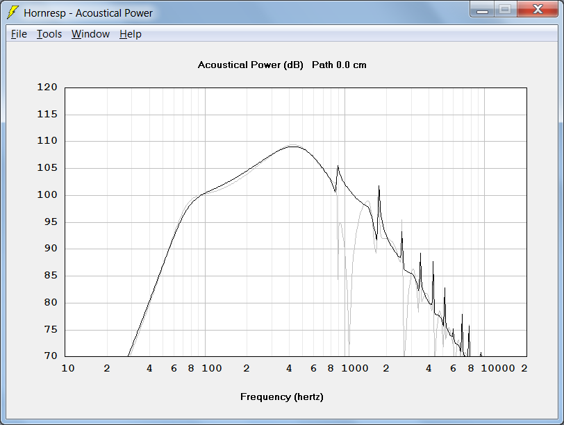

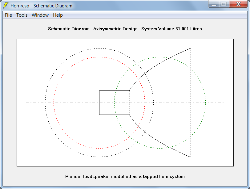

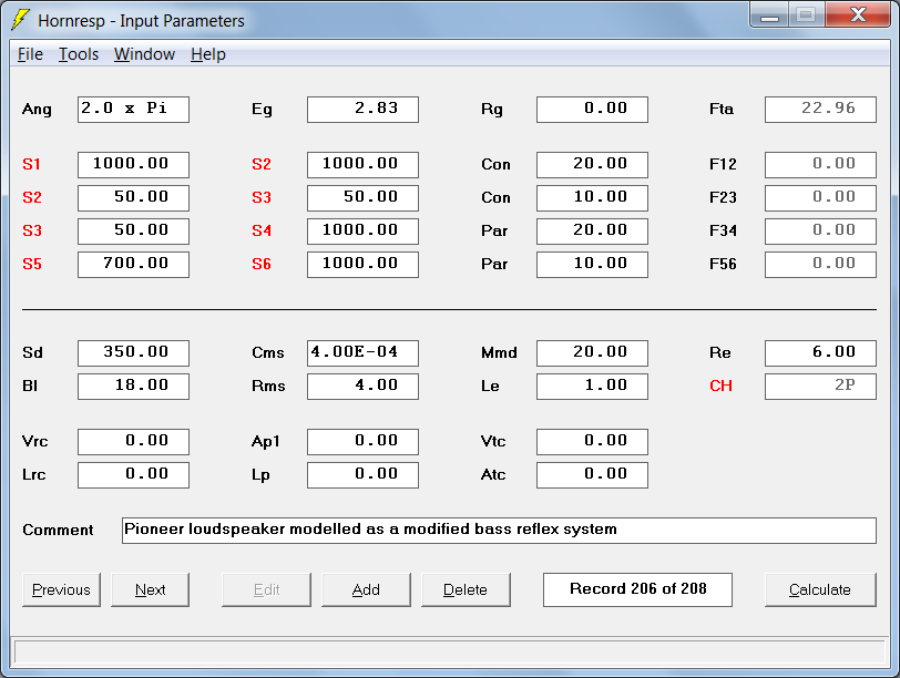

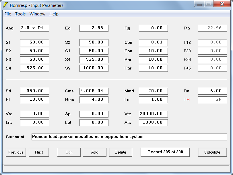

What happens when you simulate using these two models? Are the results similar in any way, or are they completely different?
My curiosity got the better of me - I simulated the Pioneer design (not to scale) both as a tapped horn and as a bass reflex system with the port tube flared at the exit and the direct radiator output side appropriately loaded. Attachments 1 and 2 show the tapped horn system, Attachments 3 and 4 show the "modified" bass reflex system. Attachment 5 compares the responses of the two models (grey trace is tapped horn system, black trace is bass reflex system).
Considering that the results are calculated using completely different methods in the two models, it is pleasing indeed to see that the responses are very similar up to about 1000 hertz - yet another example of the flexibility of the Hornresp simulation models 🙂.
VERDICT - It seems that you can use either model, but my original "gut feeling" bass reflex choice gives a slightly nicer-looking response at the higher frequencies 🙂
