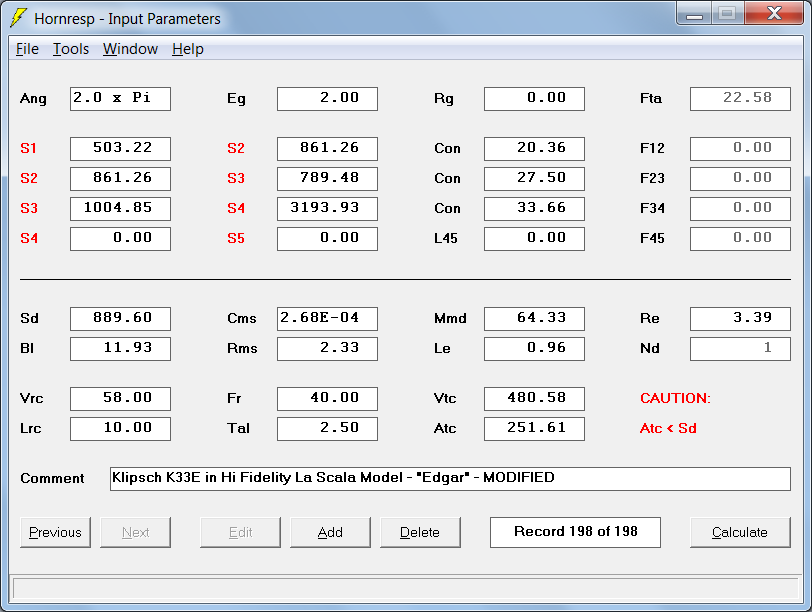

Hi David - the resize wizard seems to not let me downscale below unity and says "1.01" as minimum size. Did I goof up something ?
Hi freddi,
The Resize Wizard checks to see that all the re-scaled parameter values are within the standard permitted input limits. If they are not, then the error message will be generated. If you would like to post a copy of the record you wish to rescale, I can identify for you which parameter value is causing the problem.
Kind regards,
David
oh - I must had messed up something - don't see well

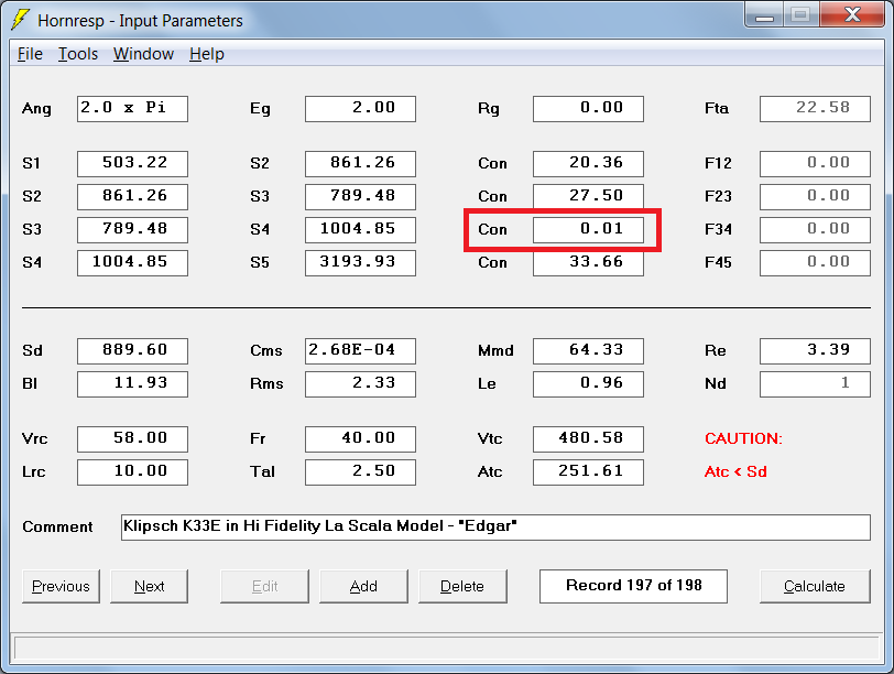

Hi freddi,
Thanks for posting the record.
You didn't mess anything up - the problem parameter value is the 0.01 cm length of segment 3.
If the Resize Factor is less than unity the re-scaled value of L34 becomes less than 0.01, the permitted minimum limit, which is why the error message is being generated. To get around the problem, use the recently-added stepped segment functionality to avoid having to include the 0.01 cm length segment, as shown in Attachment 2.
Kind regards,
David
Many Thanks !
Hi freddi,
Not a problem 🙂.
Just to complete the picture, before the stepped segment feature became available the way around the problem would have been to simply increase L34 from 0.01 to 0.10, to permit up to a ten-fold size reduction (with a ten-fold reduction, 0.10 would re-scale to 0.01, the minimum permitted value for L34).

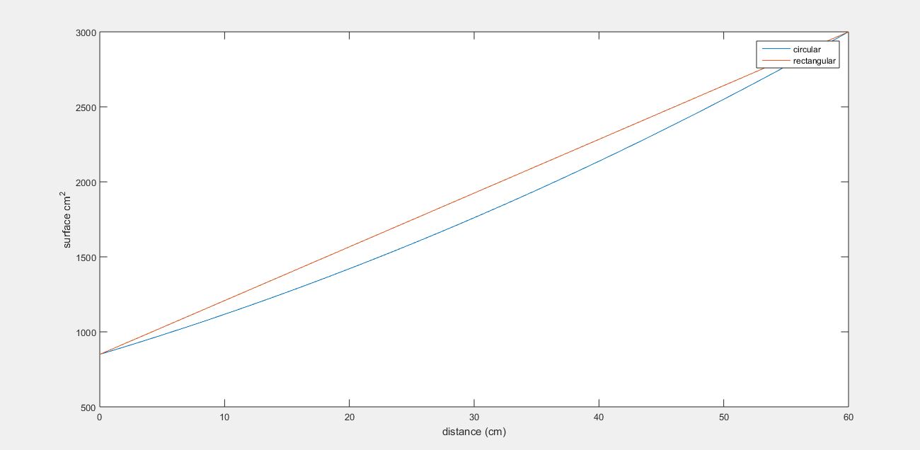

Hello all,
I discovered horn resp a few times ago, its really amazing but i'm missing few informations about the functionning.
I assume that the shape of the expansions are made for circular horns. However, a lot of people uses hornresp to simulate some low frequency cabinets. In the case of a cabinet of fixed width with a straigth expansion on the other axis, only one dimension is expanding. This leads to a straigth expansion of the surface (theorically corresponding to a parrabolic expansion). However, most of the simulations that i see people doing uses conical expansion (which theorically corresponds to a squared expansion of the surface). I didn't find any informations concerning hornresp's expansions laws. I have linked a simulation of the expansion of a fixed width cabinet with a straigth expansion along the other axis and a theorical conical expansion. It appears that there is effectively a difference between the 2.
Does someone knows what expansion to use in that case?
Thanks in advance
Thanks in advance

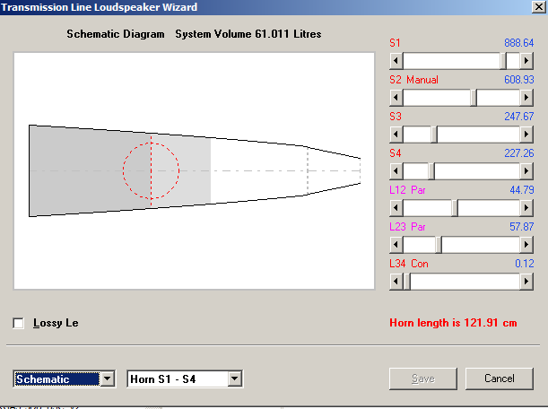

Folks,
So I have produced a Tapered TL that has acceptable size, F3, and TL length for my drivers.
Question: All I see in the Loudspeaker Wizard is the cross section area of each segment, but the schematic shows system volume. Where does it get the internal width from for the volume calculation?
Second Question - so my S1 has a particular cross section area, and it has the shape of a trapezoid. I know the length = L12. Is there any way to determine the dimensions for the large end and small end of S1?
Apologies if this is remedial geometry.
Thanks in advance.
