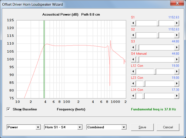

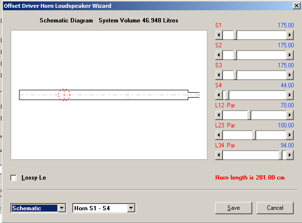

David, I posted this in Multiway yesterday - of course this is a better place, since it's really an HR question.....

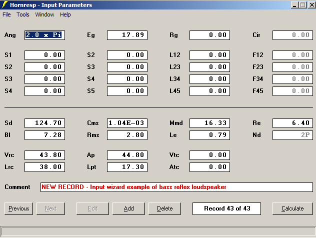

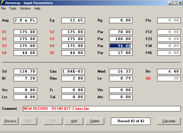

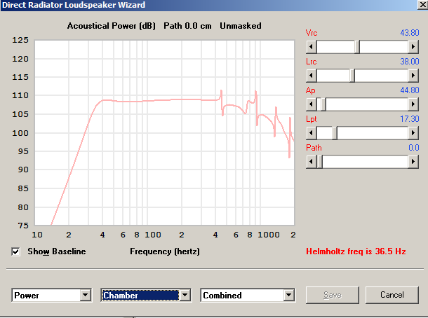

I built a small(ish) MTM with 2x 4 inch drivers, and want to add a bass bin using 2X RS180 woofers in a TL. I'm getting a lot (too much) variation at Fb using Unibox, HornResp vented sim, and HornResp OD TL response.

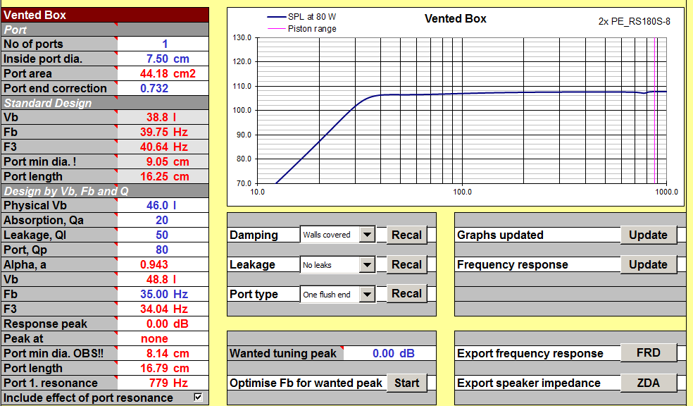

I've used Unibox a lot, and it shows 2X RS180 in 46 liters with a 3" ID port that is 6.75 inch long (Fb/F3 35 HZ) with a flat response. Modeling the same (or very similar) in HornResp using a Vented wizard shows a very similar response, but modeling the same in a classic OD TL design with a port shows a large droop prior to Fb.
Obviously, I'm stumped. The sims use the same drivers, in similar boxes, with similar tuning, but a large difference in bass output.

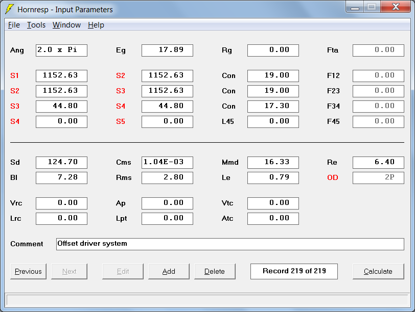

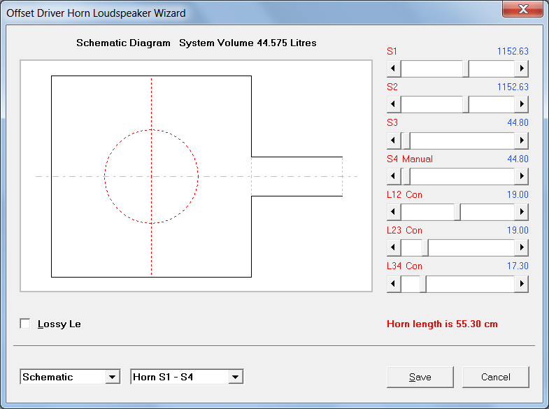

Hi joetekubi,
For the comparison to be valid, your offset driver system design needs to be as shown in Attachment 1. Adjusting L12 in the Loudspeaker Wizard will change the position of the offset driver. You will find that the actual position of the driver makes very little difference to the response at bass frequencies.
There will always be a slight difference in the fundamental resonance frequencies of the two systems because the Hornresp bass reflex design automatically includes an internal end correction on the port tube, whereas the offset driver design does not. For your test examples, the resonance frequency of the bass reflex design is 36.1 Hz and the resonance frequency of the offset driver design is 37.8 Hz.

Thanks David -- looks like you modeled a BR in a different fashion than the wizard. Your results are pretty identical to the HR BR wizard I ran as well as the Unibox model. I'll play your model - I'm really most interested in simming a MLTL for this project.
