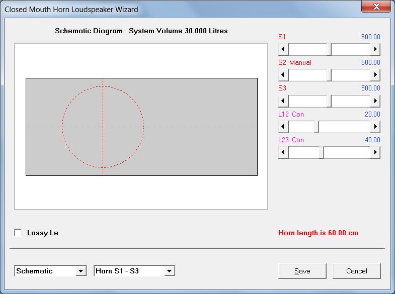

Hi Florent,
Model the front loaded horn with rear vented chamber as a compound horn. Filling material can then be added to the chamber (segment 1) and/or port tube (segment 3) as shown in the attachment. The horn itself will be limited to a single Con, Exp or Par flare.

It works perfectly to reduce the output from the port !!
Thank you

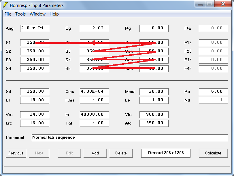

Just one small thing David.
The new functions make it more cumbersome to enter data. Before, pressing enter after entering the numbers brought you to the next field. It still does that, but now, the other s2/s3/s4 fields also have to be changed. So there's a whole lot of to and from the mouse clicking the various fields, vs *numbers* *enter* *numbers* *enter* *numbers* *enter*.
I do not mind the new functions, they are great! But could you change it so I can still enter the numbers without moving my hands all the time?

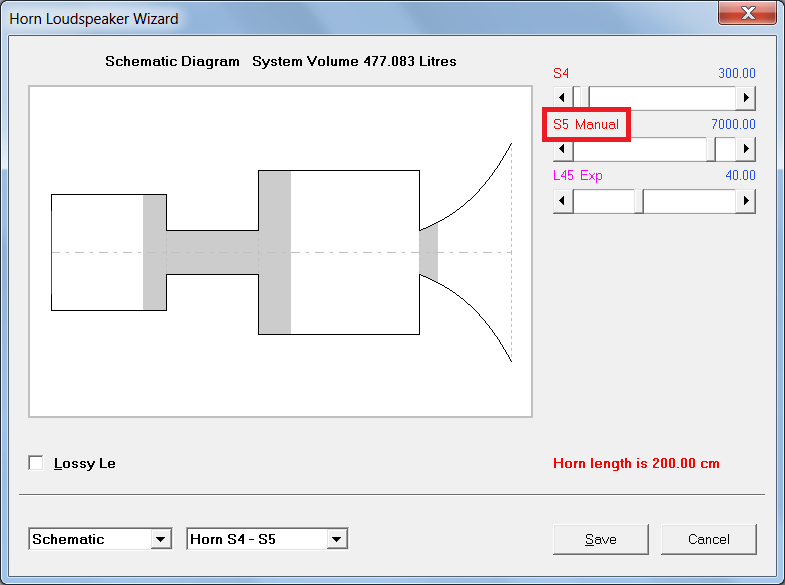

CHANGE 1
The Loudspeaker Wizard now works with stepped segments. The final segment at the horn mouth end can have a conical, exponential or parabolic profile. Other segments will be cylindrical regardless of their specified flare rates. The value of the mouth area slider can be set independently using the Manual option, or automatically if a cylindrical final segment is required. Absorbent filling material can be added to stepped segments. Attachment 1 refers.

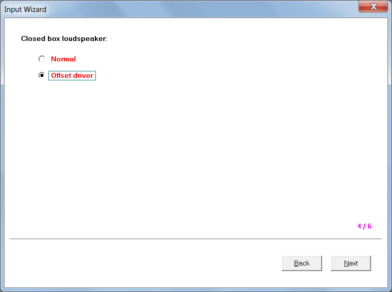

CHANGE 2
A 'closed box loudspeaker with offset driver' option has been added to the Input Wizard. Absorbent filling material can be added using the Loudspeaker Wizard. Attachments 2 and 3 refer.

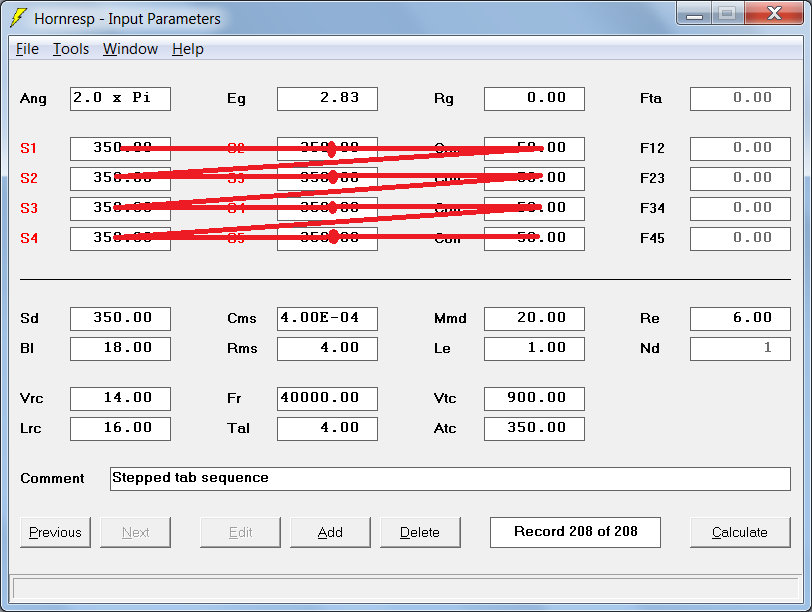

The stepped segments tab sequence on the main input parameters window has been changed to enable throat-end cross-sectional area input boxes to be accessed more directly when the Tab or Enter keys are used to navigate between input boxes. This refinement was requested by KaffiMann in Post #9188.

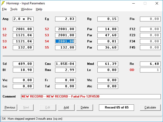

Hello David.
The issue is still present, see attached picture.
This was using v49.10 the newest on your site just a few minutes ago.

Closed box with offset driver! That's great news! Thank you. I've been silently hoping for that.
I don't understand. The tab sequence has been changed for stepped segments as shown in Attachment 2. What issue is still present?

There was nothing to prevent you from specifying a closed box with an offset driver before the latest release. It's just that the enclosure type has now been included as an option in the Input Wizard.
