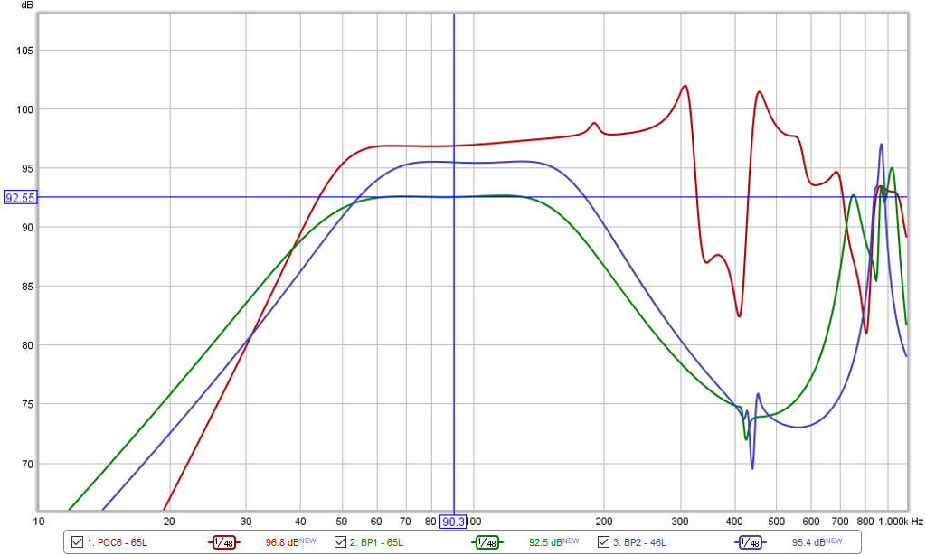

The attached image is a comparison of the Dayton PA310 (rated 96.1dB/2.83V/1M) simmed in a (1) 65 liter 48 Hz MLTL, (2) 65 liter 4th order B and (3) 46 L 4th order BP.
The passband SPL differences between the MLTL and the two BP enclosures is pretty significant (4.3dB) in the first instance, where the systems are the same box volume.
I'm just wondering if this is expected behaviour. I was expecting a difference, but not that big.

Trade-off is high pass slope => higher group delay. Try simulate the same curve with 6th parrallel bandpass with same volume to get same efficiency. Around 48 +16 liters as starting point.The attached image is a comparison of the Dayton PA310 (rated 96.1dB/2.83V/1M) simmed in a (1) 65 liter 48 Hz MLTL, (2) 65 liter 4th order B and (3) 46 L 4th order BP.

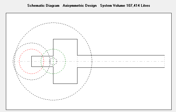

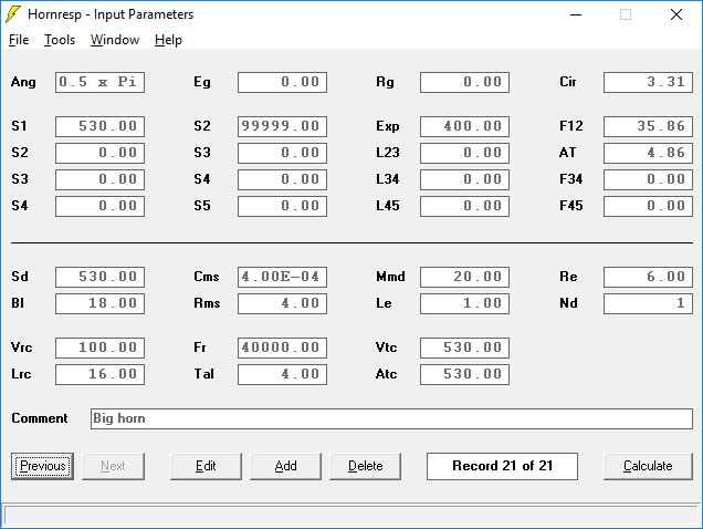

I would like to model a bass horn driver without seeing the effects of the limited horn mouth size if possible.
I tried setting the horn mouth size to 99,999 and length appropriate as in the attachment below, but there is still significant ripple that would hide the effects of the driver ripple. I would like a way to isolate the driver ripple.
*****EDIT*****
I found out that setting Ang to zero, and Exp to 1000 or higher allows me to model just the effect of the driver.
Thanks, Jim
*****EDIT*****
Thanks, Jim

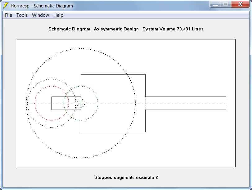

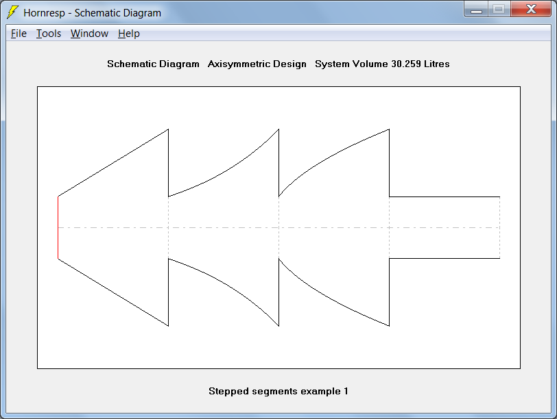

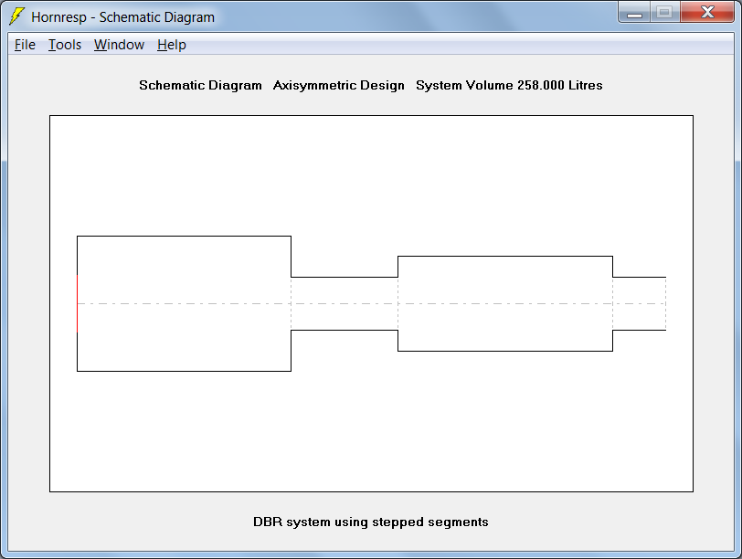

Double-clicking on any segment area label in edit mode allows different cross-sectional areas to be specified at the common boundary between two horn segments in a multiple-segment horn. The mouth area of the first segment does not necessarily have to be the same as the throat area of the second segment. This will result in a step transition at the common boundary. All horn segment area labels are shown in red when stepped segments are specified.
When stepped segments are specified it is not possible to use the Loudspeaker or Multiple Entry Horn Wizards, export schematic diagram horn data, print the schematic diagram, export an AkAbak script or open the current record in the Wavefront Simulator. These limitations were imposed to reduce to an acceptable level the amount of work required to implement the change.

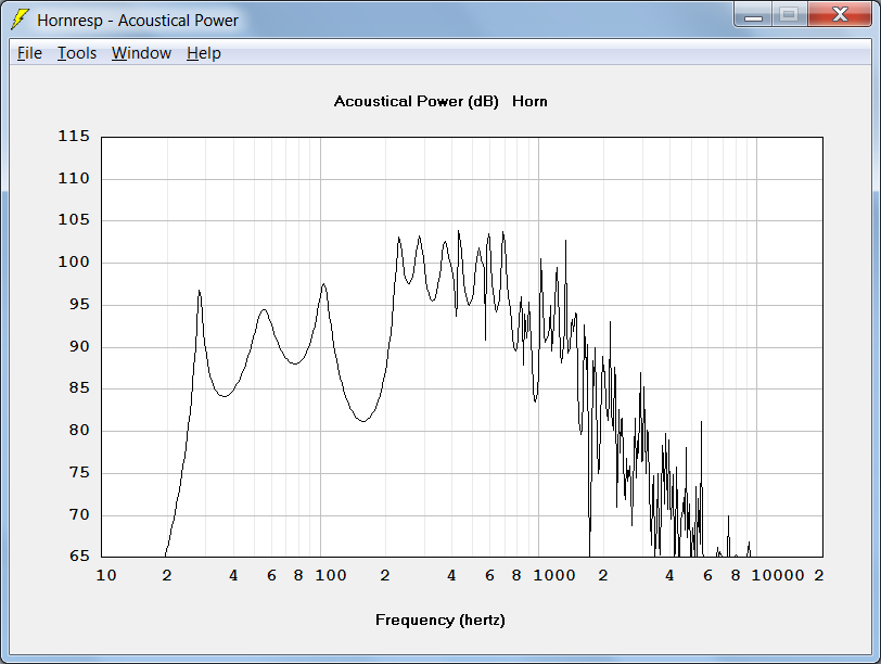

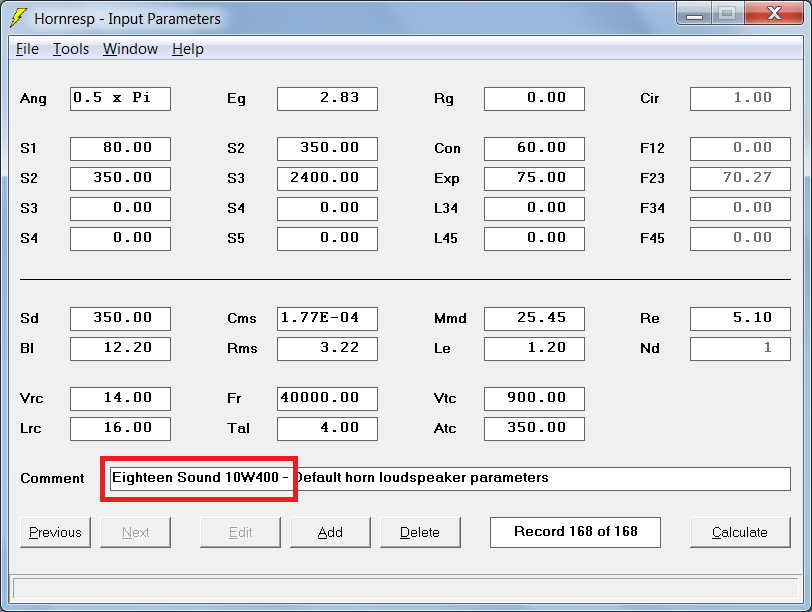

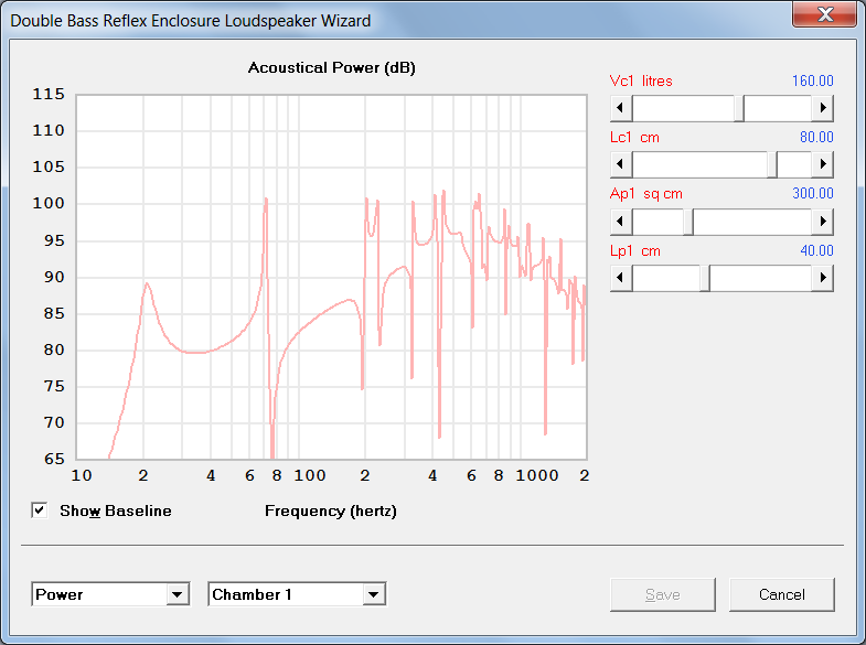

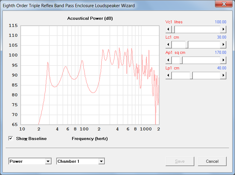

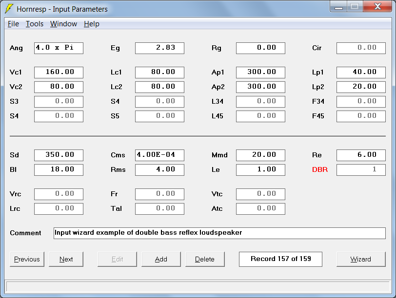

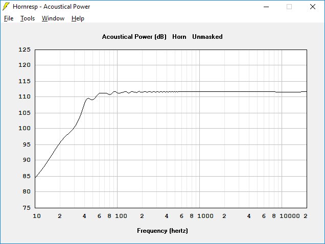

Attachment 1 shows the power response for the double bass reflex system specified in Attachment 3. Attachment 2 shows the power response for the same system, constructed using four stepped segments, as specified in Attachments 4 and 5. The results are slightly different because the DBR Wizard takes port tube end corrections into account, whereas the system using stepped segments does not. Attachments 6 and 7 show other examples of how stepped segments can be used.

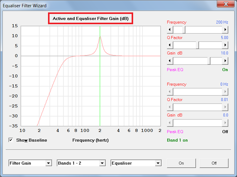

CHANGE 3 - Requested by Erik (epa)
The Filter Wizard now displays combined active and equaliser filter gain, as shown in Attachment 9. While not requested, combined active and equaliser filter phase response and combined active and equaliser filter group delay can now also be displayed.

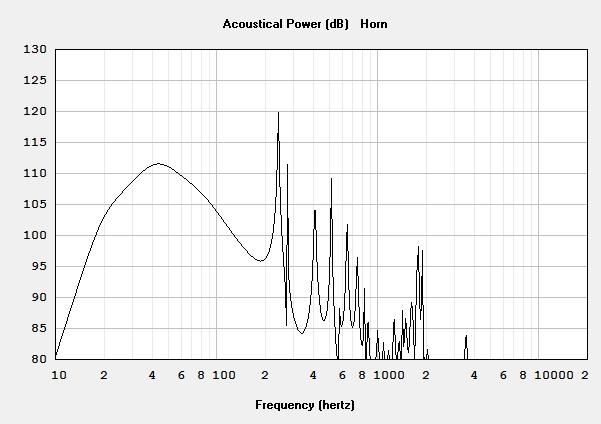

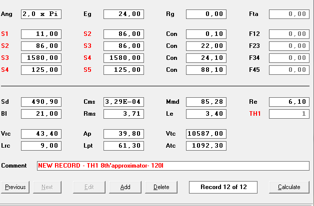

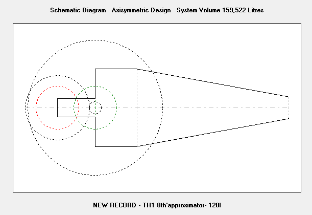

This is a really awesome update and lot of hope for next requests !
Thank you very much David.

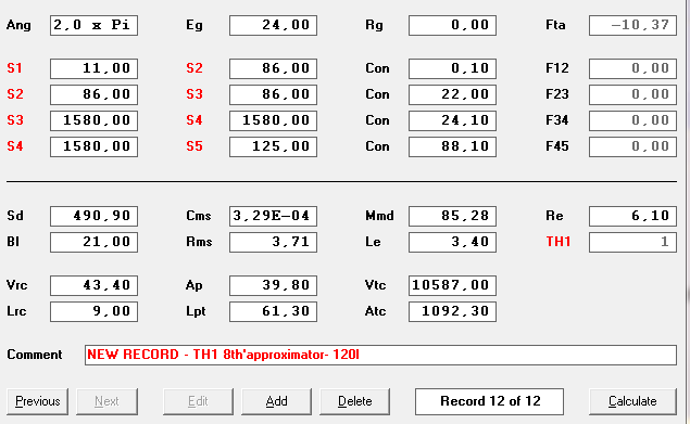

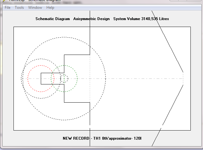

I've played with it for a hour, and it's really interesting.
I didn't managed to reproduce the same result as with 8th order wizard, using stepped segment TH1 with back and front chamber + throat adapter. But I'll try to figure if there's a problem simming with Akabak too when i'll have more time.
EDIT : Bug repport ...I got a non working example bellow with two sim.
Capture 1, 2, 3 are the first sim. Capture 4, 5, 6 are the second sim with only S4 of last segment changed.
The change is taken in account in shematic, but don't change anything to the result. Sorry ...
Last capture is just for fun with this S4 of last segment at 99999,00. It gives the same freq response as the two others sims ^^

Just to help about itBug repport ...
It seems to only happens with TH/TH1 arrangement.
Changes in left column of S2/S3/S4 areas aren't taken in account in calcul for TH/TH1 arrangements , even if shown right in schematic.
Damien
Hi Damien,
Many thanks for the prompt feedback. I have found the problem - the only trick now, is to work out how to get around it 🙂.
I will keep you posted on progress.
Hi Damien,
Due to the bug you found the TH1 stepped segment results are not correct. Could you please post the input parameters for your 8th order wizard example and those for your equivalent TH1 model, so that I can do a "sanity check" and compare the two after the bug is hopefully cleared. The error you show in the schematic diagram (exceeding the boundary limits) will also be fixed.
Kind regards,
David

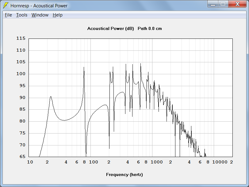

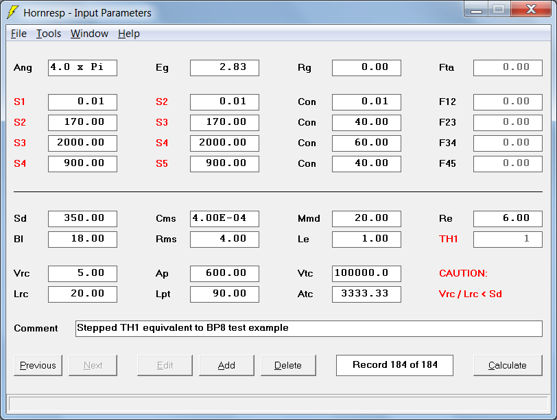

Hi Damien,
No need for you to provide the test examples - I have come up with my own 🙂.
As for my earlier DBR test, the results are slightly different due to the BP8 Wizard taking port tube end corrections into account, whereas the TH1 model does not. If the end corrections are removed, as I have done for my comparison test, the results become identical, which is very reassuring indeed. It means that the BP8 and stepped TH1 models, which are coded quite differently, must both be working correctly 🙂.
