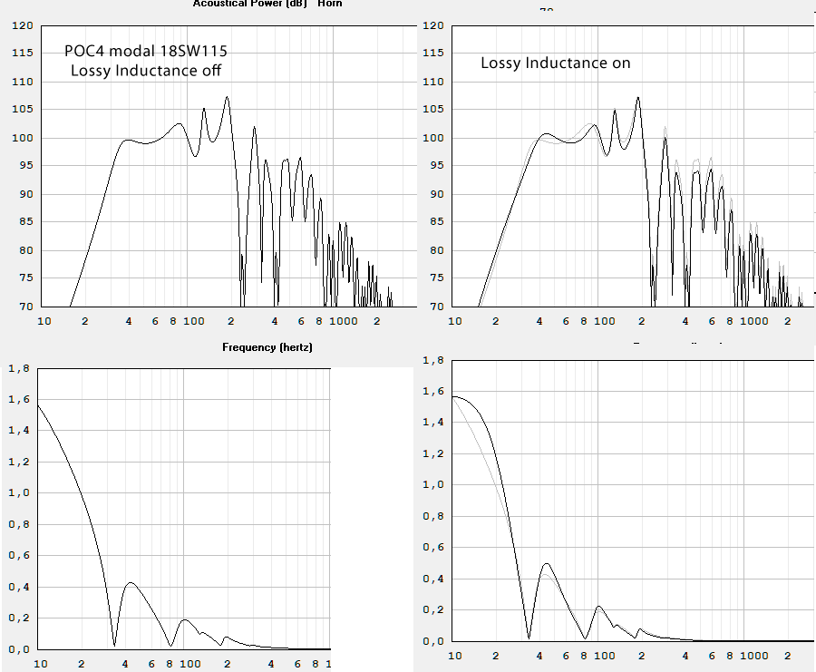

Does anyone know why xmax goes up a few mm if you enable LE, without changing any other setting?
More information required.
What do you mean by "enable LE"?
By "xmax" are you referring to the maximum displacement seen on the diaphragm displacement chart?
(The value of the 'Xmax' parameter is specified by the driver manufacturer - that will not change).
An example showing the effect you refer to would be helpful.

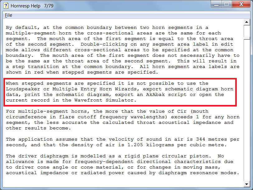

maybe its lack of sleep - but can't invoke the loudspeaker wizard to check fill effects, etc.

Notice S1, etc., is in red, so double click on any one of them to make them black and the LW magically returns. Now all I gotta do is find out why it's an option and if it's new or not.
GM
edit: If it's in the HELP files I missed it. 🙁

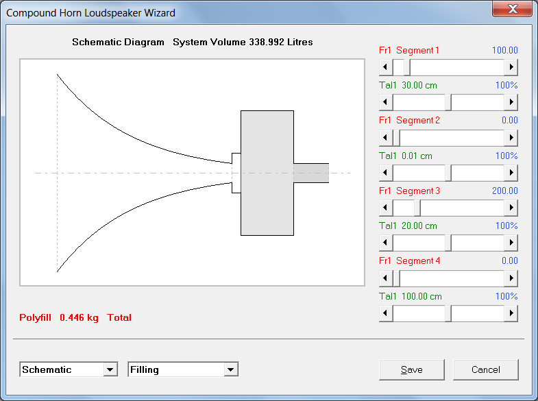

but when having a front loaded horn with a rear vented chamber it's not possible to put filling.
Hi Florent,
Model the front loaded horn with rear vented chamber as a compound horn. Filling material can then be added to the chamber (segment 1) and/or port tube (segment 3) as shown in the attachment. The horn itself will be limited to a single Con, Exp or Par flare.

BIG thanks GM - saw the glaring change 😀 to red - but didn't think to click on it - what wonders might option allow ? ?

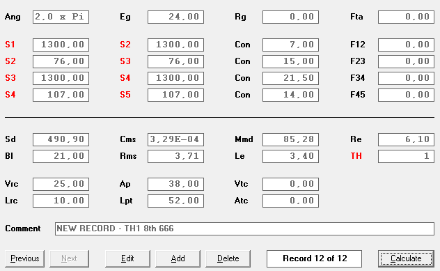

David, if you manage it, do you think stuffing feature should be working in this case ?[...]
Incidentally, once I clear all the bugs, I want to get back to further investigating the possibility of modifying the Loudspeaker Wizard to accept stepped cylindrical horn segments only. I think that this should be a lot easier to do than having to also allow for Con, Exp and Par flare stepped segments.

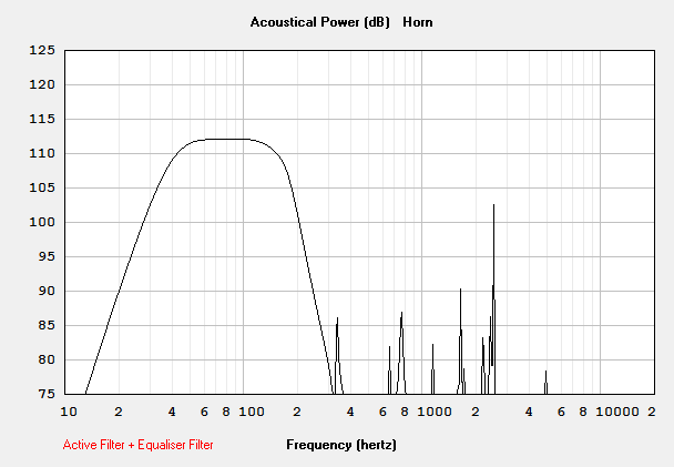

My BP8 simed as stepped segment TH bellow. Vent sizes were decided with BP8 wizard vent velocity screens. Active filtering is just a low pass at 5hz and a -7db eq @6hz, as over-excursion protection. It seems really doable. Filtering of the 53cm long vent spike @350hz seems optimistic beeing so near the mouth.

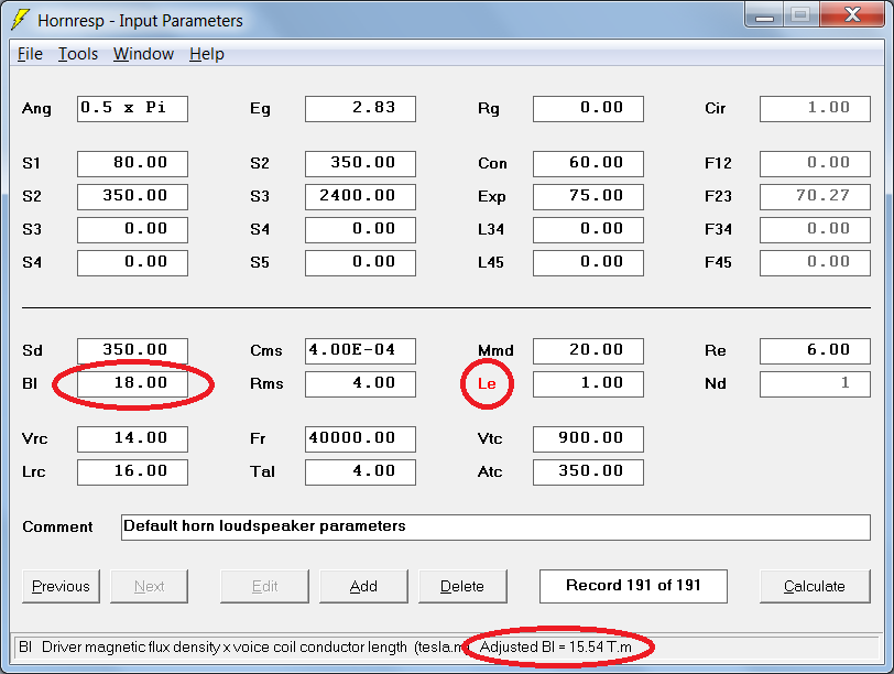

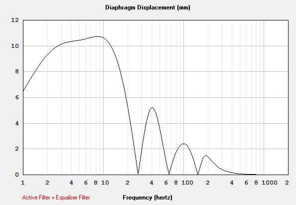

I know enabling Le is for better measure high BL drivers but i did not expect Le would have such high impact on the xmax. I also wonder what frequencies the Le is applied too is this full scale or just one or two ranges.
Here is an example of high xmax Le off/on on the POC4 2.83v 8 Ohm:
It affects ALL drivers to some aspect or another. Some are much worse than others. It also has effects on ALL aspects of performance over the entire frequency range of operation. Driver excursion included.
The lossy inductance empirical model was originally developed by 'just a guy' using driver performance data provided mainly by Josh. The model reduces the value of Bl used in the Hornresp calculations, based on the specified values of Le and Re. With the Lossy Le option selected, the adjusted Bl value used by the program can be seen in the status bar panel at the bottom of the input parameters window when the mouse pointer is moved over the Bl input box, as shown in the attachment.
