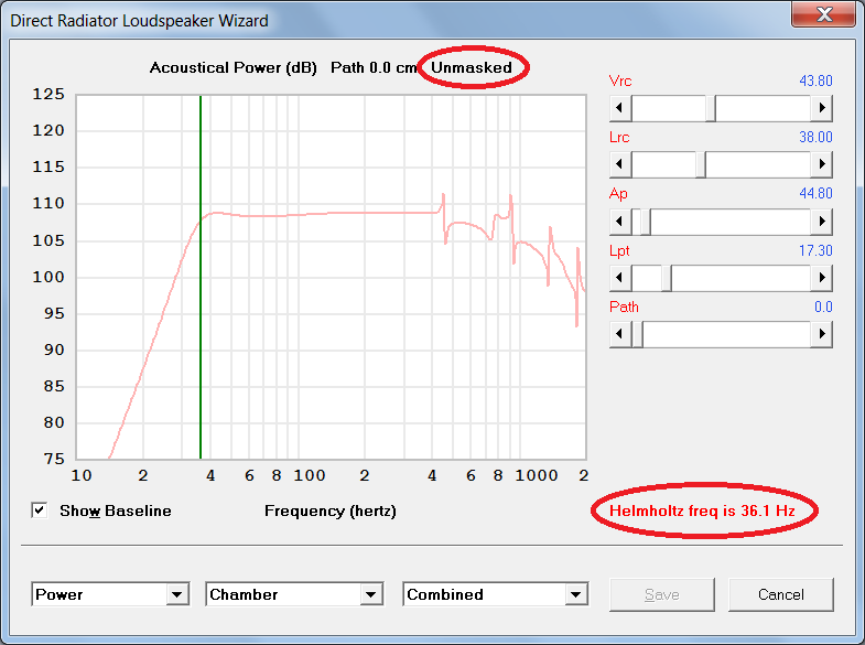

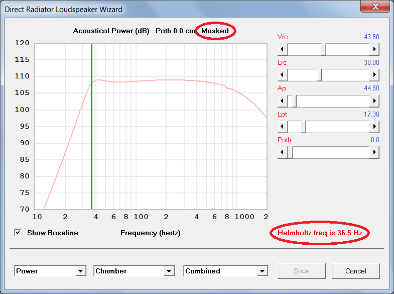

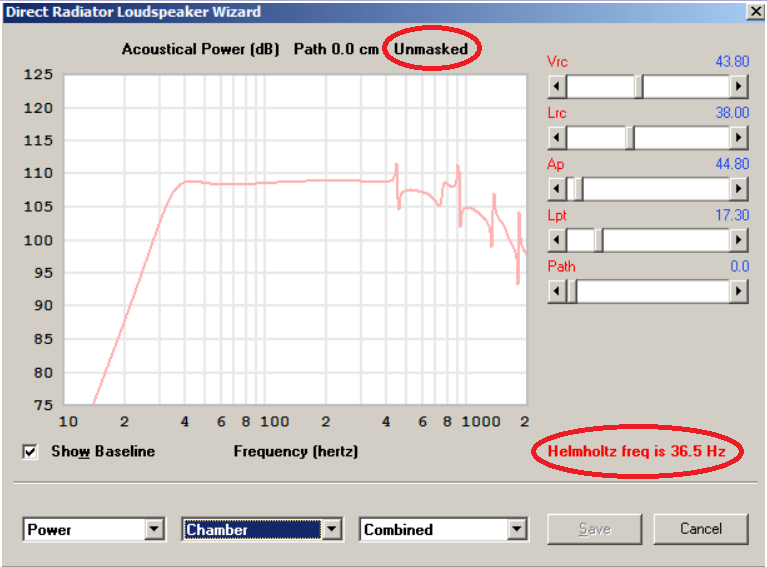

looks like you modeled a BR in a different fashion than the wizard.
Hi joetekubi,
I modelled the bass reflex system exactly the same way as you did. If you are using the latest release of Hornresp, then I don't understand how you managed to obtain a different Helmholtz frequency to me. For resonances unmasked, the calculated frequency is 36.1 Hz, but your screenprint shows 36.5 Hz, which is the value normally obtained with resonances masked.
Kind regards,
David

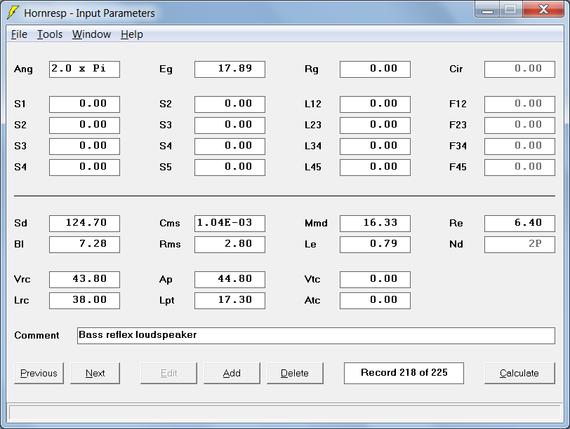

Hey David and Team.
A few humble questions from a dude without a clue.... running the latest version 49.1
1. Can we view multiple simultaneously windows in any way?
2. Is it worth having a few more section labels on the input screen....
eg... 'Driver Input' Section label
eg... "Start of Section Area" column label, "End of Section Area" column label
3. A .JPG 'Screen Capture' button on every window.

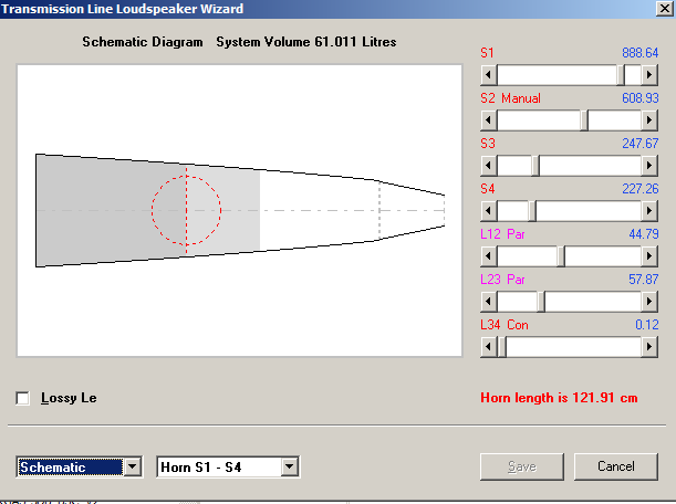

4. And just to make it really hard, a slider on the 'Schematic Diagram' page to move the driver OD and show the effects live in the 'Acoustic Power' window
5. Yes I ask too much, sorry in advance, it's a disease!

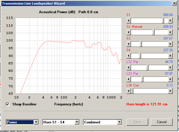

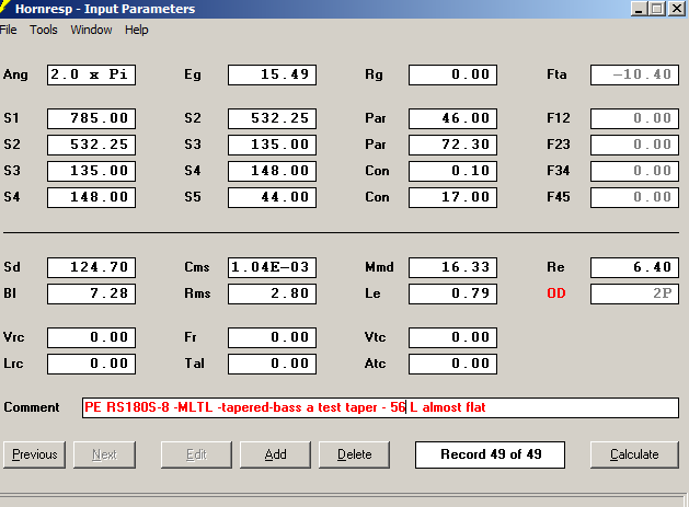

2X RS180 in bass bin TL with HornResp sim
David and GM -
Thanks for your help and encouragement!
I understand how the TL output harmonics interacts with the direct radiator output and produces the spikes and nulls at harmonics of the tuning.
I couldn't understand why a BR model would produce a nice flat output to 35Hz, but a TL with a different CSA and longer length would roll off 10 dB between 100 and 35 Hz. I did not manage to resolve "why", but I started with a large CSA and line length and kept modding into a tapered TL. Suddenly (ain't it always the case) I started getting results pretty close to what I wanted.
David and GM -
Understood, I'm not nearly as 'thin skinned' as some on the various forums, just Dave's response made it clear to me that 'we' were having a 'failure to communicate' and it's also obvious that if you play with the LW enough you'll probably eventually 'slide' your way into something that looks worthwhile building or copy one for a different driver, but if not or don't want to take the time, me or someone else will post one for you.
If you're interested enough to learn the fundamentals of acoustics and how to use them to design all manner of speaker alignments, then recommend immersing yourself in MJK's DIY oriented collected works complete with a yahoo HELP forum and of course here at DIYaudio also: quarter-wave.com
So, which way you want to go forward?

Hi joetekubi,
Kind regards,
David
Thanks for the update - guess I missed the "mask resonance" button when I ran the BR wizard. Frankly, not a big concern for me in that model. I just ran it to confirm the results I got from Unibox for a BR alignment.
Hi Dean,
Unfortunately no, and it would require too much work to now re-write the program to allow for that to happen.
A deliberate effort was made to keep all windows and forms in Hornresp as clean and as uncluttered as possible - I like things to be neat and tidy. I would prefer not to include any non-essential labels at this stage.
The following information is already provided:
The Input Parameters Window section of the Help file has the input box descriptions grouped as follows:
* Radiation, Amplifier and Mouth Parameters
* Horn Parameters
* Driver Parameters
* Chamber Parameters
Also, moving the mouse pointer over any input box or label displays a context-sensitive explanatory note in the status bar panel at the bottom of the window.
I consider the above explanation measures to be sufficient.
To capture a form, press the [Alt]+[Prt Scr] keys when the form has the focus.
You need to use the Loudspeaker Wizard to do that.
As mentioned above, moving the mouse pointer over any input box or label displays a context-sensitive explanatory note in the status bar panel at the bottom of the window. I consider this to achieve the same result as time-delayed pop-up tags, but with less intrusion / distraction.
Kind regards,
David

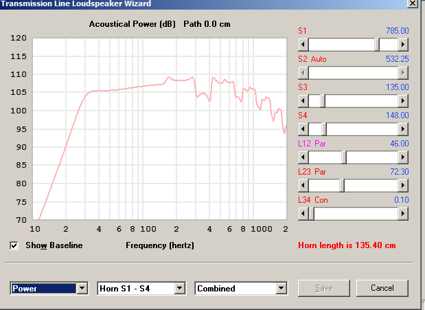

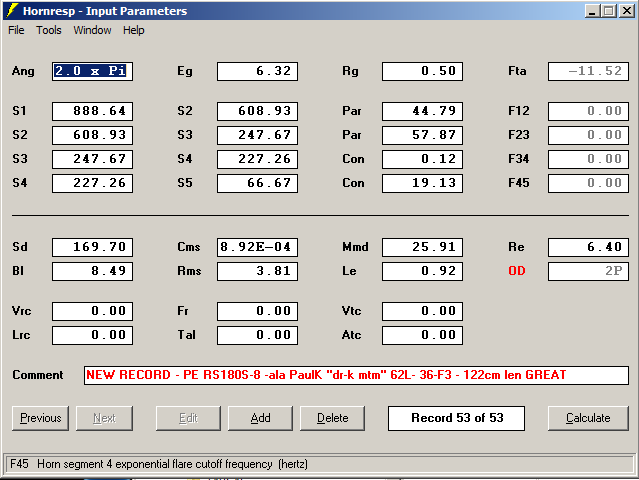

RS180 TL bass progress
I finally got response to be pretty close to what I need.
The only real problem is the notch about 325-400, but I'm planning on low passing the unit at about 250-300, so that should not be a problem.
Thank you David McBean for a great piece of software!
