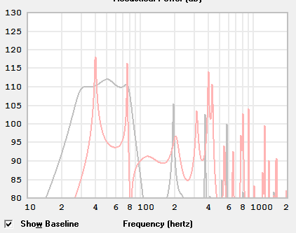

the responses are very similar up to about 1000 hertz
On closer inspection - they are similar up to about 800 hertz.
VERDICT - It seems that you can use either model, but my original "gut feeling" bass reflex choice gives a slightly nicer-looking response at the higher frequencies 🙂
The models have different net volumes. The TH model is likely more accurate in this case.

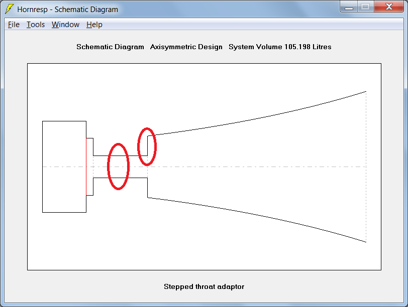

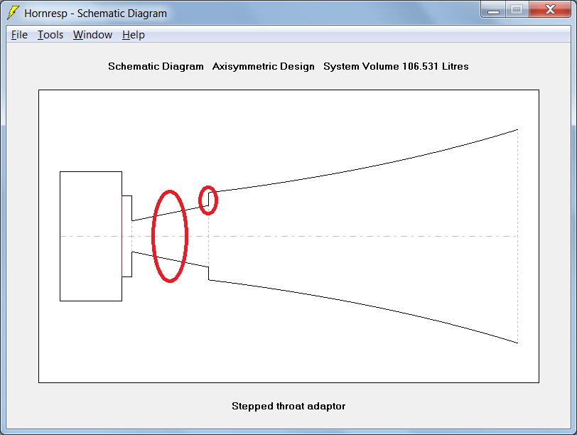

Since stepped segment is alredy implemented... ^^
Should it be possible to make AP1 stepped too , from front chamber enclosure to it next jonction ?
So it would be possible to do as second picture, whereas actually it does as first one.
(However it should be called ^^ )
THANKS !
damien
THANKS !
damien
TH FTW! BR's and TH's require 7 boards minimum. Would you rather your 7th board create a port or a HORN???
Hi Brian,
Just to clarify - are you saying that the tapped horn model, which predicts a more "ragged" upper frequency response, is likely to be more accurate because the volume (31 litres) is less than that of the modified bass reflex model (39.5 litres), or because you consider the actual Pioneer loudspeaker to operate more as a tapped horn than as a bass reflex system?
(The difference in volume is due to the addition of segment 4 (8.5 litres) in the modified bass reflex system, to provide the appropriate loading on the direct radiator).
Kind regards,
David
Hi Damien,
Assuming it can be done, the "stepped" throat adaptor could only be cylindrical, as shown in Attachment 1. It could not be flared as shown in Attachment 2. Would this be sufficient?
Kind regards,
David
Hi David,Hi Damien,
Kind regards,
David
I was thinking about using a round PVC pipe as a throat adapter just the other day to ensure even loading of the driver.
Hi Damien,
Kind regards,
David
It would be really awesome, allowing to get another segment !
Thanks !
The way both sims are laid out, it looks like the net volume of the TH sim will be closer to the actual net volume than the net volume of the BR sim.

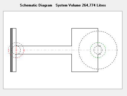

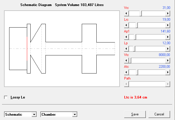

Lol...yes, but more in the way of a port, using stepped segment as in post 5741478 figure 2 : back + front chamber + AP1 + 4 stepped segment = 7 segments. Ok it's a closed back example, but it should work with TH (as i suspect you may want to). And those special extra segment from use of back/front/port near the speaker, cannot be stuffed, the way it is now 🙄Did someone say "another segment" ?
And speaker keep in TH connected to S2 and not S1 so L12 is a intermediate chamber that can be stuffed and tuned when using back/front chambers/port. It's a really interesting feature.
Interesting! Can you show us an example of a 7 segment TH input and diagram screens?
Not really a TH since segments are stepped to increase bandpass effect. Red is with L12=0 to show massive effect of this small intermediate damping chamber. Something called sometime "stub" ^^
EDIT : Found ! In fact, i already played around this here en 2015 :
4 octave Tapped Horn Variant (hornresp sim in ^^)
Thanks for the clarification.
