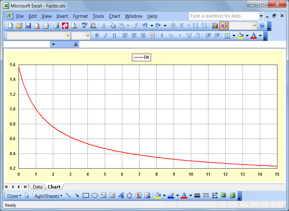

The limit as T->1 is 1. It is also valid for T>1, where both the numerator and denominator are complex, but the result is real.
...as shown in the attached chart, which plots Bjørn's Hypex correction factor Dh from T = 0 to T = 15.

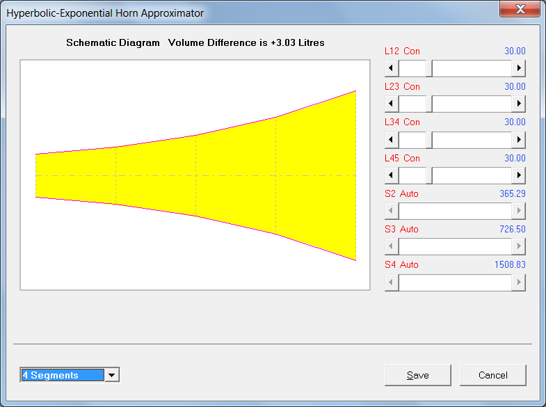

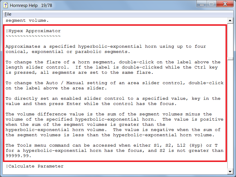

I am modeling an single segment exponential horn. Can find the menu for conversion of single segment horn into multiple segment horn.
Specify your single-segment exponential (Exp) horn as an equivalent hyperbolic-exponential (Hyp) horn with T = 1, then use the Hypex Approximator tool.

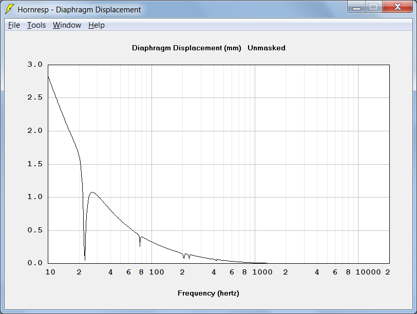

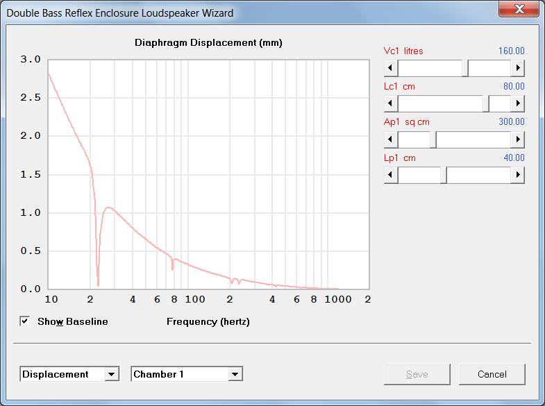

Hi freddi,
Many thanks for this excellent feedback! You are not "being an idiot" - far from it :). Hornresp simply should not do such things under any circumstances - there is something wrong somewhere.
It seems that you have identified two issues; firstly, that the diaphragm displacement is not what we would expect to see from a DBR system, and secondly, that it is possible to crash the wizard as you have shown. I have tried to replicate the problem you experienced, but so far without success. Would it be possible to provide details of the sequence of events that leads to the blank input drop-down list box being displayed? If I can generate the problem myself, then with a bit of luck I should be able to track down the cause and fix things.
Thanks and kind regards,
David
Further to my message above...
Try as I might, I still have not been able to replicate the problem experienced by freddi. On examining the relevant source code carefully, I cannot see how it could possibly crash the Wizard in the way shown. In the absence of any further feedback I suspect that freddi may have experience a momentary glitch with his computer that did not allow the Hornresp screen to refresh as it should.
With regard to the diaphragm displacement issue, I have now checked that the result produced by the Wizard (see Attachment 1) is indeed valid, by comparing it to the one produced when the same double bass reflex system is specified independently of the Wizard (see Attachments 2 and 3). A completely different model is used in this case, but the displacement results remain the same, as anticipated.
At this stage, I intend taking no further action on either matter, unless of course someone can provide me with a sequence of events that generates the problems experienced by freddi.
