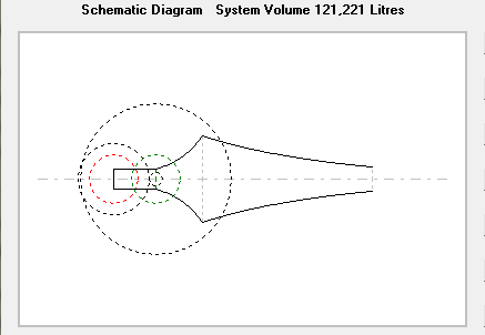

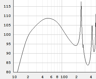

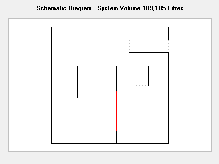

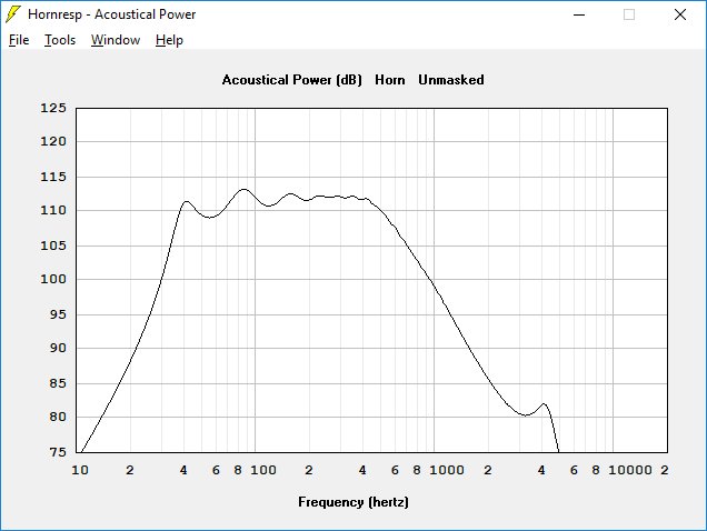

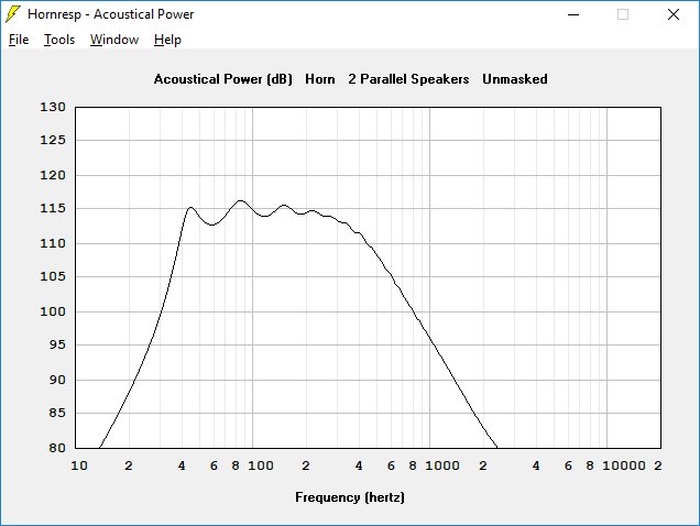

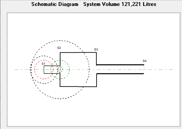

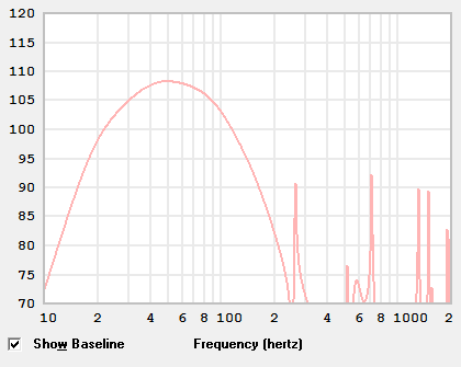

Dear David, would it be possible to add two really simple new kind of segment, with immediat transition from segment X to segment X+1, and one with no transition until X+1 reached ? In fact, it would allow to use segments as chambers. For exemple to simulate 8th order with TH tool instead of cheating like this :
Picture 1 and 2 show the use of 8th wizard (wish allow to tweak duct velocity). Picture 3 and 4 show i cheat with TH wizard to get something +/- near to get a idea of phase of the 8th by trying to get the same response with the same idea.
Picture 5 show a totally fictive example of what can be expected : segments transitions S1-S2 and S3-S4 are what i'm talking about.
If i recall well, it's maybe my third attempt to ask for a new segment without asking a new segment ^^
Maybe a way to do it should be a option that allow to sacrifice PAR/EXP segment curves in exchange of those one. So that in the code, it need only to replace PAR/EXP curve code for those simplier "chamber segment" transitions code....So that maybe less work is involved ? So that there is a chance it happen ?

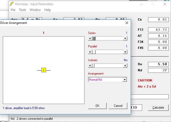

Hi David,
I *may* have found a bug in HR. Please see the attachment.
I was modeling a dual cone folded horn, and double-clicked on the Nd text box, only to have the popup show that only one diaphragm was selected. I wanted to change the parallel connection to series and see what happens to the SPL graph.
It might just be a newbie mistake by me (blush). 🙂
Hi Damien,
Some time ago I looked into the possibility of trying to do what you suggest. Unfortunately, the way that Hornresp has evolved, it would now require a massive amount of work to implement, as the proposed changes would impact on almost all areas of the program.
Currently, everything is based on the assumption that the mouth area of one horn segment is equal to the throat area of the following segment - except in the case of a compound horn system, where segment 4 (shown as S5-S6 rather than S4-S5) is used to specify the second horn. Very large sections of the Hornresp code would have to be completely re-written to accommodate the new feature.
In other words, "it's not going to happen". Sorry... 🙂.
Hi Jim,
Thanks for the feedback.
When the Driver Arrangement tool is opened, the default settings are always shown. This was done for two reasons:
1. So that the user can readily see that a single driver is specified by setting both the Series and Parallel sliders to 1. This convention can be confusing to some people, so it was felt best to show it each time, as a reminder.
2. It is usually quicker altering the driver arrangement this way. For example, in your case you wanted to change from 2P to 2S. If, when you opened the tool, the Parallel slider was set to 2, you would have had to reset it to 1 and set the Series slider to 2. The way it works now, it is not necessary to reset the Parallel slider, thus saving a little time and effort 🙂.

It doesn't need to change this asumption to be possible. It should be approximated by a area formula that change brutally at really small threashold of distance after the throat.Hi Damien,
Kind regards,
David
Since it must be formulas in code, i understand that code conditions for threashold can't be used, too much work. I no more have enough mathematical background, but some kind of nulling in formula can be use to make it work. I won't try here to formulate something, i would make it absurdly complex.
Another way to do it, really stupidly, but working would be another version of hornresp, where you search/replace exp/par formula with those chamber formula. A hornresp "chambers mod".
It's far more complicated than that... and it's still not going to happen... 🙂.
It falls into the same category as the infamous, often-requested, fifth segment - too much work involved!

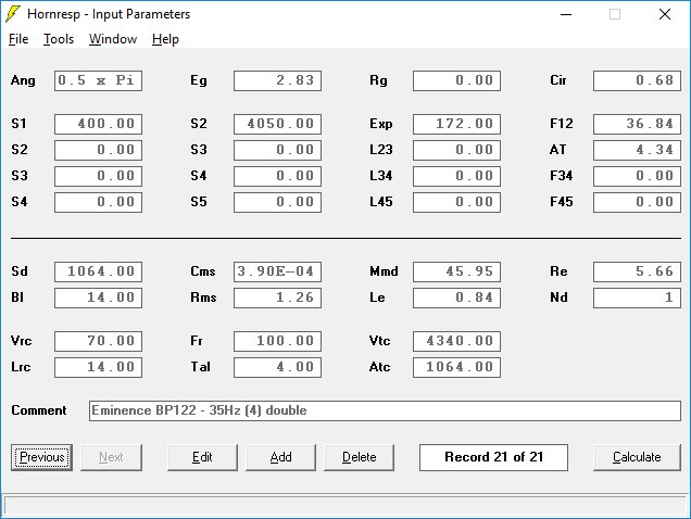

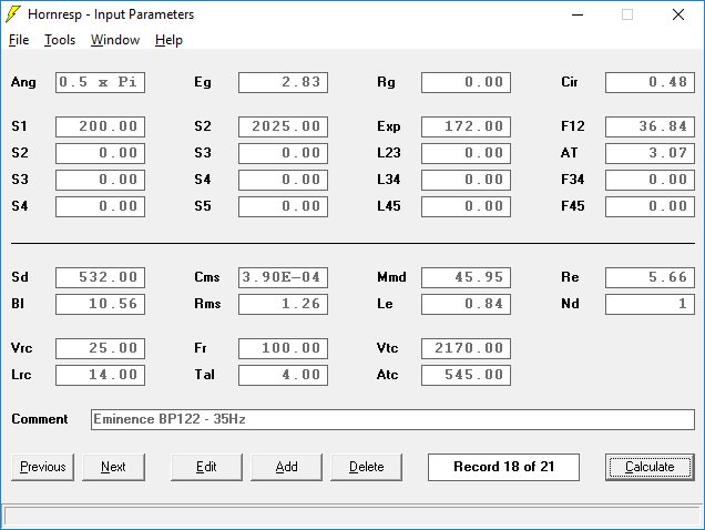

...The other way is to double the areas and volumes of one cabinet (but not the lengths) and specify two drivers...
Hi David,
This first set of data is using the Multiple Speaker tool.
And here is the same data, except the areas are all doubled.
You can clearly see a difference between the two, and that is where I could use your input on what I am doing incorrectly.
Thanks, Jim.
Hi Jim,
Apart from the driver parameter values not being the same, it seems that you have some difficulty in multiplying by two 🙂.
In your second record:
Sd should be 532.00
Bl should be 10.56
Nd should be 2P
Vrc should be 50.00
Atc should be 1090.00
Kind regards,
David
