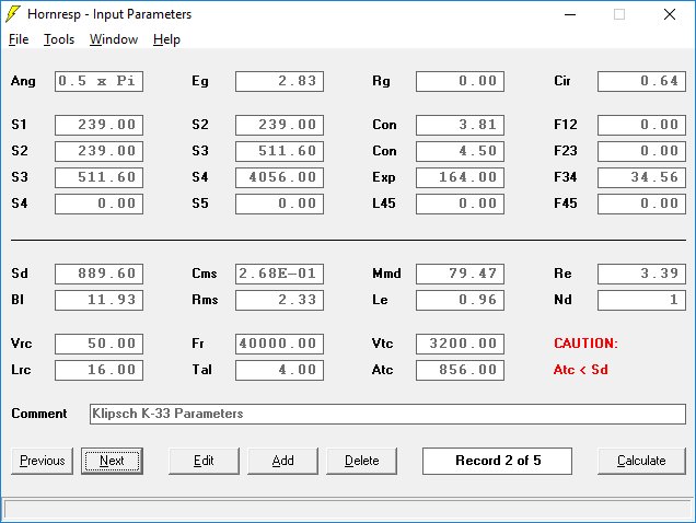

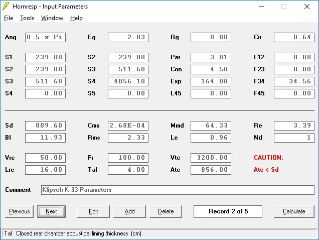

I would like to get input on these Klipsch K-33 TS parameters before proceeding with an analysis of the acoustic path and area of this classic bass horn.
Also, if you have input on how I have modeled the horn portion of the speaker, I would really appreciate input there too.
I used to Con flares in sections one and two, since I could not figure out how to use a Exp flare for the first section. I know David has done this with the default horn in HR, but am relatively new with HR and could use some input.
An attachment is included of the HR parameters.

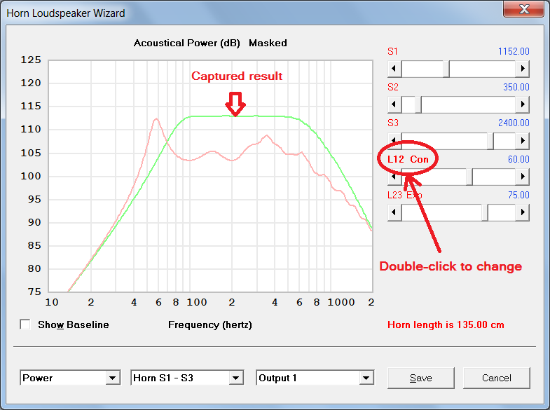

Hi Jim,
As far as your K-33 driver parameter values are concerned, all are correct except for Cms and Mmd.
I am guessing that the Cms value you used was 0.268 mm/newton. Hornresp requires the Cms units to be in metres/newton, which means that the value you need to enter is 2.68E-04, rather than 2.68E-01.
You appear to have have used the Mms value of 79.47 gm for Mmd (Mms = Mmd + airload). To find just the value of Mmd, double-click on the Mmd input box in Edit mode and follow the instructions (assume fs = 34.46 Hz). The value you should get for Mmd is 64.33 gm.
To change a segment from Con to Exp, double-click on the Con label in Edit mode to switch to Exp.
With regard to the horn profile, the initial front (up / down) expansion of a classic Klipschorn has a parabolic flare (originally called a "rubber throat" by Paul Klipsch). The expansion rate of this segment is faster than that of the rest of the horn system. To specify a parabolic segment, double-click the Con label to switch to Exp, then double-click it again to switch to Par.
I know that others have modelled Klipschorns using Hornresp. Perhaps a Google search could be worthwhile?

Hi David,
First of all thanks for the response and help with the Klipsch TS parameters for the K-33 woofer.
As mentioned previously, while I am familiar with Thiele-Small parameters, I have never really used them to model a loudspeaker, so your help is really appreciated.
I did do a search for others who have done Klipsch modeling, but am not sure who was the source of some of the data that was found. It was not clear to me if the data came from a post at DIYaudio.
The TS parameters that you suggested have been revised and an updated screen shot attached below.

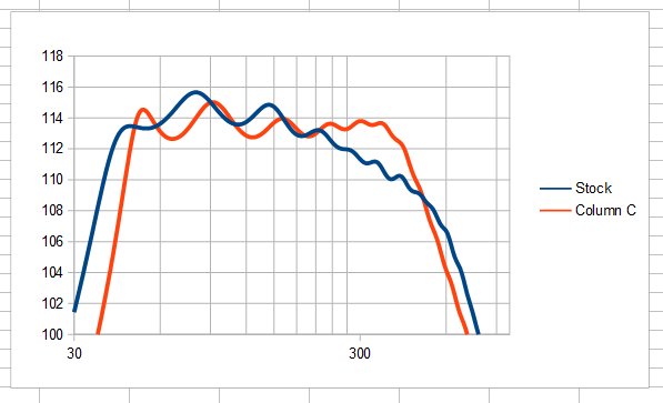

The reason that I would like to export just the Horn and TS parameters that create a certain SPL chart, is similar to the attached chart.
I am trying various flare rates, be it conical, exponential and so on to maximize the acoustic performance of a corner horn similar to the Klipsch. When trying to determine if one design is slightly better than another, I like to graph multiple graphs on top of each other as in the sample shown.
Another approach that I have used in the past, is to select a "control" graph and then compare (normalize) other graphs to the control by calculating the difference between the two curves and plotting the difference graphs. This allows me see differences less than let's say 10% much easier.
Putting all this information into a spreadsheet is a nice way to do this.

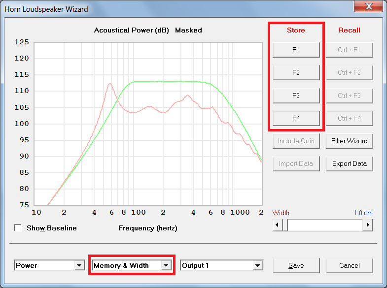

Hi Jim,
Electro-mechanical parameters were exported, not TS parameters 🙂.
I think that you might be making things unnecessarily difficult for yourself 🙂. Why not just use the Loudspeaker Wizard, enabling you observe the effects of any changes in real time? Press Ctrl+C when the power response chart is displayed to capture the current results. Press Ctrl+V to show or hide previously captured results. To change the flare of a horn segment, double-click on the label above the length slider control. Up to four sets of system values can be temporarily stored and recalled while the wizard is open by clicking the appropriate memory button or pressing the equivalent function key. The reference baseline can also be reset if desired.
If you haven't already done so, I suggest that you have a close look at the Loudspeaker Wizard section in the Help file. When used to its full potential, the Loudspeaker Wizard can be an extremely powerful and useful tool.
Once again, you are perhaps making things a little difficult for yourself 🙂. Try using File > Export > Hornresp Record to export the data for an individual record (see default record example attached). The information contained in the Filter section at the bottom of the file gets complicated - it is a combination of filter component values and context-sensitive status flags, and varies depending upon the filter types saved to the permanent record.

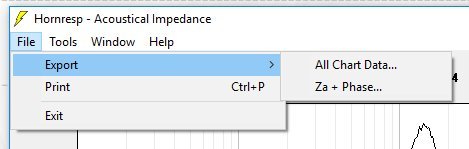

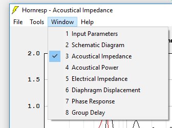

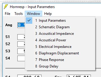

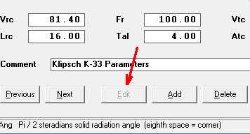

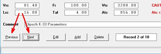

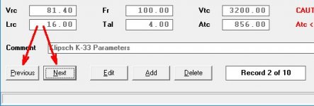

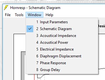

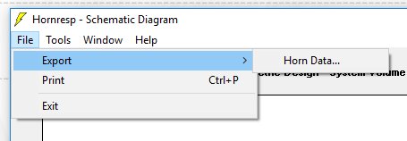

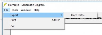

As many of the users of Hornresp already know, this program has an amazing array of options and functionality. I will be the first to admit that I am a rookie with the program, and am willing to help others learn the program as well, where I can. This is the first, of hopefully many, documented help topics.
Exporting Parameters/Data:
Use the Previous or Next button to select a particular record.
Click the Edit button.
Click the Calculate button.
Now select one of the eight items listed below.
If Input Parameters was selected, then the Export options below are available.
Select Schematic Diagram.
Now Horn Data can be exported.
Select Acoustical Impedance.
Now All Chart Data can be exported.
One will notice a pattern between the Window dropdown and the related Export dropdowns available.
Jim.

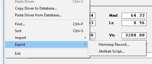

.... Try using File > Export > Hornresp Record to export the data for an individual record (see default record example attached). The information contained in the Filter section at the bottom of the file gets complicated - it is a combination of filter component values and context-sensitive status flags, and varies depending upon the filter types saved to the permanent record.
Kind regards,
David
Hi David,
After your nice elaboration on File > Export > Hornresp Record, I finally understood that based on the parameter selected in Window, a corresponding export function is available.
To this end, I made a new thread for documenting the HR help file with graphics, to hopefully make it easier to follow. I posted a PDF file to that thread. The plan is to add to that PDF with more help information as I or others use the HR program.
Jim.

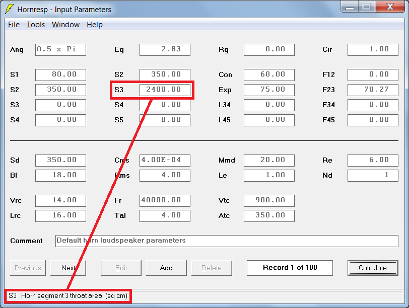

Hornresp Update 4860-190125
Hi Everyone,
CHANGE
The single-segment horn second-harmonic distortion model has been refined. The posts linked below refer.
https://www.diyaudio.com/forums/sub...ass-horn-design-question-121.html#post5656441
https://www.diyaudio.com/forums/subwoofers/119854-hornresp-902.html#post5658737
BUG FIX
Moving the mouse pointer over the segment 2 mouth area input box S3 displayed the status bar message for the segment 3 throat area input box S3, as shown in the attached screenprint. This has now been fixed.

May I ask for a feature?
In the directivity tool can there be a memory and display of say 6 or 8 calculations? It would allow for a comparison between calculation and measurement. Also allow a designer to pre-calculate response for a horn on or off axis.
I'm guessing that the memory could also be applied in the directivity pattern window as well.
