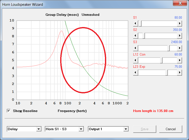

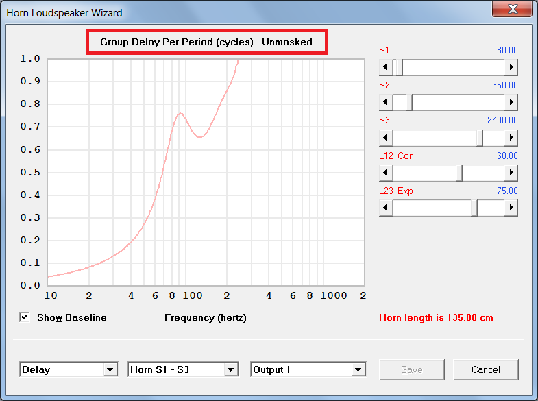

For me it still works here, in wizard's delay chart.Hmm, I'm thoroughly confused.........just installed 190101 and double clicking in 'group delay' pops up the 'sample' window, one click pops up the red line that displays frequency and delay and no amount of clicking anywhere gets me a green line or period chart.
GM
Not in calculated group delay screen, but it wasn't before.
Hi GM,
The functionality applies to the Loudspeaker Wizard only.
Kind regards,
David
Ah! Thanks! Only read what was outlined in red and not too sharp nowadays after an 'all nighter'.

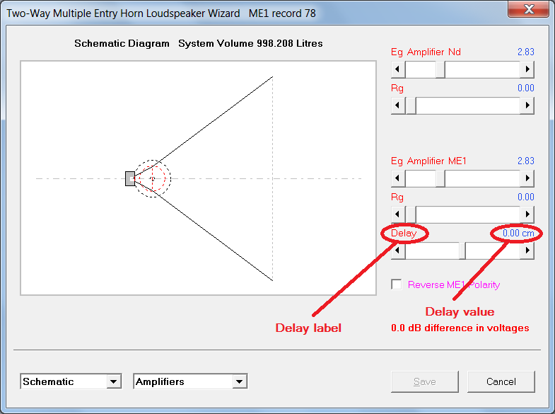

I cannot switch to time delay anymore with delay slider, no matter how many time i double click on "delay"
Hi Damien,
The switch functionality has not changed, only the slider limits.
Double-click the delay label to set the time-aligned delay distance in cm. It is only necessary to double-click the delay label if you want the slider to automatically adjust to the time-aligned distance.
Double-click the delay value to change the delay from distance to the equivalent time. Double-click the delay value again if you want to change the delay from msec back to cm.
The default distance of 12 cm in my previous example becomes 12/344 = 0.35 msec.

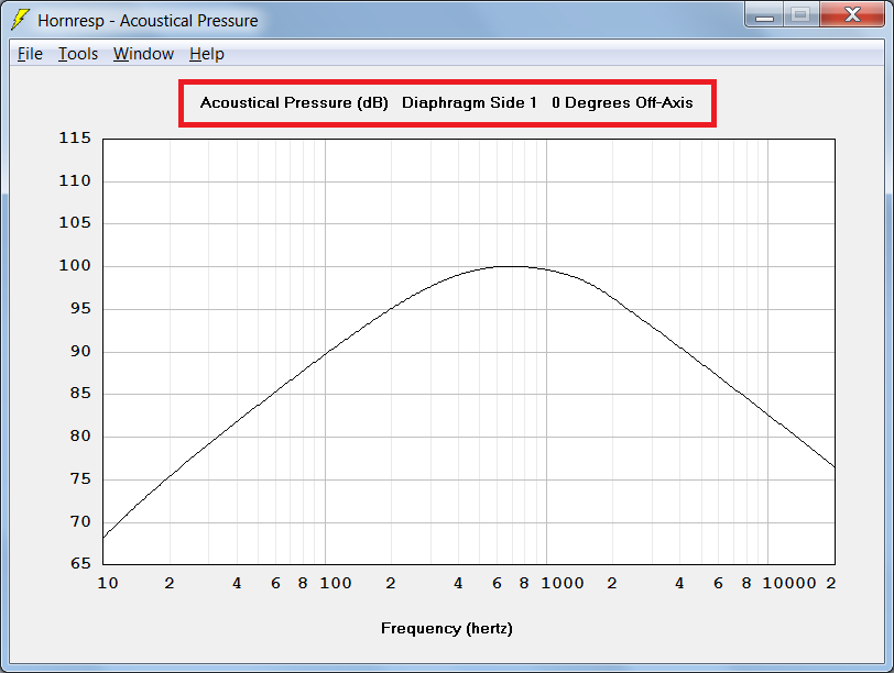

OK question regarding SPL on an open baffle stimulation. Can I generate a directivity response some how. This is greyed out. I can do a power response with normal inputs and calculations. So I'm not that stuck. Just wondering the rational behind the no directivity option.
Hi Mark,
Hornresp cannot generate directivity responses for combined outputs - there are just too many unknowns. For your open baffle example, select Tools > Output > Diaphragm Side 1 (or Diaphragm Side 2) from the Acoustical Power chart window, then select Tools > Directivity > Response.

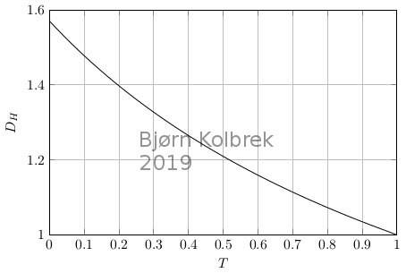

I went through the equations for Hypex horns for the book I'm working on, and a correction factor to the standard distortion equation that is valid for T<1 is
2{arctan((T+1)/R) - arctan(T/R)} / R
where R = sqrt(1-T^2).
This equation is plotted in the attached graph. Distortion for T=0 is about 57% higher than for an exponential horn.

Easy mistake to make, Bill, things look simple when you use the exponential function...
Some further comments to the equation. The limit as T->1 is 1. It is also valid for T>1, where both the numerator and denominator are complex, but the result is real.
As T increases, distortion decreases, but keeping the horn end dimensions and length the same, so does the cutoff frequency, and just looking at the correction factor can be deceiving.
