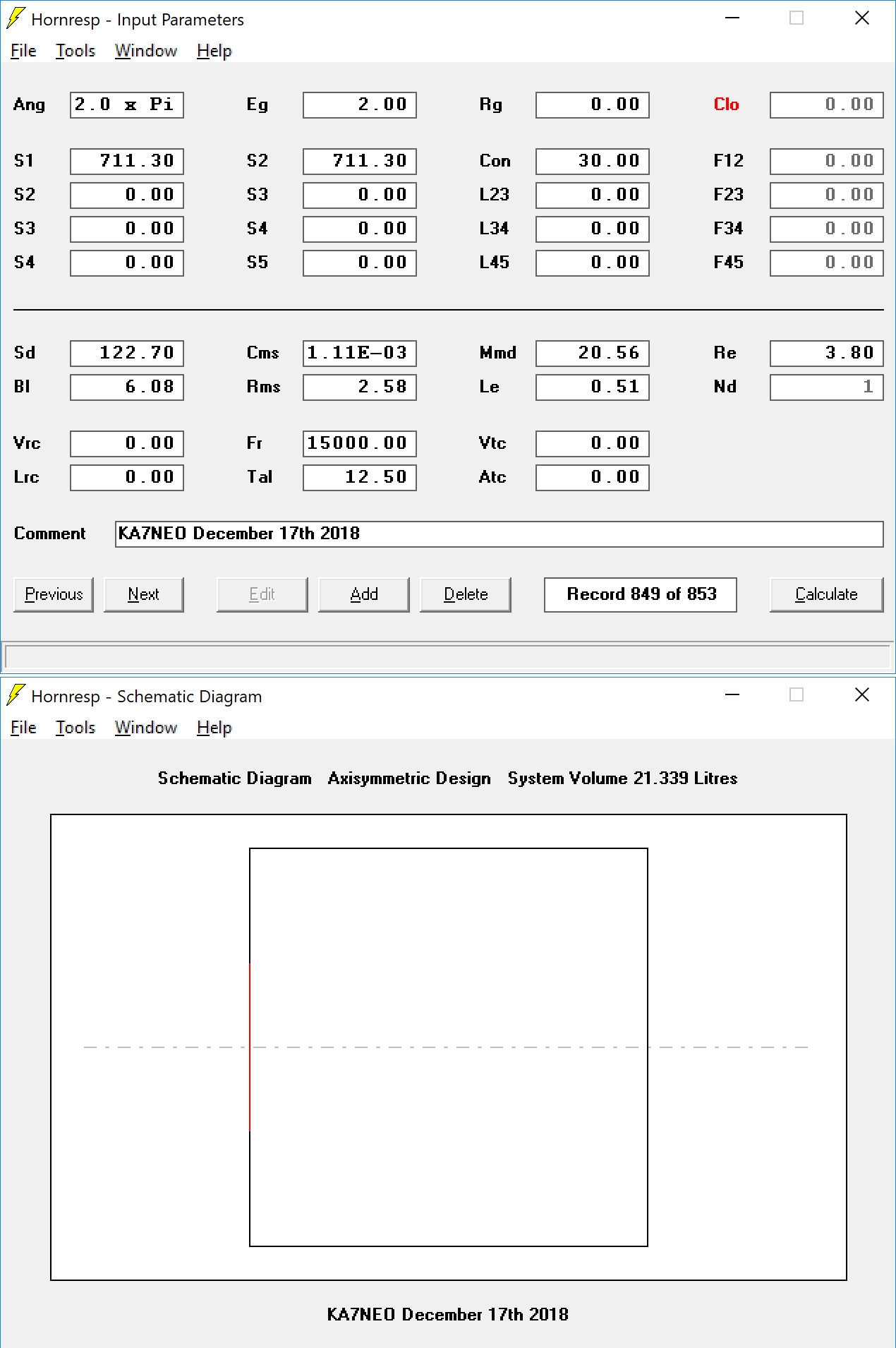

OK I must be down wind of something hallucinogenic. I just ran the same input parameters on a version of Hornresp from a way back in 2013. I keep them all. And I get the same thing as the current version.
Must be confusing the measured parameters with the simulated parameters.
So now this leads me to the next question. I started digging around in scientific paper land to see if anybody else has found discrepancies with fibrous tangle calculations. And low and behold I'm not alone.
So my educated guess at this point is that a lightly compressed complete fill of a cabinet will be a totally different air resistivity than the single thickness measured and reported. It will not be a true doubling of each layer, but something a little bit more difficult to pin down.

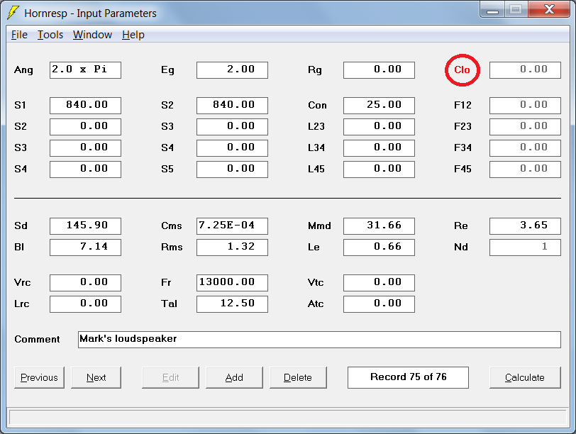

Sand blasted car, well I guess that's one way of getting it done! May have created some frosted glass to. Not so conducive to driving!
The CLO option is pretty much the bees knees for this application. And again I get caught unawares of the potential of this program.
Thanks David!
What am I missing to get the options in the schematic page?
Hi Mark,
The Fr and Tal values specified on the main Input Parameters window apply to rear chamber lining only. When the Clo option is selected, a closed-mouth horn is in effect being specified. It is not possible to also have a rear chamber, because in that case, there would be no sound output from the loudspeaker system. This is why no rear chamber lining is shown in your schematic diagram (there is no rear chamber, only a cylindrical closed-mouth horn). With the Clo option selected, the Fr and Tal values can be set to zero if you like, as they are not used.
Open the loudspeaker wizard to specify the required filling material, which will then be shown in the wizard schematic.

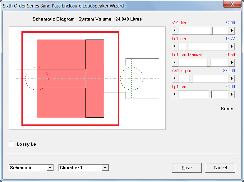

OK learning new tricks.
I can generate the correct filling in the loudspeaker wizard. And generate the lowered impedance in the loudspeaker wizard as you have shown. I cannot import the new filling into Hornresp proper like you would normally by pressing the save button. It is greyed out.
All in all pretty close to the measured results. A few ohms higher, but it always is. I'm guessing that the losses are not accounted for.
The Loudspeaker Wizard Save button is enabled when a slider value is changed. Filling values can be saved to the permanent record, but are only applicable in the Loudspeaker Wizard.

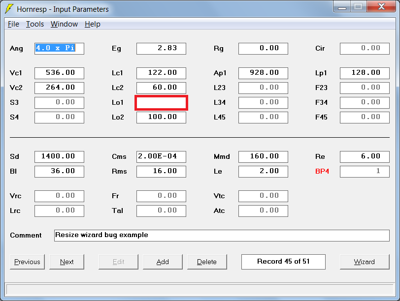

BUG FIX 1
When the Resize Wizard was used with BP4 and BP6 records, a blank field would be inserted in the Lo1 input box, resulting in a fatal "Type mismatch" run-time error, as shown in Attachments 1 and 2.

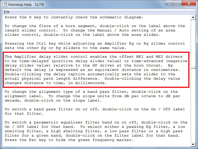

In ME wizard, double clicking on delay to switch from time to distance, or distance to time invariably gives value with unity of 2,12cm.

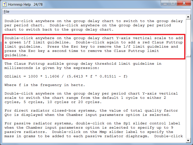

I seem unable to get the 1/f limit guideline or the Claus Futtrup limit
guideline to show on my group delay chart, using version 48.50. Are these still working or m I missing something? I've tried double clicking all over the group delay chart without success.

Hi Damien,
Double-clicking the delay caption automatically sets the slider to the actual physical path length difference.
For example, if the Nd record has Vtc = 10 cm3, Atc = 20 cm2 and L12 = 15 cm, and the ME1 entry point is at L12, then the distance from the Nd driver diaphragm to the 'nodal point' where the Nd and ME1 signals combine will be 10/20 + 15 or 15.5 cm.
If the ME1 record has total Vtc = 200 cm3, total Atc = 400 cm2 and Lp = 3 cm then the distance from the multiple ME1 driver diaphragms to the 'nodal point' where the Nd and ME1 signals combine will be 200/400 + 3 or 3.5 cm.
In this case, double-clicking the ME1 delay caption will set the slider to 12 cm (15.5 cm - 3.5 cm = 12 cm) which is the ME1 delay necessary to have the signals time aligned at the combination point. The slider can then of course be adjusted to a different delay value, if required.
Double-clicking on the delay value itself changes from distance to time in milliseconds.
Hi jamesdb,
Make sure that you double-click the Y-axis vertical scale on the group delay chart, not the group delay per period chart.
Kind regards,
David
Hmm, I'm thoroughly confused.........just installed 190101 and double clicking in 'group delay' pops up the 'sample' window, one click pops up the red line that displays frequency and delay and no amount of clicking anywhere gets me a green line or period chart.
