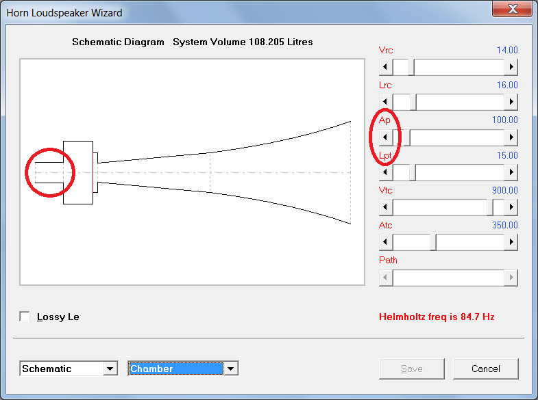

Bug report ?
I don't manage to make vented Chamber 1 and Chamber 2 working in multiple entry wizard, whereas it seems to work for Chamber 3 (ME2). Only Ap/Lpt from ME2 reccord appears and affect curve in ME wizard/and ME2 record.
Other verification :
_Ap/ Lpt from ME1 is not even taken in account in his own ME1 record (even in schematic). Verified inverting ME1 as ME2...Always only ME2 working as vented back chamber.
_Ap/Lpt is taken in account in Nd record when launched as non multiple entry, but no more in multiple entry wizard.

Hi Damien,
Thanks for the feedback.
The following rules apply to the use of Ap and Lpt values specified in Nd, ME1 and ME2 records:
Two-way multiple entry horn system:
Vented rear chamber not applicable to high-frequency Nd driver
Vented rear chamber applicable to low-frequency ME1 drivers
Three-way multiple entry horn system:
Vented rear chamber not applicable to high-frequency Nd driver or mid-frequency ME1 drivers
Vented rear chamber applicable to low-frequency ME2 drivers
In other words, the only rear chamber that can be vented in a multiple entry horn system is that associated with the low-frequency drivers. This functionality is intentional, it is not a bug.

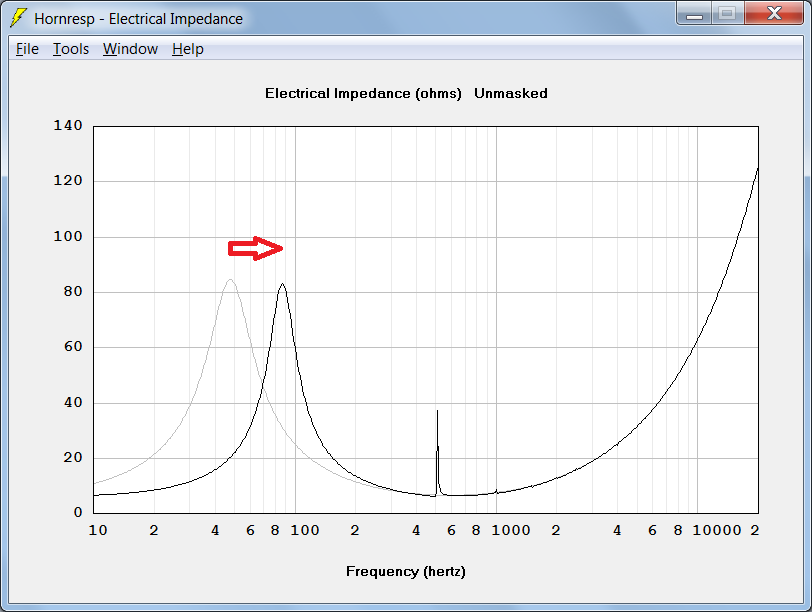

If i do some math can i safely say that when i subtract the driver impedance from the box/driver impedance that the remainder is the impedance of the box itself?
The measured electrical input impedances are different because the acoustical impedance loading the driver diaphragm has changed. Subtracting one electrical impedance value from another does not give you the acoustical impedance loading the rear side of the driver diaphragm. It is a bit like comparing apples and oranges.
The closed box reacts on the rear side of the driver diaphragm. This reaction is represented as an acoustical impedance, which at low frequencies is a compliance operating to stiffen the motion of the diaphragm and raise the resonance frequency as shown in Attachment 1. At high frequencies, the reaction of the box, if unlined, is that of a multiresonant circuit. This is equivalent to an impedance that varies cyclically with frequency from zero to infinity, as shown in Attachment 2.

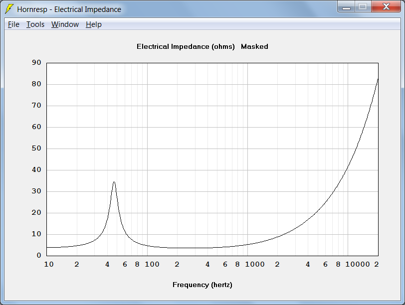

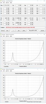

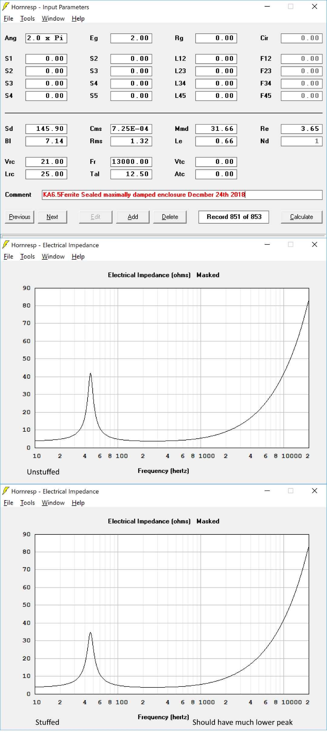

A possible bug?
I did a set of simulations with this driver a few years back. The driver and system is in production and the impedance peak is just north of 10 ohms in real life. It used to simulate pretty close to that to. The enclosure is stuffed to the gills with properly cut and fit rockwool to create a maximally dampened enclosure. When I simulate it now with the same parameters it is not even close to the old simulation.
Hoping you guys are enjoying your holidays!
Hi Mark,

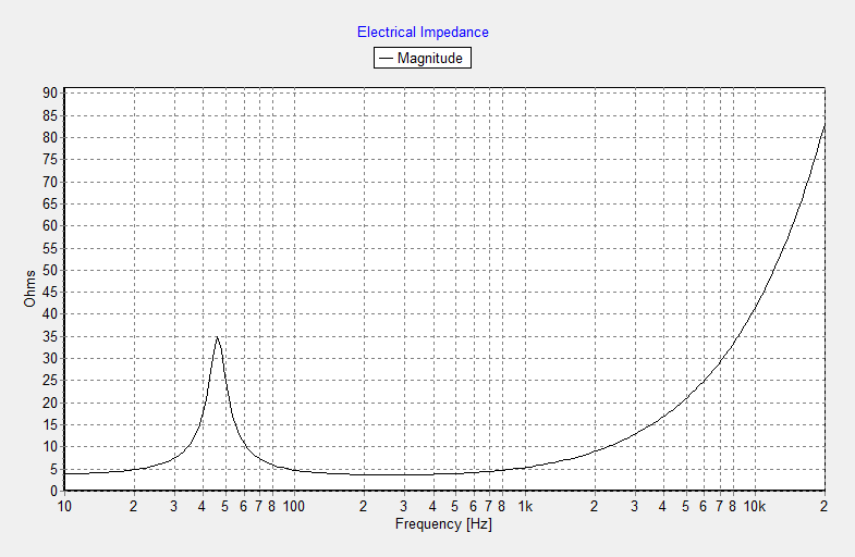

As far as I know, everything is working as it should. Just to confirm, I checked the Hornresp results against those generated using the program developed by Dr Kolbrek for his own use - see attached screenprints (acoustical lining material is included in each case).
I have no idea how you managed to obtain an impedance peak of around 10 ohms in your original Hornresp simulations using the input parameter values you show - it is a real mystery to me... .
