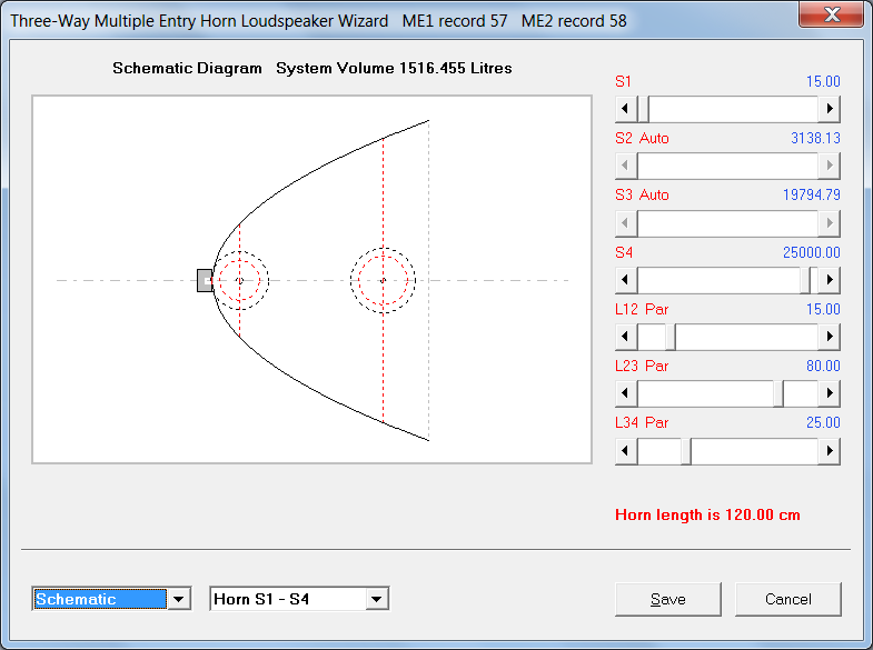

How about a unity horn with profiles other than conical?
Not a problem 🙂.
