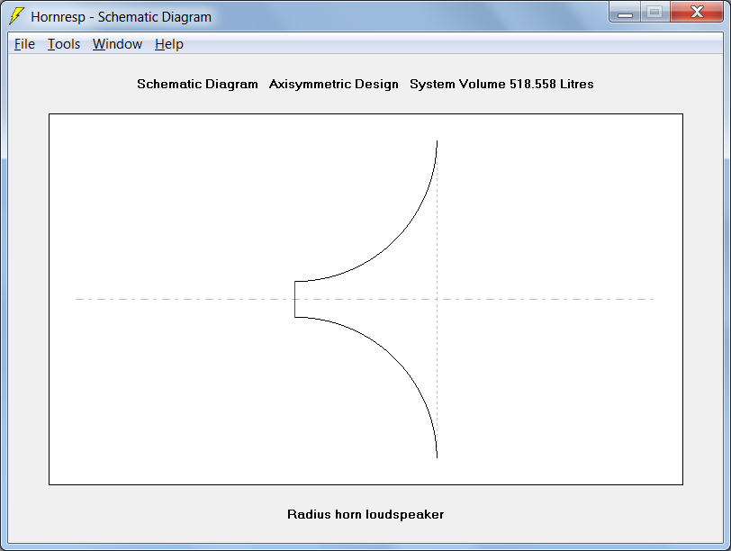

Hi David:

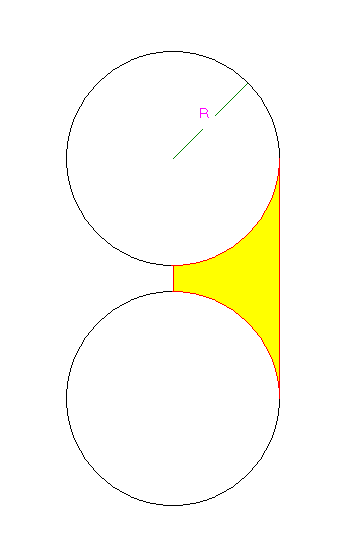

What, pray tell, is the radius flare profile? Can I use it to model a roundover on the through hole for a rear-mounted driver? I'm trying to do this but getting various error messages that make me realize I don't understand its definition or usage model. Neither the HR help nor google are helping.
Thanks,
Jack
Thanks,
Jack

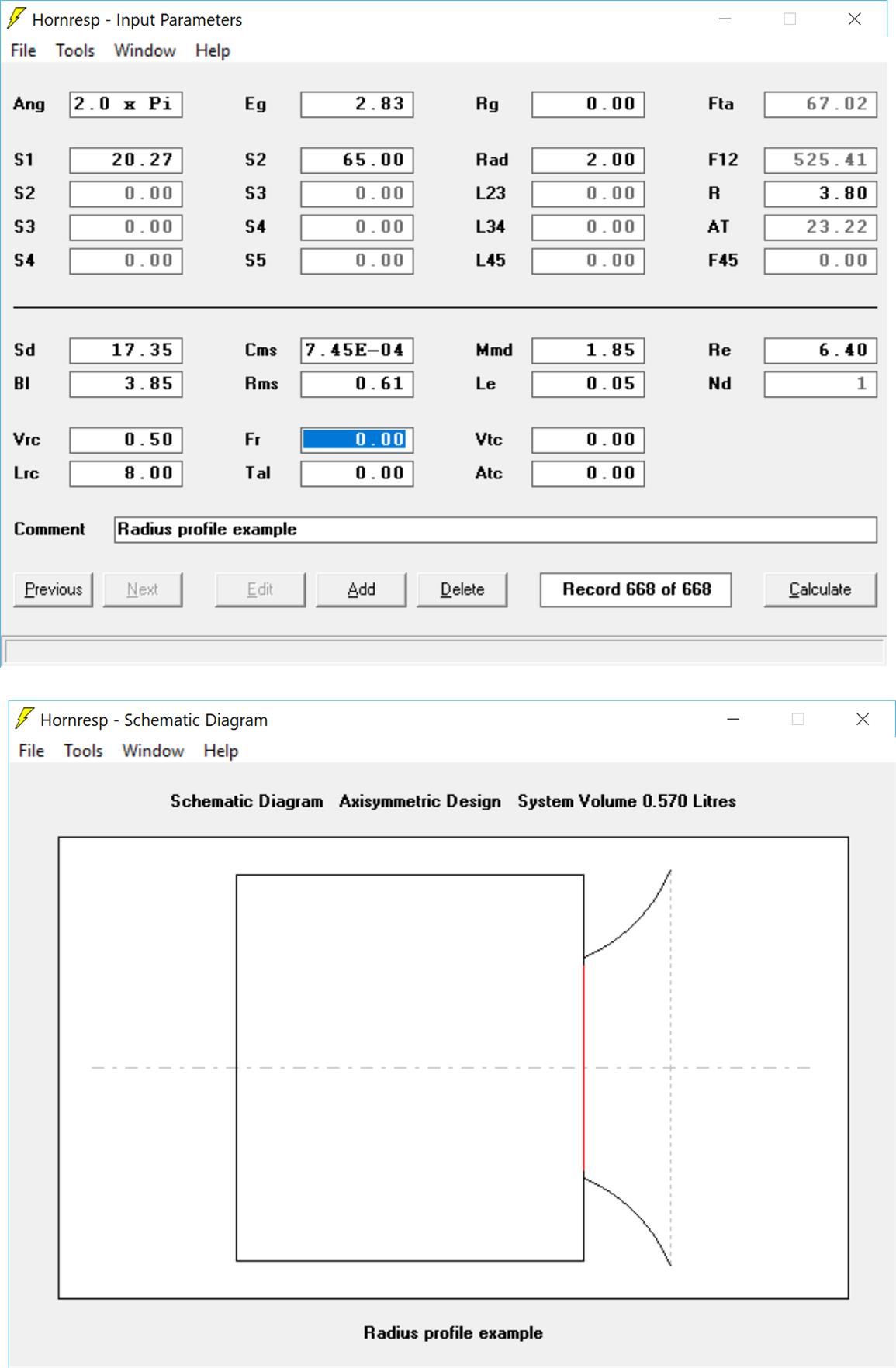

Hi Jack,
The axisymmetric radius flare horn profile is generated as shown in Attachment 1. The resultant horn is shown in Attachment 2. The example provided has a centre-subtended arc angle of 90 degrees, but the arc radius can be larger than that shown and the arc angle less, if required.
The 'Rad' flare option is offered as an alternative to the tractrix and spherical wave horn profiles.
The model is not suitable for the application you have in mind, and a "Horn too short" warning message will be generated in that case.
Kind regards,
David

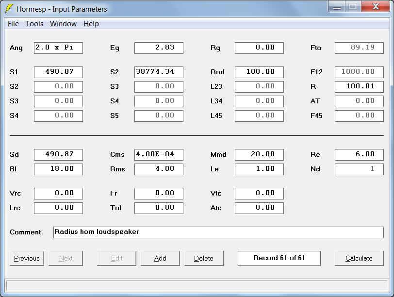

Can I see the input params screen? That looks suspiciously like what I want to model with S1 equal to the area of the panel through hole and R equal to its thickness - but when I try to create the 2nd picture in HR, I get the "horn too short" warning. Should not R equal L12?
Hi Jack,
A screenprint of the Input Parameters window is attached. The way that the model works, it is not possible for R to be exactly equal to L12 - it must always be larger, although the difference can be as small as 0.1 mm, as shown in the test example.
As previously advised, the model is not suitable for the application you have in mind. If you attempt to use the radius flare profile with a relatively small L12 compared to the throat diameter, a "Horn too short" error message will be generated. This is because the model becomes invalid and the results inaccurate, under such "extreme" conditions.
Kind regards,
David

Thanks.
I tried making L12 epsilon larger and scaling the whole thing up a factor of 10 but I didn't try changing the ratio of L12 to R ...
I guess when the horn is that short its not a horn, except perhaps at HF which is where I see an effect in the lab. I wonder if Axidriver has the same accuracy issue, will try.
This driver (Fountek FR58EX) really wants to be rear mounted from a mechanical point of view but the response seems worse that way.

Hi Jack,
As far as Hornresp is concerned, it is too short to be simulated as a horn. Even at high frequencies, because the throat area is relatively large compared to the mouth size, the horn loading effect will be minimal. The effect you are seeing in the lab is probably due to baffle edge diffraction.
Because AxiDriver uses the Boundary Element Method (BEM) in its simulations, it does not have the same accuracy issues as Hornresp.

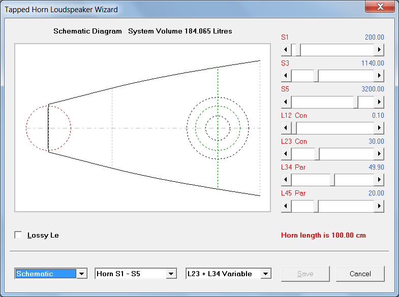

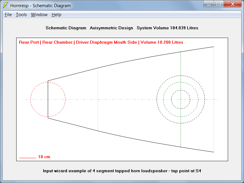

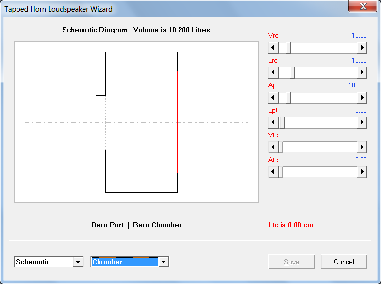

Hi Sugar Lion,
Just to clarify, the Hornresp Help file says to set Vrc, Lrc, Ap and Lpt to values greater than zero (> 0), not equal to zero (= 0). Vrc and Lrc specify the enclosure, and Ap and Lpt specify the port tube from the enclosure into the horn near the mouth.
Also, by setting L12 = 0.01 cm (or to 0.10 cm in the Loudspeaker Wizard) the driver is located at the throat, not "right in the mouth".
The attachments show the system arrangement I think you are looking for (not to scale).

Well holly jumping Sugar Lions! Thank you so much for these rather encouraging and clarifying images. This post has put wind in my sails!
I will run through different setups in Hornsrep today but I was wondering if you could let me know what you think about venting into the horn closer to the throat or even in the front chamber. Is this generally just best avoided?
