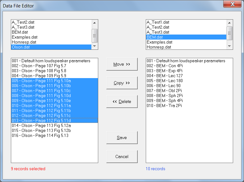

Have you tried using the multiple data files functionality yet? It could come in handy in managing the large number of records that you have. Select File > New to create a new data file or File > Open to load an existing file. Select File > Editor to move or copy records in bulk from one data file to another, or to delete records in bulk.

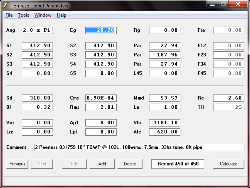

Hi BP1Fanatic,
A question for you - what is your Operating System, and your display screen resolution and text size settings?
I would like to understand why your Hornresp input parameters window is as shown in the first attached screenprint - in particular why the input boxes and text are so large, and why the word "Previous" in the leftmost command button is wrapped over two lines.
The second attachment shows the input parameters window as it normally appears, using Windows 7, a screen resolution of 1600 x 900 pixels and a text size setting of 125%.

Windows Vista, extra large font (i think 150%), LG 1080p 24" monitor connect to my biostar desktop via hdmi to dvi GeForce 7300 graphics card at 1920x1080 resolution. I'm texting from my cell since I'm not home.
Hi BP1Fanatic,
Thanks for this information. I am at a loss to explain why Hornresp appears as it does on your display monitor. In my case with a text size of 150% the input screen is as shown in the attachment.

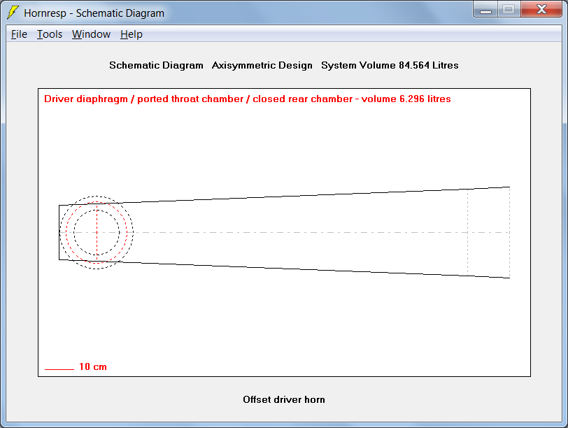

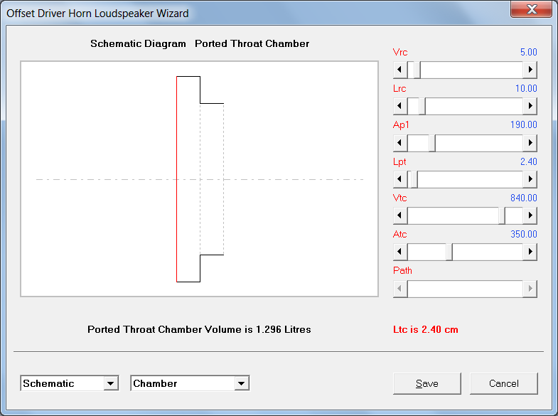

Hi David,
New Year, new requests? 🙂
When simulating OD horns I'm using Ap1/Lpt to control the entry into the horn at the S2 location, and this seems to work. I think I'm simulating an entry into the horn with a throat chamber coupling duct that has a cross-section smaller than S2.
I would like to additionally have the ability to simultaneously provide a vent for the rear chamber, similar to the way you solved this for CH, by using S4/S5/L45 for the rear chamber port/horn.
Would that be possible without major modifications?

Hi Oliver,
Your thinking is correct. The arrangement can be confirmed by checking the default schematic diagram (Attachment 1), or the Loudspeaker Wizard chamber schematic (Attachment 2).
Unfortunately, no. Definitely another one for AkAbak...

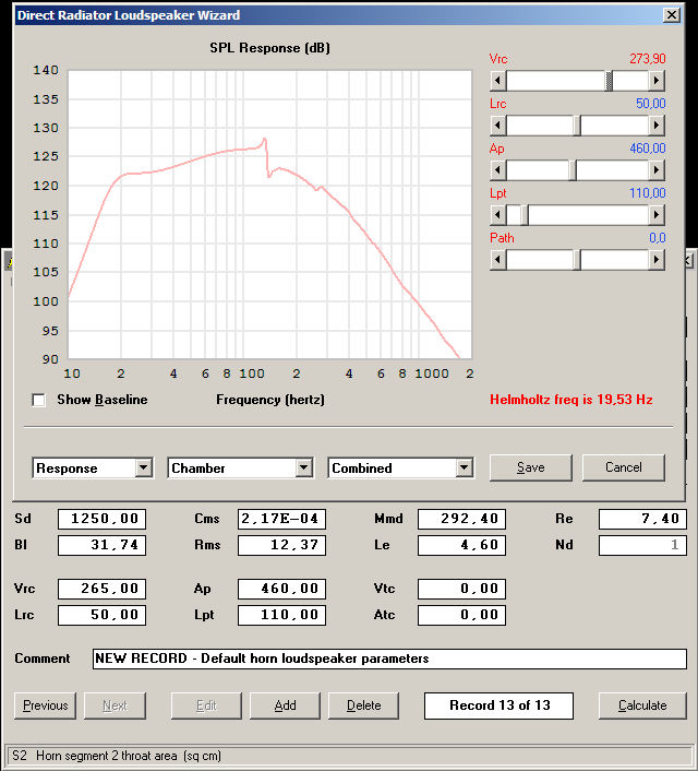

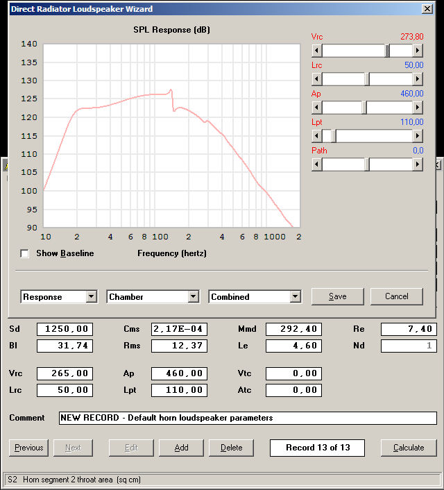

David,
I noticed some kind of 'sudden jump' when sliding Vrc and the appearance of 'Helmholtz freq' in the lower right corner. (red color)
The graph suddenly changes a lot too.
Sliding further in the Vrc normally doesn't change the graph a lot, except at this certain point.
Attached are the two screen shots with a Vrc difference of only 0.1
