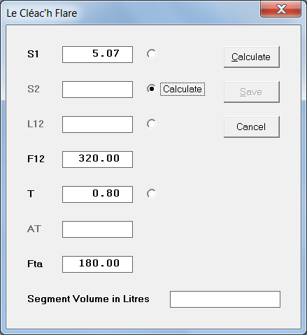

Hi more10,
I changed my computer’s regional setting to the Swedish number format, entered the Le Cléac'h horn parameter values shown in your screenprint and then selected the System Design With Driver tools menu command. Everything worked fine for me - I do not get the error message you are seeing.
Because of the way that the Le Cléac'h horn profile is generated, it is not possible to directly specify the L12 value as an input parameter. You may find it easier to use the Horn Segment Wizard to specify a Le Cléac'h design - see attached example screenprint.
Kind regards,
David
When hitting
As you can see, the L12 field is not editable:
Kind regards,
David

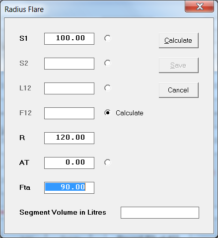

Can't get Rad to work.
Hi David_Web,
From your description of the problem I suspect that you might be increasing the value of Rad (the horn axial length) rather than the value of R (the flare profile radius). If this is not the case could you please let me know.
Kind regards,
David

I was trying to change from Lec to Rad, but coultn't. Thats why I tried "system design/with driver".
You should add a function preventing Hornresp from running at night
Didn't even see the R parameter
Hi more10,
To change from Lec to Rad, double-click on the Lec label in edit mode and then press R.
Kind regards,
David

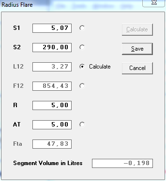

Can F45 label be used to show mouth angle?
Hi David_Web,
The radius horn mouth flare tangent angle is given by the Fta parameter.
The Horn Segment Wizard enables Fta to be specified as an input value if so desired.
Kind regards,
David
The design tool for Rad has a bug in it allowing it to calculate invalid horn with negative volume.
Hi David_Web,
Many thanks for bringing this to my attention - it will be fixed in the next release.
Kind regards,
David

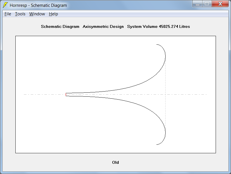

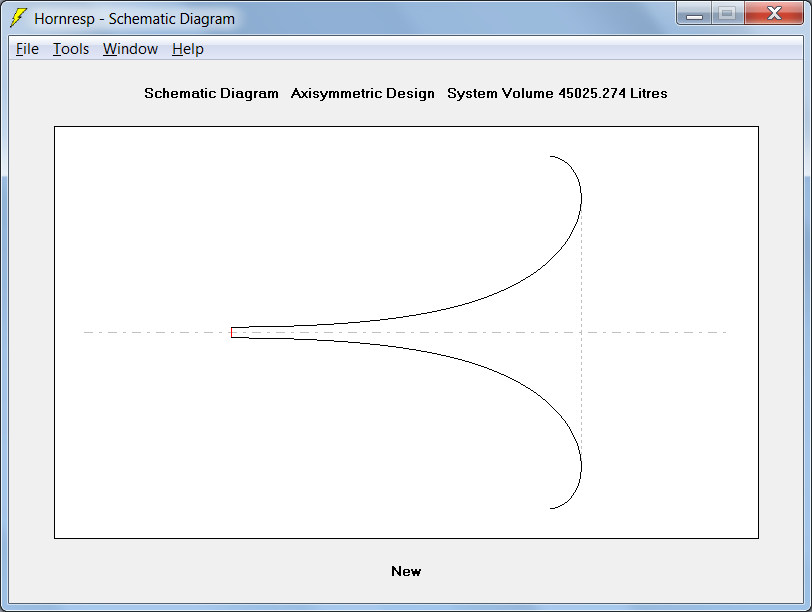

Hornresp Update 3100-130123
Hi Everyone,
1. Schematic diagram horn profiles are now perfectly symmetrical for all screen resolutions and text size settings. Previously, one-pixel-width "quantisation error" discrepancies could sometimes be seen. The change is purely cosmetic, and the calculated results are not affected in any way.
The attached screenprints show an example of the "old" and "new" profiles. Note the subtle differences - particularly near the throat.
2. The radius horn segment wizard bug reported by David_Web has been fixed.
Kind regards,
David
Hi Everyone,

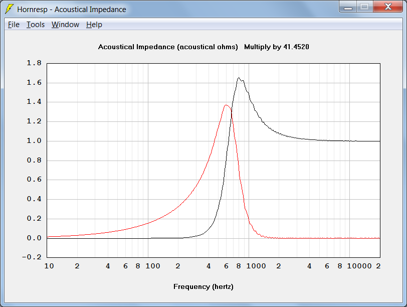

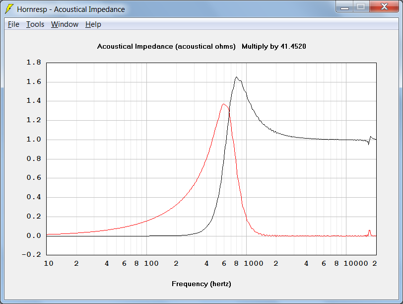

Hornresp Update 3100-130124
Hi Everyone,
A small spurious spike present at high frequencies in the throat acoustical impedance chart results for some radius horns, has now been eliminated.
See old / new comparison screenprints attached.
Kind regards,
David
Hi Everyone,
Kind regards,
David
David and others,
could you talk us through what the "shape" of those plots is telling us?
There are some small ripples on the flanks, what do they mean?
There is an asymetry over the peak, what does that mean?
Why does the black have a more pronounced ripple at ~900Hz
What is the difference in the red and the black?
Why the difference in slopes before and after the peak? Red is slow before and fast above, whereas black is fast below and slow above?
Why is the red at zero at both limits whereas the black is zero at low limit and 1 at the high limit? Is it exactly 1? Why 1, what does that mean?
