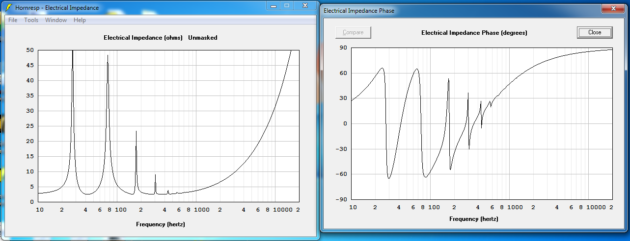

I noticed some kind of 'sudden jump' when sliding Vrc and the appearance of 'Helmholtz freq' in the lower right corner. (red color)
The graph suddenly changes a lot too.
Hi Bart,
When a Helmholtz frequency is shown in Hornresp, it means that the dimensions of the vented-box enclosure and the associated port tube are such that the air in the tube (including appropriate end corrections) can be treated as an acoustic mass, and that the system acts as a pure Helmholtz resonator.
When a Helmholtz frequency is not given it means that the port tube is relatively long, and that it acts as a cylindrical horn rather than as a simple lumped acoustic mass. Rather than being a bass-reflex speaker, the system in effect becomes a back-loaded horn with a very large throat chamber. This can be readily confirmed by actually modelling the system as a back-loaded horn - the combined response results will be identical.
It just so happens that in your particular example, increasing the enclosure volume from 273.8 to 273.9 litres changes the port tube from the cylindrical horn model to the acoustic mass model. This is the reason for the 'sudden jump' in the combined SPL response. Very few bass-reflex speakers would normally have a port tube 1.1 metres in length, so the discontinuity seen at the model change threshold is unlikely to be a material issue when using Hornresp to analyse a practical bass-reflex design.

Thank you David.
The long port is to have a port surface as big as possible while staying under a quarter wave lenght of the highest frequency the box has to provide.(±80hz)
It has been a balance between first port resonance and largest possible port.
I hope this doesn't mean my box works wrong or with artefacts because of other reasons unknown to me.
Hi Bart,
The Hornresp predictions should be reasonably accurate. It may be worthwhile calculating the results with resonances unmasked though, to avoid any nasty surprises.

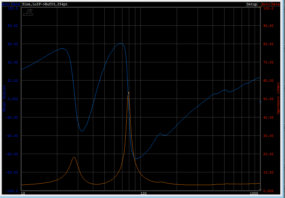

A little Show and tell overture
I do quite a bit of design work for different clients. From time to time we do take the designs to prototype and then production. I like to share the following screens. It is simulating and measurement of a very interesting variant on a mass loaded transmission line. No large labyrinth required, just a variant on the venting.
Magnitude of the impedance are not always the same. But they are in remarkably similar locations. Desired tuning frequency at the zero crossing point is spot on. Not bad for a program designed to simulate horns being used to simulate a whacky type of port!
It shows to me that the fundamental theory behind Hornresp is spot on. I describes what air is doing under the influence of a driver. Almost universal in it attribution to speaker design.
What did i do before Hornresp?
Lots of calculating!
And many more mistakes.
Hi Mark,
Thanks for sharing. It is always nice when the measured results line up reasonably well with the predictions 🙂.

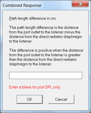

I also want to thank you David for this wonderful tool. I use it whenever I can for my projects. Simulations are very accurate!

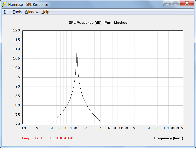

My friend Asto found out that you can use Hornresp for Helmholz calculations (and visualisation), this is how to do it:
I would like to add Helmholz Q calculation to the wishlist.
The Helmholtz trick is brilliant!

My friend Asto found out that you can use Hornresp for Helmholz calculations (and visualisation), this is how to do it:]
Hi more10,
Thanks for detailing this process.
The port output can of course be shown on the main SPL response chart if so desired - it is not essential to use the Loudspeaker Wizard tool.
I have no plans to provide specific quality factor information in Hornresp. A good indication of the port Q can be gained from your chart, however.
Kind regards,
David

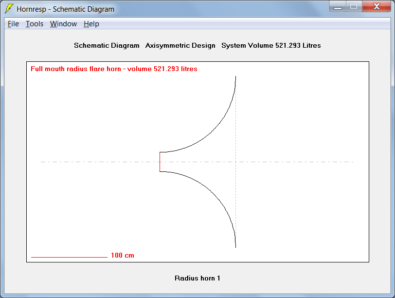

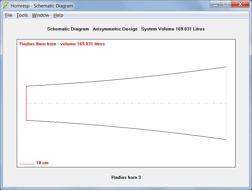

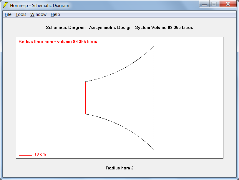

Hornresp Update 3100-130120
Hi Everyone,
Hornresp can now model radius horns. See http://www.diyaudio.com/forums/subwoofers/226410-horn-flare.html for background information. To select Rad flare in edit mode, press R when the L12 length parameter has the focus. Three sample profiles are attached.
Could you please let me know if you find any bugs.
Kind regards,
David
