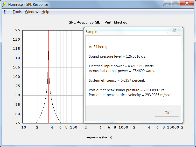

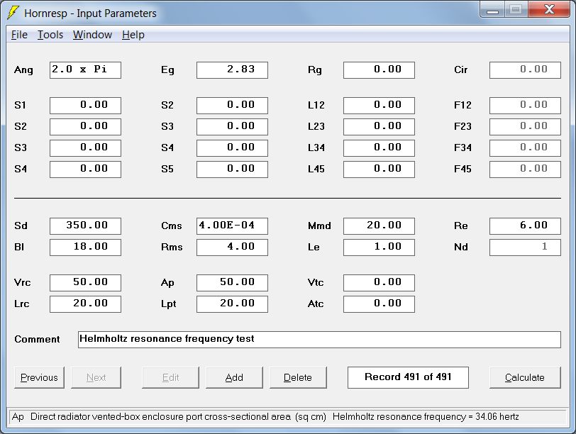

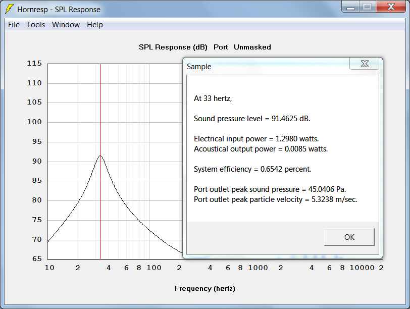

It is possible to make the two results effectively the same by:
1. Selecting the Hornresp 'resonances masked' option, which means that the vented enclosure is then treated as a simple compliance, the same as in the formula.
2. Setting Eg = 0 so that the driver parameter values are not considered, the same as in the formula.
In the attached example:
1. Inputs.png shows the calculated Helmholtz resonance frequency to be 34.06 hertz.
2. Freq1.png with resonances unmasked and Eg = 2.83 volts shows the position of the resonance at 33 hertz.
3. Freq2.png with resonances masked and Eg = 0 volts shows the position of the resonance at 34 hertz, which is now very close to the value given by the formula. There will always be a very small difference because the formula is still treating the port tube as a pure acoustical mass whereas the SPL response model is not. Also, as indicated earlier, the longer that the port tube becomes, the greater will be the difference.
Kind regards,
David

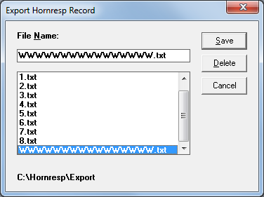

Hornresp Update 3110-130202
Hi Everyone,
The maximum allowable length for Hornresp file names has now been increased from 8 to 16 characters. The file Open / Save form has also been widened to ensure that even under "worst-case" conditions, file names having 16 characters will be fully visible for all standard screen resolutions and text sizes - see attachment.
Kind regards,
David
