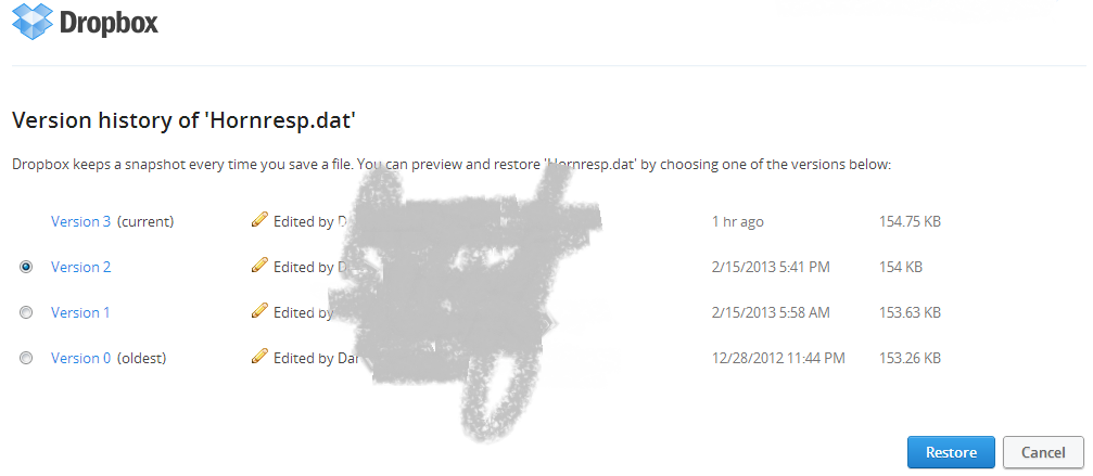

Now this is true for the last few updates yes?
Hi Mark,
From Version 19.10 onwards, Hornresp should automatically detect when the format of a data file is more recent than that of the program being used.
To illustrate:
1. A data file originally produced using Hornresp Version 31.10 will generate the following error message if opened using Hornresp Version 19.10.
"Must use Hornresp Version 29.00 or later with current data file."
(Version 29.00 is the last time that the data file format was changed).
2. A data file originally produced using Hornresp Version 31.10 will be corrupted if opened using Hornresp Version 19.00.
To avoid any possibility of data file corruption, I strongly recommend that old versions of Hornresp be deleted.
Kind regards,
David
Hi David,
Are you arbitrarily version locking the .dat file or is going to be good across all versions that share the same data structure? I see now this is already addressed.
You might want to consider an import of the database if you are changing the structure leaving the old version intact. Thus to never irrecoverably hose the DB ever.
If you let me know when you made/make changes to the structure I can group the old versions in folders as a preventative measure. All versions prior to 29.00 have been placed in a separate folder. 🙂

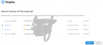

I also run Hornresp from Dropbox, it has 30 days minimum history of every saved change made to a file. All you have to do is log in to the web interface to revert or download a previous version. Butt covered in triplicate really. You might consider putting the Hornresp development project on Dropbox, it could come in handy or even save your butt.😉
I started saving Hornresp when I found out you were not, sometimes you need to go back. How do you find out where/when an error was introduced without a prior version?
Hi Dan,
I see that the oldest version of Hornresp you have is 2840-110427. Because this is later than version 19.10 there should be no data file corruption problems.
All I require for the debugging process is a detailed description of the problem - it does not matter where/when the error was introduced.
I still don't understand why anyone should find it necessary to keep superseded versions of Hornresp... 🙂.
Kind regards,
David
Kind regards,
David
