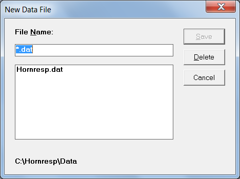

Hornresp Update 3110-130303
Hi Everyone,
A minor anomaly in the operation of the "file delete" functionality has been fixed.
The Delete button should not be enabled when Hornresp.dat is the only data file available.
Attachment 1 shows the old functionality. Attachment 2 shows the new functionality.
Kind regards,
David

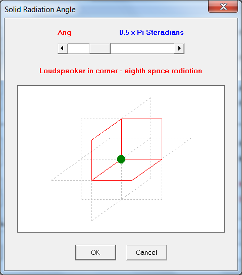

Hornresp Update 3120-130310
Hi Everyone,
A new 'Radiation Angle' tool has been added to Hornresp. It provides a graphical view of the placement of the loudspeaker and the solid angle into which the loudspeaker radiates, as given by the Ang input parameter value.
The new Tools menu command is enabled when the Ang parameter has the focus. The tool can also be selected by double-clicking the parameter in edit mode.
It is still also possible in edit mode to directly enter a value into the Ang input field, and to toggle values by double-clicking on the Ang label.
See the attached example screenprint.
Kind regards,
David
