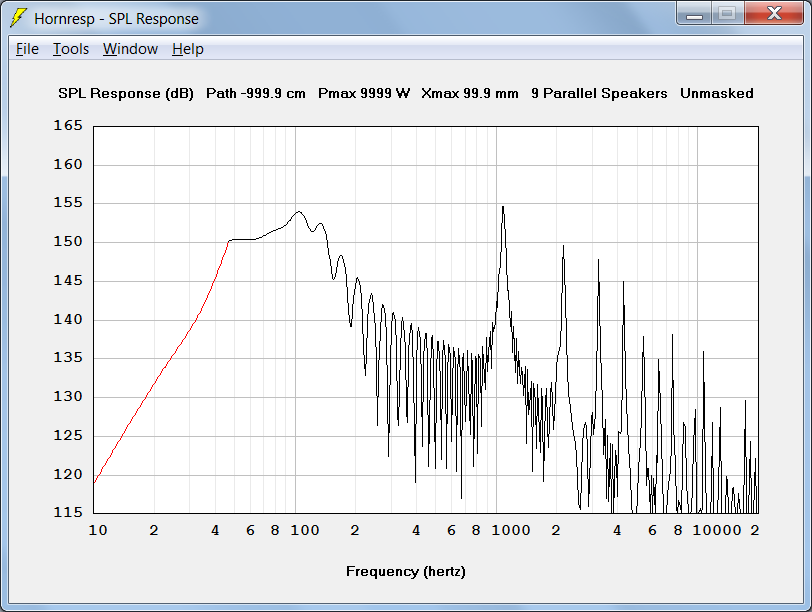

For space reasons the combined response chart no longer has the word "Combined" in the title – either "Masked" or "Unmasked" is shown instead.
The attached worst-case examples show more clearly why it was necessary to omit "Combined" from the combined response chart title.

Thanks Mark. As you can imagine, finding a driver with a Pmax of 9999 W and Xmax of 99.9 mm took quite some doing 🙂.

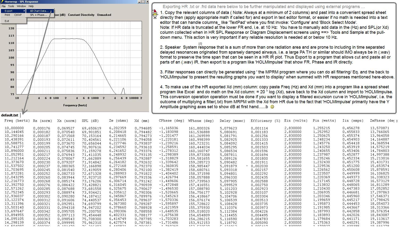

hi martin
i opted a simular question a few pages back.
Thats easy to do: You only need to convert the HR textfile to a format that any of these program can recognize:
FRD Consortium
PS: I usually first import the .wav files from HR to HOLMimpulse where I edit the IR/FR and then export to e.g. MPRM program where you can do all filtering/ Eq. and the back to Holmimpulse to present the resulting graphs you want to display.

Hi epa,
FRD Consortium
b
WAY COOL!
I had no idea this was possible.
I couldn't get it to work in my favorite FRD tool (assymmetrical response pattern estimator) but I *was* able to get it to work in Bagby's xover simulator.
Here's how I did it (very easy)
1) to get the FRD file, open your hornresp design's frequency response plot. Then export the plot as a text file.
2) to get the ZMA file, do the same thing as step 1, but do it using the impedance plot, instead of the frequency response plot.
The last step is that you have to comment out the first line of the file. Do that by typing "*" at the beginning of the line.
That's it!

There's no one program that I am aware of that does it all "in the box".
For classic enclosure topologies (sealed, ported, bandpass), Brian Steele's "Ported" spreadsheet from diysubwoofers.org has a comprehensive set of built-in filters. I use it for experimenting with non-standard alignments such as QB5 and for enclosures for car use.
Kristian Ougaard's Unibox spreadsheet allows importing an active filter response in .frd file format.
AkAbak allows defining active (and passive) filters. You can define active filters to place inline with the driving signal, and passive filters (inductors, cpacitors, resistors) to place inline with the drivers. The active filters can either be "black box" (defined response) or built from components (op-amps, R, L , C).
I usually use Ported or Hornresp to get a design "in the ballpark", then export it to AkAbak for refinement if it shows promise.
