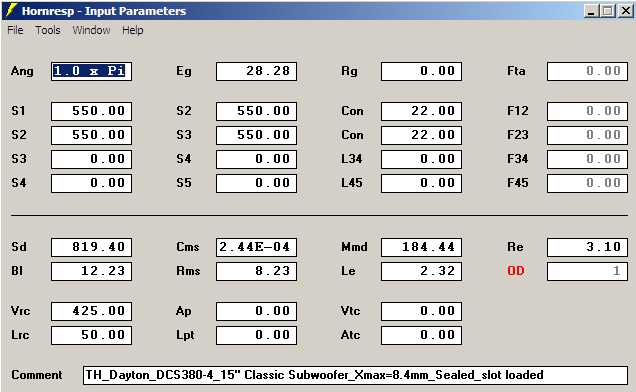

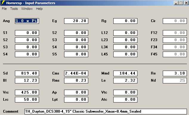

I took a simple dual driver sealed box (modeled in Nd), and slot-loaded the front of the driver using OD. While most graphs look as expected, the displacement at the low end looks too large, e.g.: @ 15Hz it almost tripples. I don't have any way to physically verify this; but, does that seem correct to you? Additionally, the impulse response shows a stronger than expected ringing; and, why do both curves not start at the same time, I would not have thought that there should be a 5msec difference here?
I'm wondering about the correctness of the simulations.

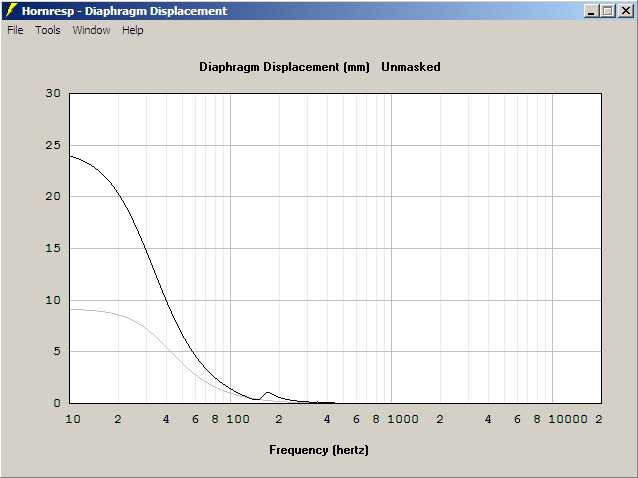

Try using the same number of drivers for both simulations. I see that your closed box sim has two drivers in series, while the slot-loaded version has only one.
-Bjørn
Hi Bjorn,
Thank you so much. Sometimes I can look at something like this, and just cannot see the obvious. This fixes the displacement (I knew that could not be right), but the SPL and the impulse response still look bad, and I still don't understand why there should be a substantial difference in the first arrival time?
Hi Oliver,

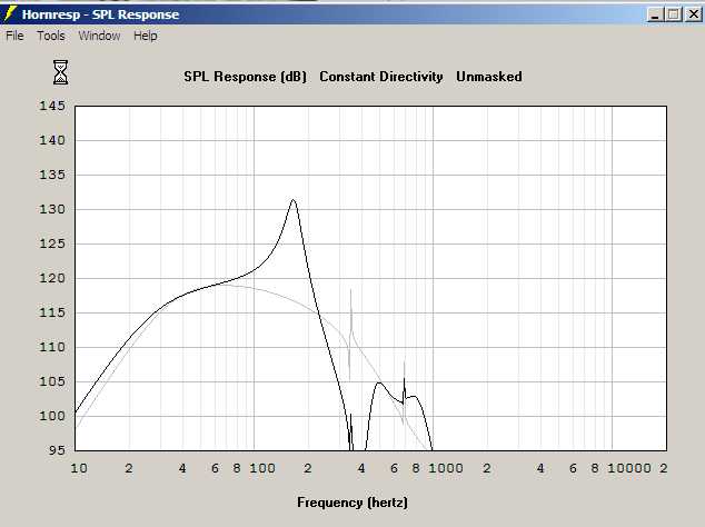

As far as I can determine, the Hornresp simulation results should be valid 🙂.
As Bjørn has pointed out, changing to 2S drivers in the offset driver horn example will resolve the displacement issue.

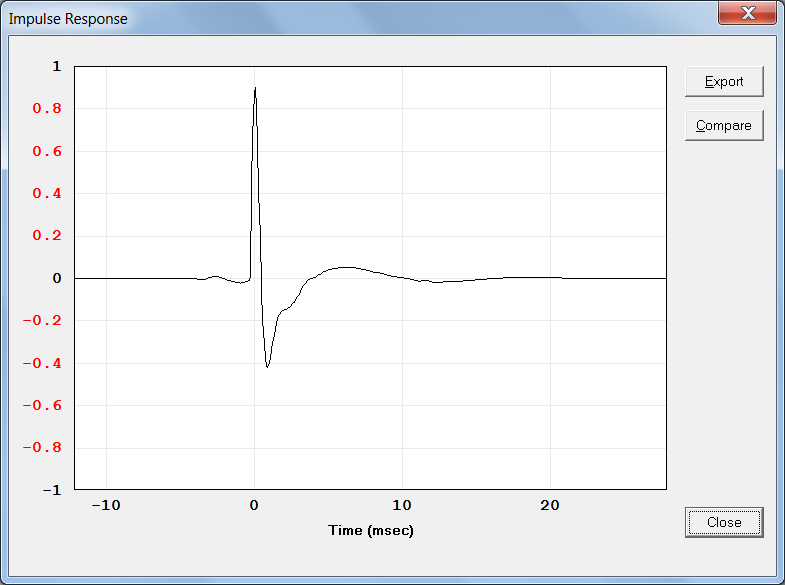

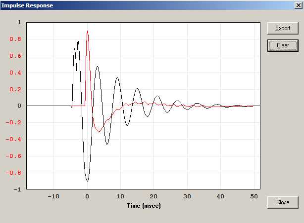

The SPL response (resonances unmasked) and the impulse response ringing are what I would expect to see for the offset driver horn configuration you have specified. Sanity check - when the impulse response is exported to ARTA and transformed back to the frequency domain, the resulting SPL response is very close to the original (see attached screenprints).
As documented in the Impulse Response tool description in the Hornresp Help file, the maximum positive or negative amplitude value is normalised to 0.9 and the maximum peak is positioned by default at the 0 msec reference point. This was the presentation recommended to me by Jean-Michel (Jmmlc), the author of the impulse response calculation method used in Hornresp.
In the case of your offset driver horn example, the maximum peak is negative which is why it, rather than the first positive spike, is shown at the 0 msec point.

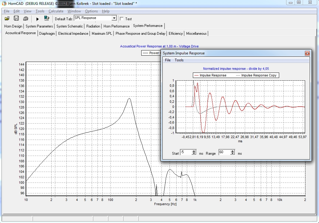

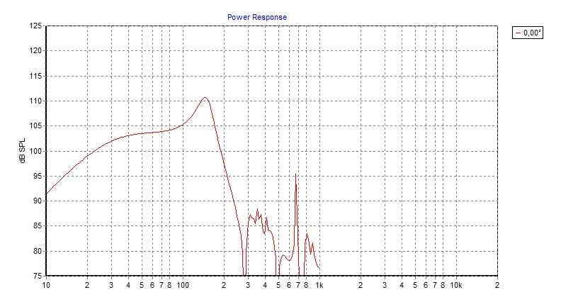

To confirm the simulations, I ran the same setup in my own horn simulation SW, and got the same results (but then I use the same model... 🙂 ). A use a different IR calculation algorithm, and I do not change the position of the impulse based on the location of the peak. Still the results are very similar.
The dip at around 390Hz comes from the fact that the L12 is a quarter wavelength at that frequency, so the reflection from the blocked end is 180 degree out of phase with the driver. The front acoustical load impedance is as good as zero at this frequency.
The peak at ~160hz is at the quarter wave resonance frequency of the full length of the horn plus end correction, which is about 10cm. There is a large peak in the acoustical impedance at this frequency, raising the efficiency by around 10dB compared to the 30-100Hz range.
The model assumes the driver to be attached at a *point*, in practice it will be "distributed". That will most likely change the magnitude of the peaks and dips, especially since the slot is relatively shallow, and the driver occupies a large part of it.
A 2D BEM simulation (free field, 3m distance) gives a very similar result, but with a somewhat less pronounced peak. So the Hornresp simulation appears to be quite good 🙂
-Bjørn

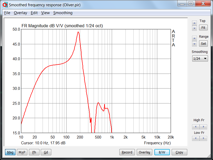

hi david
is there any sofware that you (or anybody else)now of ,that can import hr data ,to model a filter/eq .
this would be helpfull to determen a hpf.
tnx erik
tnx erik

Hi epa,
Thats easy to do: You only need to convert the HR textfile to a format that any of these program can recognize:
FRD Consortium
PS: I usually first import the .wav files from HR to HOLMimpulse where I edit the IR/FR and then export to e.g. MPRM program where you can do all filtering/ Eq. and the back to Holmimpulse to present the resulting graphs you want to display.
b🙂

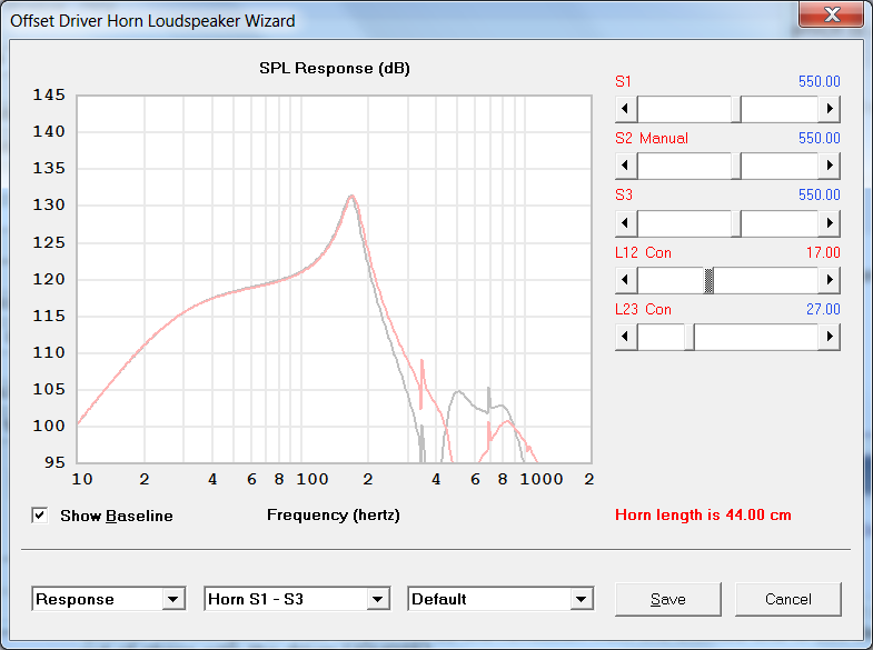

The effect of varying the driver offset position while maintaining a constant overall horn length can be seen by moving the L12 slider in the Loudspeaker Wizard tool. Attachment 1 refers.

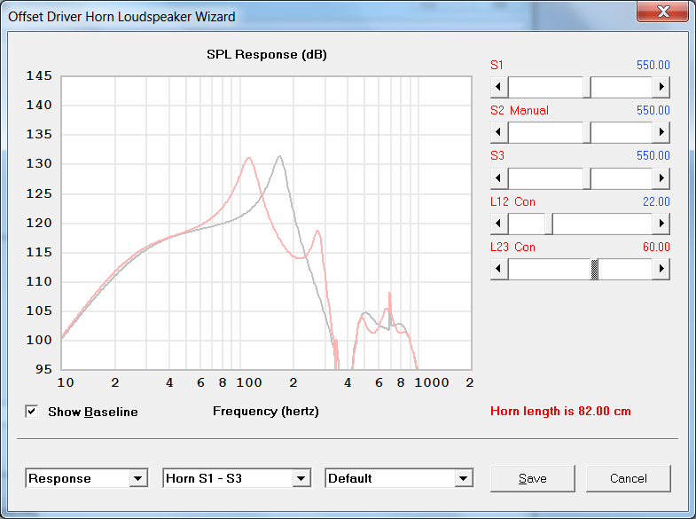

The effect of varying the overall horn length while maintaining a constant driver offset position can be seen by moving the L23 slider in the Loudspeaker Wizard tool. Attachment 2 refers.
If Nd is set to 1 in the sealed box example, and in the offset driver example S1 to S3 are set to 819.40 (Sd) and L12 and L23 are set to 0.01, then the results for the two cases become effectively identical, as expected.

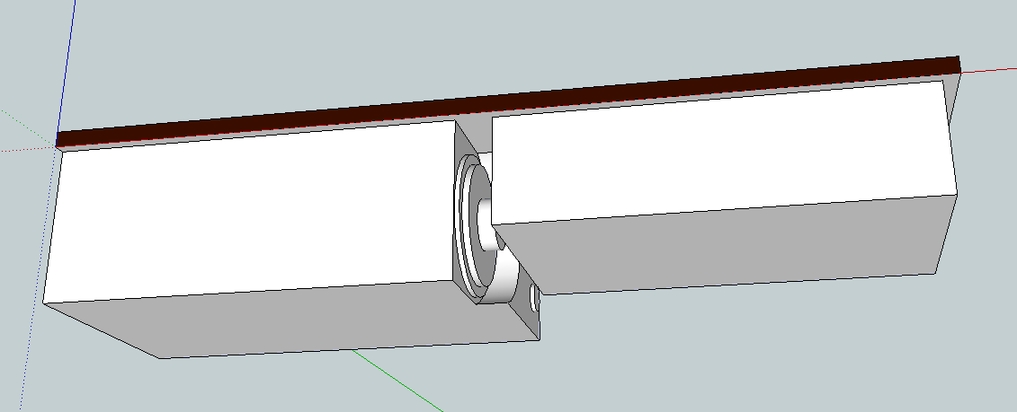

Please, could someone model this for me? I am too stupid to learn Hornresp, I downloaded it and tried to, really!
tb46 already tried to simulate my plans of a ppsl sub which has it's own thread here http://www.diyaudio.com/forums/subwoofers/223960-bench-style-cabinet-subwoofer-2x15-closed.html and final plans from message #25 on. SEe attached sketches below.
I'll use two Dayton Classic 15" drivers in series, connected push-pull in separate identical 258 liter closed boxes.
The slot plenum is 100mm wide and 420mm high, max depth is 420mm but the rear side of it is rouded with a hemispherical filling. Plenum opening area is 420 cm2 and it is on floor level in a 10,5 m2 room (2,6x3,65x2,55m). The edge of top board makes a 25mm lip on top of the plenum, the board is 40mm thick.
