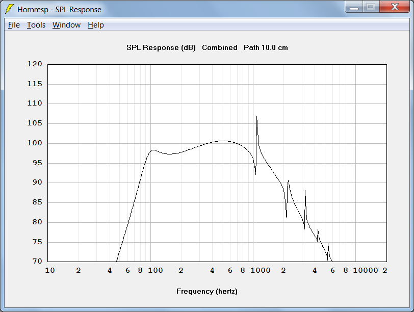

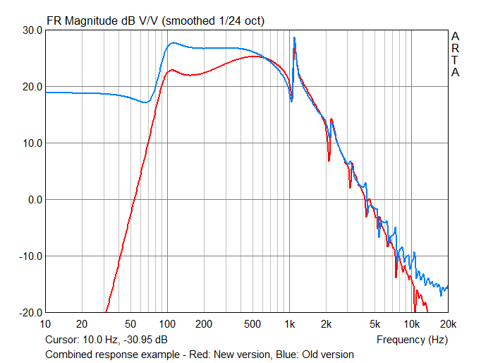

Hi Everyone,
The accuracy of the Hornresp combined response impulse response waveform has been significantly improved. When an exported *.wav file is transformed back to the frequency domain, the resulting SPL response is now a lot closer to the original. The extent of the change is shown in the attached example.
My thanks to Bjørn (Kolbrek) for his help in the development of this enhancement.
The bug reported by Oliver in Post #2946 has now also been fixed.
Kind regards,
David
