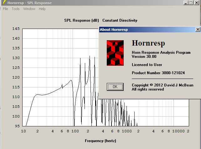

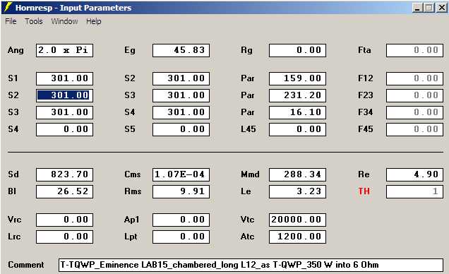

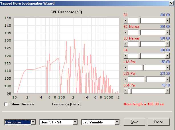

I just ran into a small problem with the response display in the Wizard v. the SPL screen:
Hi Mark,
I'm talking about the big spikes around 50-65Hz in the Wizard v. the small blips around 60Hz in the SPL screen. In this particular case it doesn't matter much, but, I thought David would like to see this.
I think both displays should be the same (how do I change the horizontal scale?).
Hi Oliver,
Many thanks for this feedback, you have found a bug. It may take me a day or so to track down and fix 🙂.
(Note that double-clicking on the "Frequency (hertz)" label at the bottom of a wizard chart will toggle the frequency range between 10-2000Hz and 100-20000Hz).

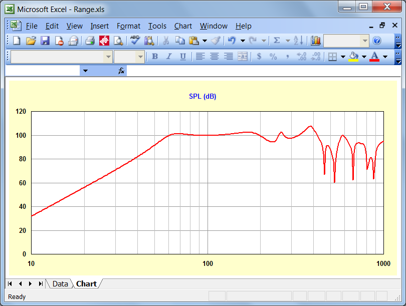

Would it be possible to make the frequency graph scalable?
Hi Mark,
The way that Hornresp is structured, it would now require a lot of work to add user-scalable frequency ranges to the charts. Sorry, but it's not going to happen 🙂.
It is of course possible to export the Hornresp chart data, dump it into an existing Excel spreadsheet set up as a template, and adjust the frequency range as required. This can be done reasonably quickly.
