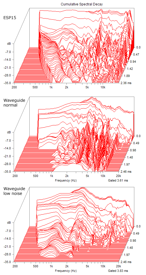

Here is comparison between ESP15, low and normal noise for waveguide. I can do Stockwell transform as well:
http://unizet.net/pub/S-Transformacja.pdf
jzagaja said:Here is comparison between ESP15, low and normal noise for waveguide. I can do Stockwell transform as well:
Thanks - the waveguide low noise is definately what I expect. I'll have to look at my algorithms and procedures in more detail if I am going to look at this low level stuff.
Also note what Jean Michael noted, that the sample rate is not the same in the two data sets.
The so called "low noise" one looks like the foam plug taken out.😎jzagaja said:Here is comparison between ESP15, low and normal noise for waveguide. I can do Stockwell transform as well:
48k and 50k does not make any difference in CSD plot.

Well that doesn't sound right since I have never used 72 kHz. Only 50k, 48k and rarely 44.1k and 32k, but I highly doubt its either of the last two. How do you know the reference points were of the same event. These two files were generated in different facilities with different equipment on different systems (different serial numbers same design) and measured at different distances.
I wasn't too impressed with that paper. A lot of pretty pictures. Incorrect claims about many things and nothing really very enlightening. Its really just a spectrogram.
His example about why two frequency response that are identical can sound different is ridiculous. He's mixing up phases of signals with phases of a frequency response. Ones a signal and the other a system. If the system frequency response is minimum phase, as it mostly is, then his "example" is meaningless.
O.K., may we see comparable "low noise" CSDs for the horn versus waveguide impulse data then, please?

I'm guessing the noise was from the foam. Since the horn does not have the foam, it's already low noise.ZilchLab said:O.K., may we see comparable "low noise" CSDs for the horn versus waveguide impulse data then, please?
I can look at the data that I have again, but if the problem is in my setup here then no. I sent the drivers and horns back already and can't get new data.
I shouldn't have to say this, but they all have foam. I don't have any waveguides without foam.
Well, aside from the so called "noise", decay is significantly different between the two which is cannot be otherwise explained unless they are using different foam material or foam shape. I am assuming same wave guide shape and size. But if they are different sizes, then the story would be different.gedlee said:
The Gedlee waveguide CSD doesn't look good.
Gedlee provided another dataset for the the waveguide, from another source, postulating that there was a measurement noise issue.
That didn't look good, either.
Processed "low noise," it's more what Gedlee expects.
O.K., let's look at the original data for both the waveguide and "horn," similarly processed, and we can pretend a whole bunch of stuff about the comparative results.
If the "horn" CSD remains constant, then it's a stretch to blame the air conditioner, probably.... 😛
