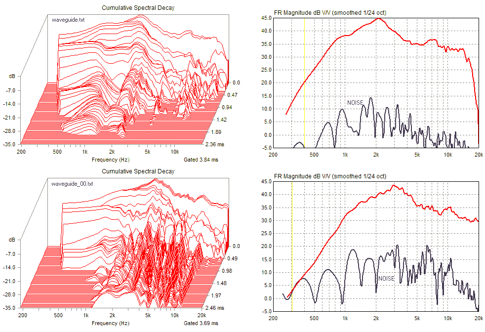

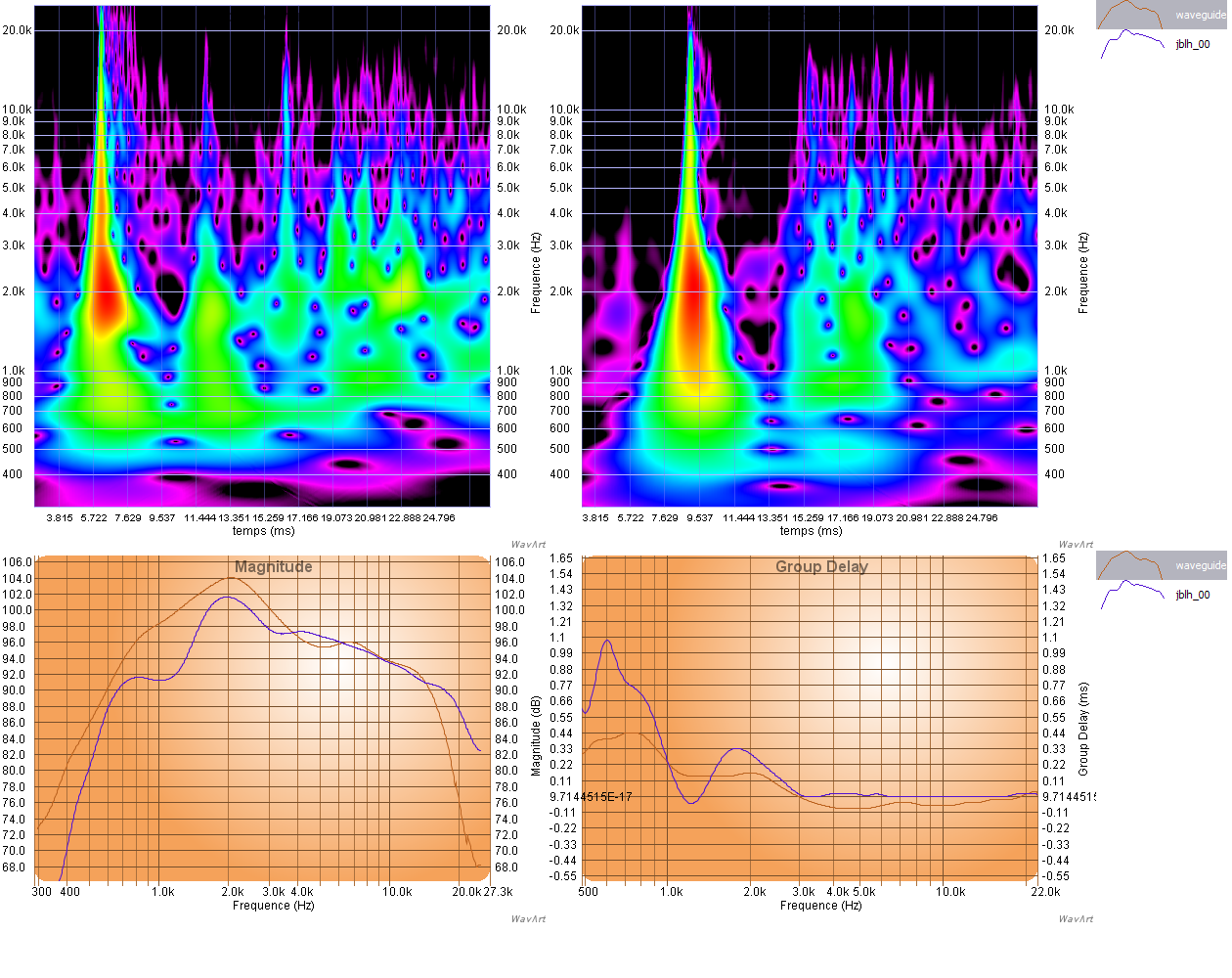

Here are some analyses on the pulse of the waveguide and jbl horn.
Waterfall are multi-resolution time, red=0dB and black<=-40dB, freq is log scal, left waterfall is jblh_00.txt, right is waveguide.txt, no smoothing.
Group delay is calculed with my own routine (max magnitude extraction from the waterfall, max spectrum is also displayed)
Results are close to Jean-Michel Le Cléac'h routine (-dPhi/dW).
I didn't find the group delay as regular as some other waveguide wich minimise diffractions (LeCleach profile, tractrix) however analyses are not necessarily correct and even though it does not mean necessarily a bad listening
Avi
Hey Avi - your spectrograms are great! Petty wild looking stuff.
Are we seeing noise in this signal? It wasn't taken out, right?
BTW, is it possible to have a spectrogram of the original pulse - the original signal, just for reference? Is the original signal in a file somewhere?
I had a look at you WavArt site. Nice! I'll have to try it out.

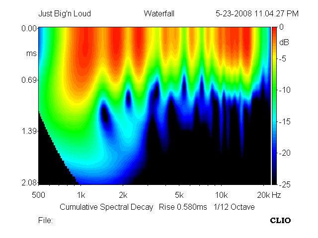

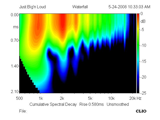

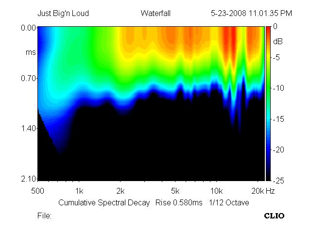

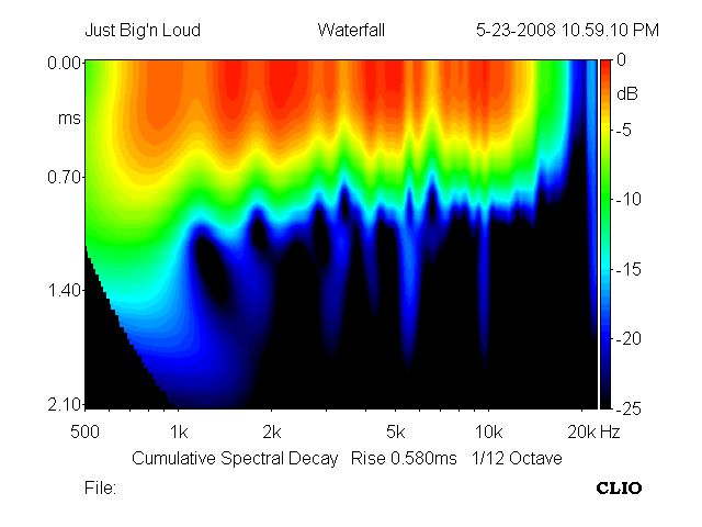

When I asked Earl to post the impulse data I was hoping I could input it into CLIO. That didn't work out. I wanted to compare his data to 3 horns and a waveguide I had data for. I am curious to see if you can tell which is which from looking at the CSD plots. They break down into an exponential, 2 difraction type horns and a waveguide. Here are the CSD's which is which??
Rob🙂
