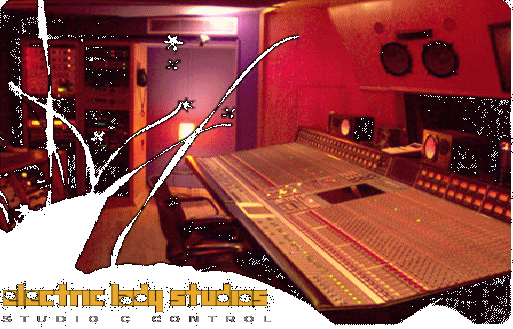

You recommended some NY consultants. Are those who did that?:
''Designed by architect and acoustician John Storyk, the studio was made specifically for Hendrix, with round windows and a machine capable of generating ambient lighting in a myriad of colors. It was designed to have a relaxing feel to encourage Jimi's creativity, but at the same time provide a professional recording atmosphere. Engineer Eddie Kramer upheld this by refusing to allow any drug use during session work. Artist Lance Jost painted the studio in a psychedelic space theme.''
I am sorry but Dr. Geddes is right again as almost always when acoustics are involved. Control rooms are not the best example of acoustics. And I confirm that for the average studio. I also maintain that the criteria are foremostly trendy for looks, acoustics and equipment. Try your best.
Regards
That’s Electric Lady Studios.
I assume you know Jimi Hendrix.
It was Storyk’s first design c. 1969/70 I would think.
The picture you attached reflects the studio’s important historical psychedelic lineage. But the gear is newer. I don’t know what’s in there now, I think it’s been recently refitted.
Interesting architectural challenge: An underground river flows beneath the studio.
To this day that studio is viable.
Storyk’s name speaks for itself. You can talk to him at any AES convention, he’s very approachable. And I don’t think he needs me as a publicity agent.
I do not know what “average” is because I have not been everywhere.
It’s clear I’ve been arguing with you, not Geddes.
Anyway, like I said, I’m open to new monitor technology, maybe I’ll get a chance to hear the Gedlee design some time.

Lets see what I originally wrote and where you came in:
At a point Dr. Geddes said that control room acoustics are not best examples of the art. He also said that it is not his field and he can't talk as an authority for control rooms.
I supported his view against views that he is posing not that serious saying that.
You criticized my view as probably just an idea of someone who had a flinting glimpse of some control room once in his life.
You recommended a very well established studio consultancy.
I returned saying that I maintain that studios are 'shops' with clients and their design is primarily dictated by trends.
I looked up your recommendation and what I see? Their seminal work is built to please psychedelic zeitgeist of the 60's looks. The Lady Day works till now in NY and does Foo Fighters etc.
I attached the main photo on their current website. What we see there? A huge desk (starship Enterprise was a bad analogy? sorry) standard NS10 nearfields perched on meter bridge on their wrong side, overhead monitors reflecting directly on the desk, flanking a glass window.
Where I was wrong? Trends? Set up? Or that photo is not representative of a typical control room?
Members here can judge for them selves. I don't see our discussion as an argument, bcs you haven't argued at all on the set up of equipment in control rooms.
