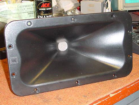

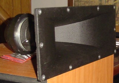

Robh3606 said:Here is number 2 It's the exponential horn. A baffled 2307/H91 horn used in many of the vintage JBL systems and in the 434X large format 4 way monitors. The measurements are without 2308 lense in place.
Rob🙂
Which, of course, is a diffraction horn in that configuration.
I fear that your conditions for these examples was misleading as I naturally assumed that they had similar conditions, like length, mouth area and treatment, EQ and particularly important, the driver. I fear that they don't even all have the same driver - is that correct? (That would totally invalidate any comparisons.)
If you want to make a true comparison of a design where people could tell real differences in the design from differences in the situation then you need to control the variables.

Robh3606 said:Hello Earl
I am calling the narrowing in the throat a diffraction device. I assumed that any narrowing or impingement into the horn that obscures the drivers throat qualifies. Is that correct??
Rob🙂
This appears to be OS in the vertical, but yes there is a very clear diffraction slot in that photo.
Actually any abrupt change in wall contour qualifies. I was just yesterday having a discussion of waveguides with a guy on ProSoundWeb. He was asking similar question about what constitutes a difraction device from a waveguide. To make a long story short(er) it is a continuum with no clear point of transition. On one extreme is the old style diffraction device with a sharp edge nearly all the way arround the device. The other extreme are the waveguides based on the Seperable coordinate systems as I describe in my book. This later case can be proven to have the minimum internal diffraction for any configuration of square, round, elliptical, etc. Nothing can do better.
Anything in between is a combination of both ends. Some combinations work better than others. I choose to stick to the extreme low diffraction end because I am after the best sound quality with little or no consideration for manufacturing, market demands, etc.
What is not clear is that I can make a device that has the minimum possible diffraction for any situation. I have not done this for the market, but I can do it. Of course all of my devices are bigger than the more diffracting devices. Generally the diffraction end is much smaller than the low diffraction end. That is almost universally what drives designs to the diffraction end of the spectrum.

Because of the diffraction lens, or without it, becasue of the sharp transition between the mouth and baffle?gedlee said:
ZilchLab said:Because of the diffraction lens, or without it, becasue of the sharp transition between the mouth and baffle?
The sharp transition at the mouth. The mouth diffraction will pretty much dominate everything - the polar response, the CSD, the axial response - just as the data shows.

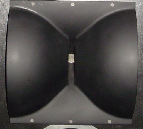

To finish out number 3 is a 2344 Biradial photo attached and 4 is a Flat Front Biradial 2370 horn

Robh3606 said:[BI am not sure I understand what you are saying here. Do you mean the set of measurements in the thread or measurements in general or simply both cases.
Thanks Rob🙂 [/B]
More the measurements in this thread. They all have different drivers and the drivers have resonances. So it very hard to tell what resonances are from the driver and what are from the horn. Resonances are resonances.
I might have to do a study sometime of the spectragram to see if the HOM can be seen in it. To do that I'd have to create some HOM and use a common driver and the same mouth size and flare. But making horns is not that easy.
