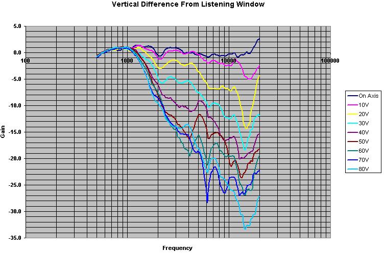

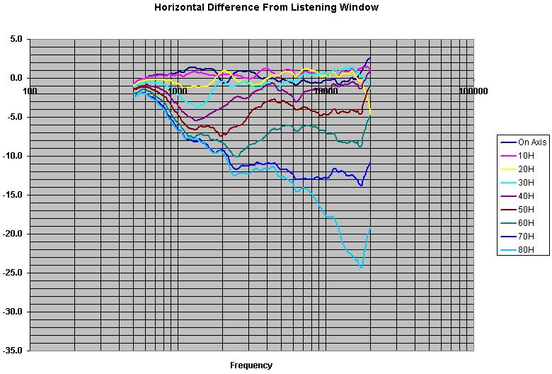

How about some relevant measurements of the 2370? Attached are the half-space anechoic responses of a DE200 on a 2370A (eqed to get listening window flat) at 10 degree increments horizontally out to 80 degrees. It's not complete crap but it's not very good.
Attached are the same except in the vertical plane. This is crap, as expected. If you're spraying sound at people directly in front of you outside it probably works well, but I wouldn't want this in a home stereo... I don't care how nice you can get things on axis.

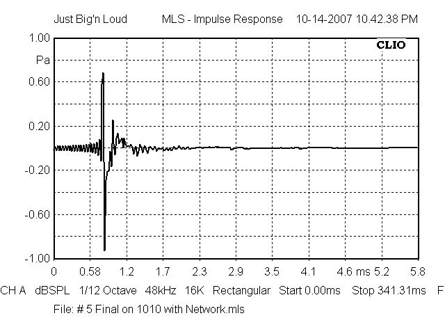

Robh3606 said:First one PTH1010
Rob🙂

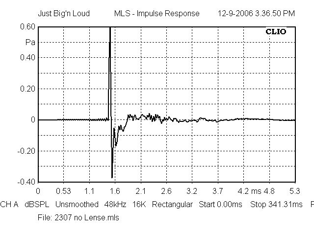

Robh3606 said:Second 2307
Rob🙂

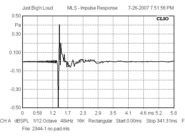

Robh3606 said:Third 2344
Rob🙂

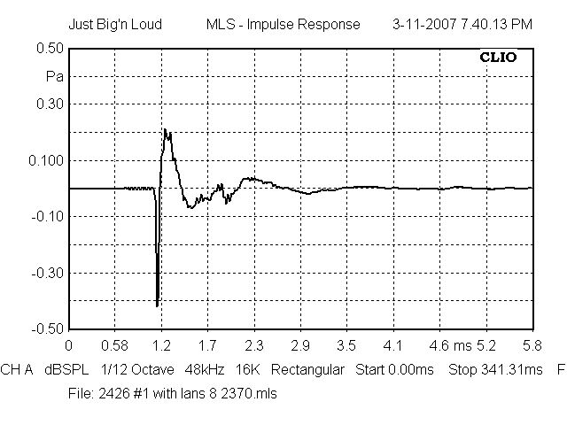

Were all these taken with exactly the same setup? Mic and mic preamp etc?Robh3606 said:Last 2370
Rob🙂

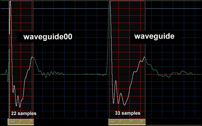

Hello,
Earl, due to "friday evening fever" and as I was in a hurry to leave my office, i inverted my "rule of 3".
The sampling frequency of signal "waveguide00" is not (3/2) 48k but (2/3) 48k so it is 32k.
We can verify using the CSD graphs.
On the CSD graph of signal "waveguide00" for t=0 the curve is abruptely cut for the maximum frequency diplayed. Now if we look for the same level on the CSD (t = 0) for the signal "waveguide" we find 16k, this means that the sampling frequency of signal "waveguide00" is 2 times this (Nyquist frequency) so Fs = 32k.
About taking 2 reference points on the 2 signals, this is done with the pulses normalized, merged and correctly trimmed (see attached screen copy).
Best regards from Paris, France
Jean-Michel Le Cléac'h

gedlee said:
Well that doesn't sound right since I have never used 72 kHz. Only 50k, 48k and rarely 44.1k and 32k, but I highly doubt its either of the last two. How do you know the reference points were of the same event. These two files were generated in different facilities with different equipment on different systems (different serial numbers same design) and measured at different distances.

Rybaudio said:Attached are the same except in the vertical plane. This is crap, as expected. If you're spraying sound at people directly in front of you outside it probably works well, but I wouldn't want this in a home stereo... I don't care how nice you can get things on axis.
Better EQ'd than not, surely.
It's promoted as not requiring EQ, but I've never been able to get it sounding better than what it is, SR gear. Others seem to be satisfied with that.
What do Altec 811B and 511A look like off axis?
