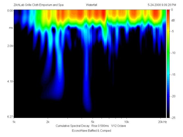

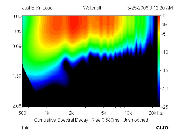

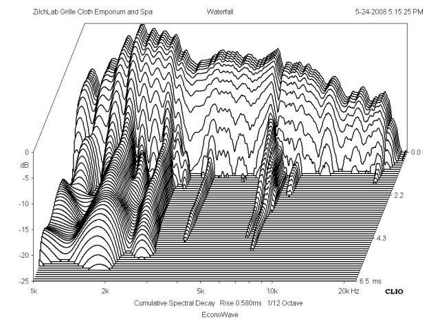

Hello
I threw a wrench into things. Two are EQ'd number 1 and number 3. It seems that some of you are using the high frequency roll off in the some of the plots as part of your determination as to which is which.
What is unique in the time domain between a Wave Guide vs. a Horn?? Are there tell tail artifacts in the CSD's that can be used to see the reflection back into the horn??
I would assume them to be shown and the longer decay rates that seem to be a intervals that are tied to "holes" that appear and then dissapear as the time interval increases.

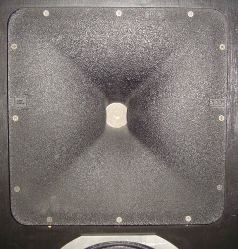

I am going to attach an non-EQ'd plot for number one and post pictures for the horns and waveguide to but a face on them so to speak.
Thanks for your input
Rob
