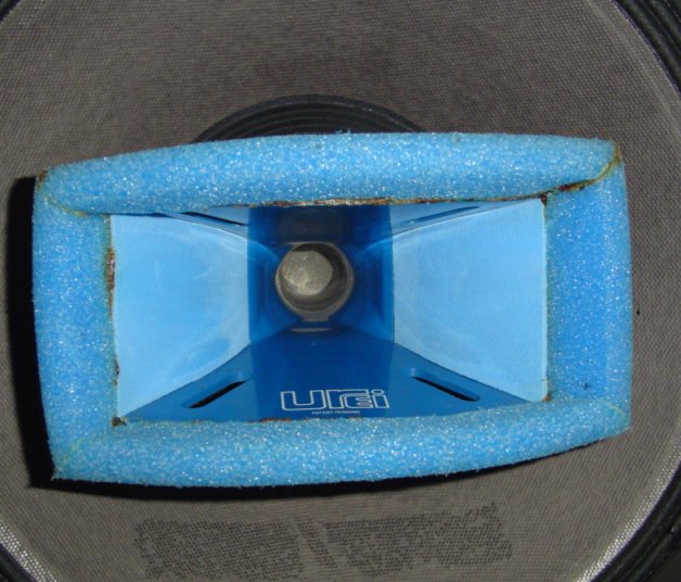

Robh3606 said:This should look familiar it's a Urei 801C horn.
Yep! I know those. =) Did Altec ever do that, or was it just the Urei?
Variac said:I suppose that instead of foam, one could flare the opening edge with a 4" diameter roll?
It would work, but maybe not in the same way. The idea is to get a smooth impedance transition at the edge. A sharp terminations causes artifacts. Probably form resonance at the mouth, but I'm not sure.
What I am sure of is that I can both hear and measure it.
http://www.diyaudio.com/forums/showthread.php?s=&threadid=103787&highlight=
Foam, roll-overs, towels, edge slots. There are many different ways to do it.
