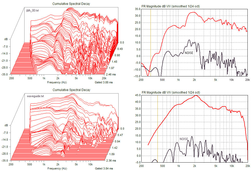

soongsc said:
Well, aside from the so called "noise", decay is significantly different between the two which is cannot be otherwise explained unless they are using different foam material or foam shape. I am assuming same wave guide shape and size. But if they are different sizes, then the story would be different.
It is different thats the point. Its the measurement setup NOT the device. They are the same device, but measured with different setups.
ZilchLab said:
I'm just trying to keep some order here vis-à-vis the topic.
The Gedlee waveguide CSD doesn't look good.
Gedlee provided another dataset for the the waveguide, from another source, postulating that there was a measurement noise issue.
That didn't look good, either.
Processed "low noise," it's more what Gedlee expects.
O.K., let's look at the original data for both the waveguide and "horn," similarly processed, and we can pretend a whole bunch of stuff about the comparative results.
If the "horn" CSD remains constant, then it's a stretch to blame the air conditioner, probably.... 😛
That's your point of view and its probably not universal. To me the CSDs look very good, especially the second one where the "noise" is gone. SO lets NOT use the bad one, lets use the good one!!
And its not a stretch to blaim the measurement setup, especially if thats what it is and I showed it.
Lets try and keep this fair, OK? Or is that too much to ask?

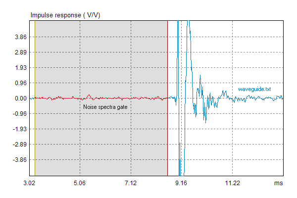

Another view upon request. Noise spectra is taken before main pulse. Don't know if this is good for you Gentleman?
That's what I'm trying to do. Presumably, the same measurement setup was used to acquire the initial data for both the waveguide and the "horn".
Imperfect, perhaps, but let's see the results, similarly "processed."
I am certainly opposed to offering up results from different locations using different methods and equipment as valid for comparison here, and that, after all, is the topic of the thread.
Then if you use the original data you have to conclude that the tails in the waveguide CSD are noise and not something coming out of the device because that was shown not to be the case. If there is no decay in the tails then it cannot be from something whose energy has ceased. If there is a decay then its possible, but its not possible if there is no decay.
And I don't see the point of throwing out data that completely agrees in the early part of the decay - the important part.
Worse case you have to throw out any CSD from the recent data because it was not taken to do a CSD on. CSD is not that meaningful to me anyways, expecially not if the data can get all twisted around in interpretation like this has.
The polar plots are unaffected by this "noise" issue and I'm perfectly willing to stand by those alone for my conclusions.
Fine, then subtract the noise via post processing from both original data sets, is what I'm saying. The same tails, or some of them, appear in the EconoWave CSD.
We have different agendas here. You want to know more about your waveguide's performance and cherry-pic the data from different sources for your purpose. I want to compare EconoWave and ESP performance under the same conditions, not ESP measured with a 10 dB lower noise floor....

soongsc said:
Is it possible to show the noise for the other wave guide data?
Exactly what I have been asking for.... :yes:
gedlee said:
Well that can't happen now so I guess that you are out of luck.
Sure it can. I'm not asking for a "Do-over," merely post-processing of the original, comparable data, with the noise metric....
